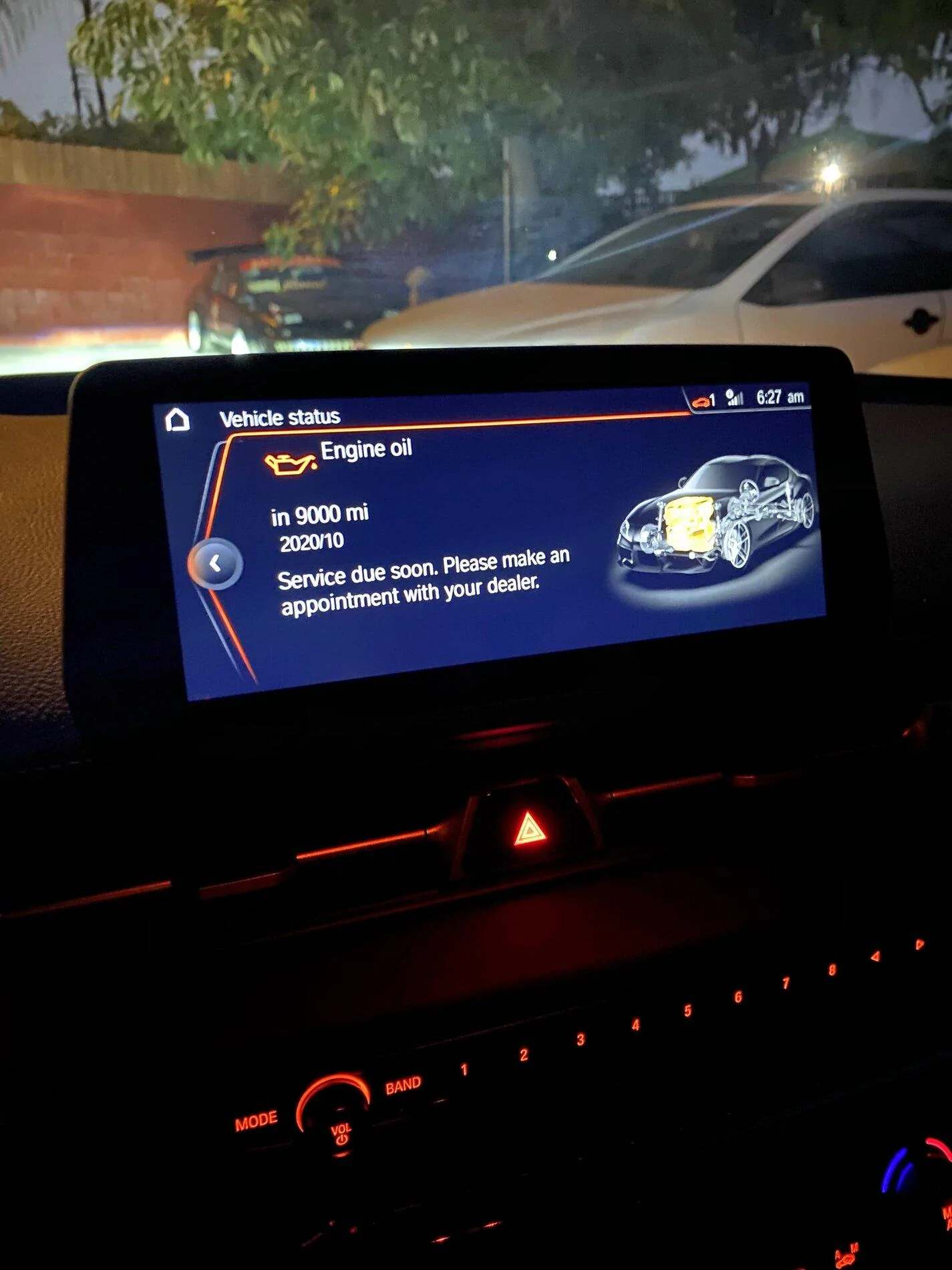

(also thinking i may have a clip of it in my dash cam but not so sure) I also recently went to toyota for an "oil change" since the car's notification told me to "maintenance required 10/2020" pretty sure they didnt even touch the oil or anything. i did run an oil level checked and it said to be right. oh and even after the appointment, the maintenance notification is still there, so they didnt clear it? so im still no sure what it could be..

If you went for oil service at dealer, they should have reset the service message for you ....
