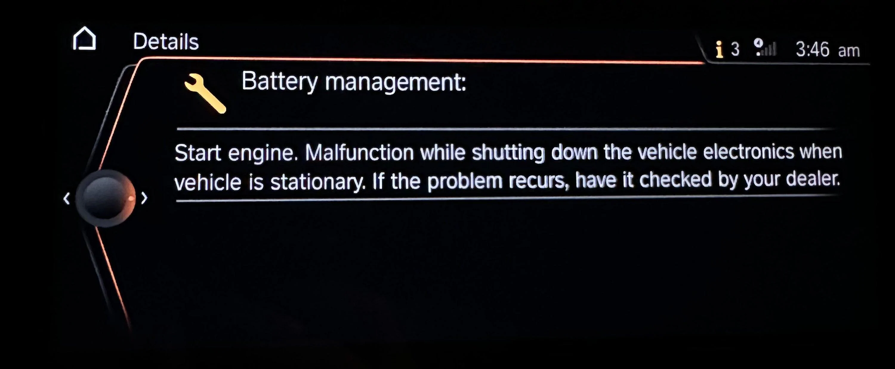

Has anyone had any experience with this and what exactly was the fix or problem
my car is daily driven minimum 20-35 miles a day

So I started getting this message on my 2021 3.0 a little after I had my front and rear dash camera professionally installed, had the dealer run diagnostics and they found nothing wrong with my battery they said just be mindful of what stays on because my specific dash camera stays on 6 min after the car is shut down. This notification hasn’t came on since tho. Hope this helps.

I had this error. Not sure why this worked but I disconnected the ground wire to the battery for 10 secs and it has stayed off since.
I daily drive my car. The dealer said the battery was good. I disconnected my LED steering wheel, dashcam (powered by the usb), and radar (mirror tapped) and was still getting this issue. I checked codes and nothing showed up. Hope this helps.

I've seen people get this error when they have a dashcam installed that doesn't use a separate battery. The error comes up as a result of the camera pulling power from the battery after the car is turned off. Either cause it stays on for a few minutes, or because it has parking mode.
I've also seen it come up when people have a low battery and it goes away after a drive once the alternator has had time to recharge the battery.
Could also mean it's time to replace the battery if it's not holding said charge
