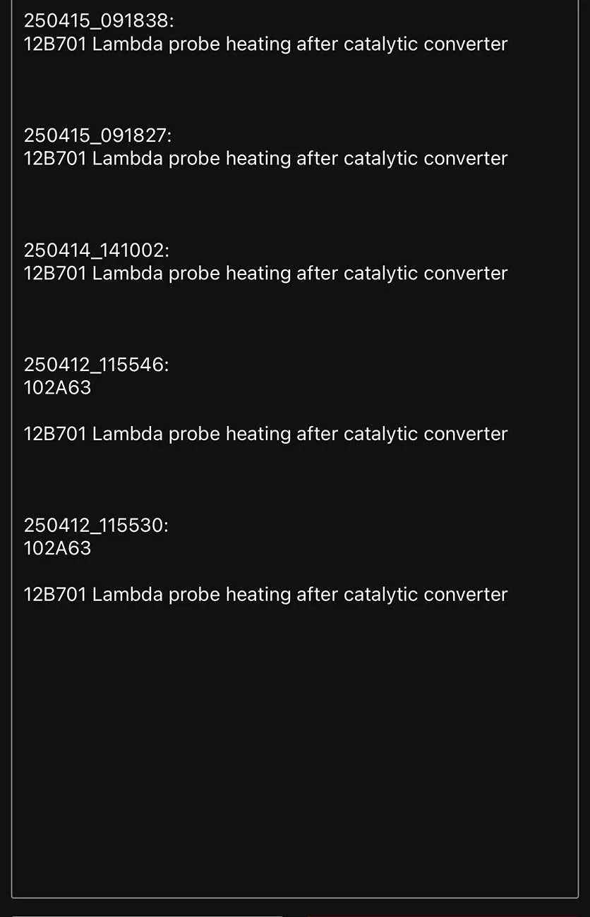

I keep reading that there have been CELs with the new cat and AA either doesn't respond or blames the o2 sensors
What's up with that no CEL guarantee?
we have sold hundreds of them without any issues
and as for the guarantee, if you get the CEL, they will replace the downpipe for free, that's what the guarantee is about
also never had a single warranty claim rejected as far as I know so I'm not sure where you are reading these claims but I recommend posting links to them.

I had a couple of these lately while doing a custom e20 tune, but it was due to my trims being too high which caused it to go into limp. This specific code only came up 2 out of 5 or 6 times it went into limp though. What were you doing when this popped up?

They pop up soon as leave home. Pull over, delete, then keep driving. I have been testing the JB4 on Map 2 lately. Haven’t gone higher than Map2

That's going to be an issue with the dp or o2 sensor. Unrelated to having the jb4 unless you're running ethanol or bad fuel and it's related to the tune not running well

No downpipe guarantees 100% CEL-free experience, but what matters most is comparing the number of failures relative to the total number sold. Based on my own sales, the failure rate is less than 1%.
also, we've never had any warranty denied by active. As far as I know, every warranty claim we've handled has been replaced
