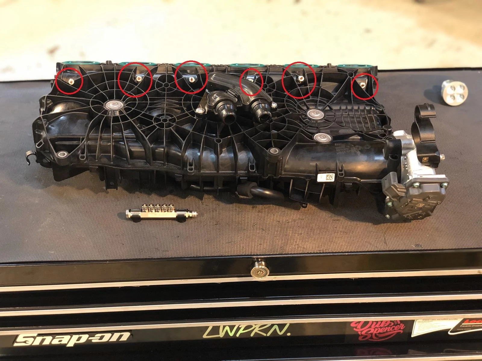

So adding a plate between the head and manifold is not possible?
Well the main problem is at the power levels that require the port injection the stock intercooler in the intake manifold becomes a restriction so that's why it needs a new intake manifold either way. I should have some updates on this before the end of the year hopefully. :)
Ah I see what you’re saying. This seems like a particularly annoying issue.

For sure. But on the other hand, a new CNC intake manifold and a wire tuck would set this engine bay off!
I think without the massive inter cooler, you could really clean up the engine bay.

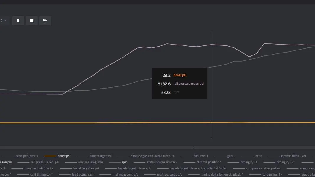

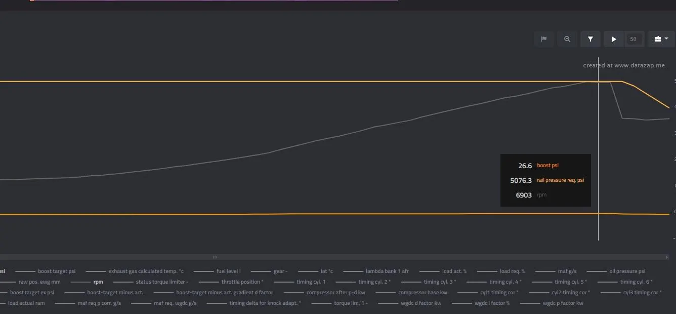

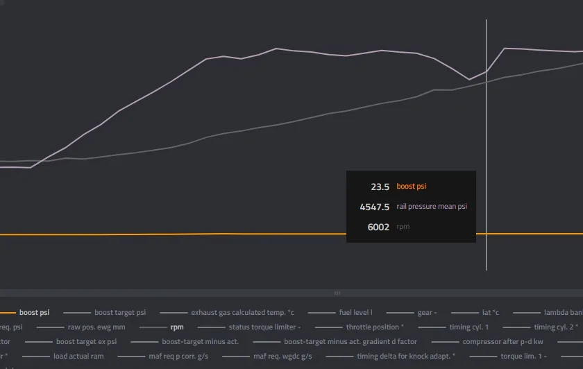

At the moment it is so that the rail pressure breaks in at 23-24psi. (pump gas)
Also meth injection before intercooler helps just a little bit. We suspect it has to do with the intercooler. Maybe it formed condensation water drops on intercooler core.... Or air flow is too small.
(I would also be interested in how it did Adam LZ. In my opinion, this is not possible to achieve this WHP with the setup. I also think the Dynochart is different to everything you've seen about Dyno Supra A90 charts)
Only with direct meth port it works without rail pressure problems.
At the moment we are changing the LPFP. Let's see what it brings...
If you have solutions for the HPFP we can help with testing.
Thank you so much for being very detailed in your responses. I am in the same place you are with my 9280. We are at the 22psi mark without any fueling issues and will be turning it to 23-24psi tomorrow morning. I have a stage 3 Snow Meth kit to supplement when fueling is an issue but it looks like you have found out where.
Yes I predicted that the intercooler would be the first restriction for anyone running more than 600hp on this setup. I will have some solutions soon for this with a full CNC intake manifold. I will keep you posted though. I will also have HPFP solutions coming but it's just not an expedited process but again when I do I'll let you know. Please keep me posted on the LPFP and if that remedies the problem with the HPFP.
Your direct port setup looks nice and excited to see how that performs and what kind of power it's making. You can PM me specific info if you don't feel like sharing to public.
