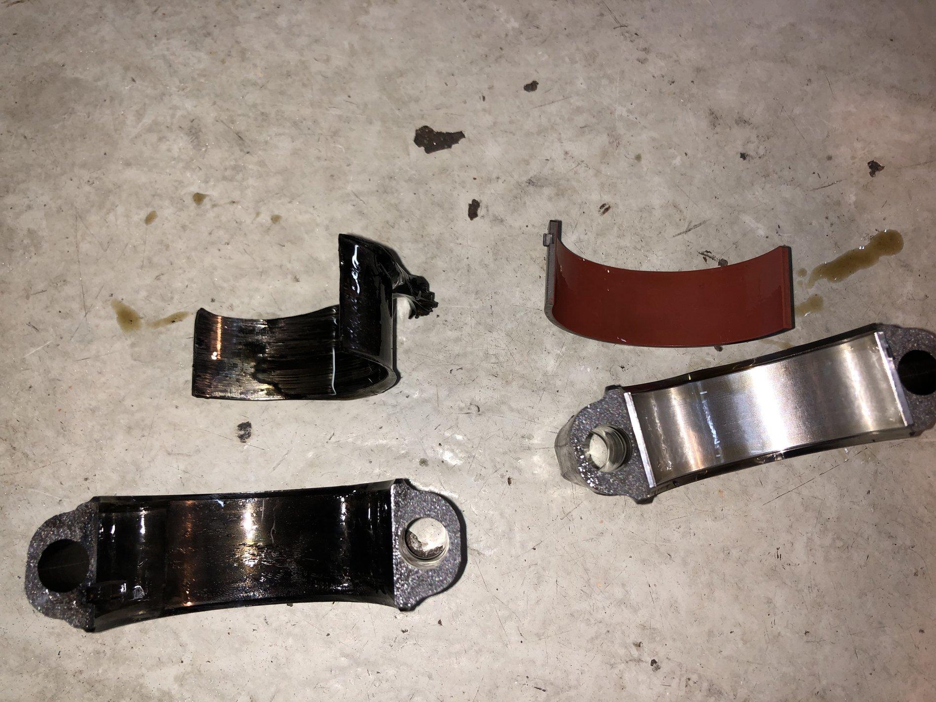

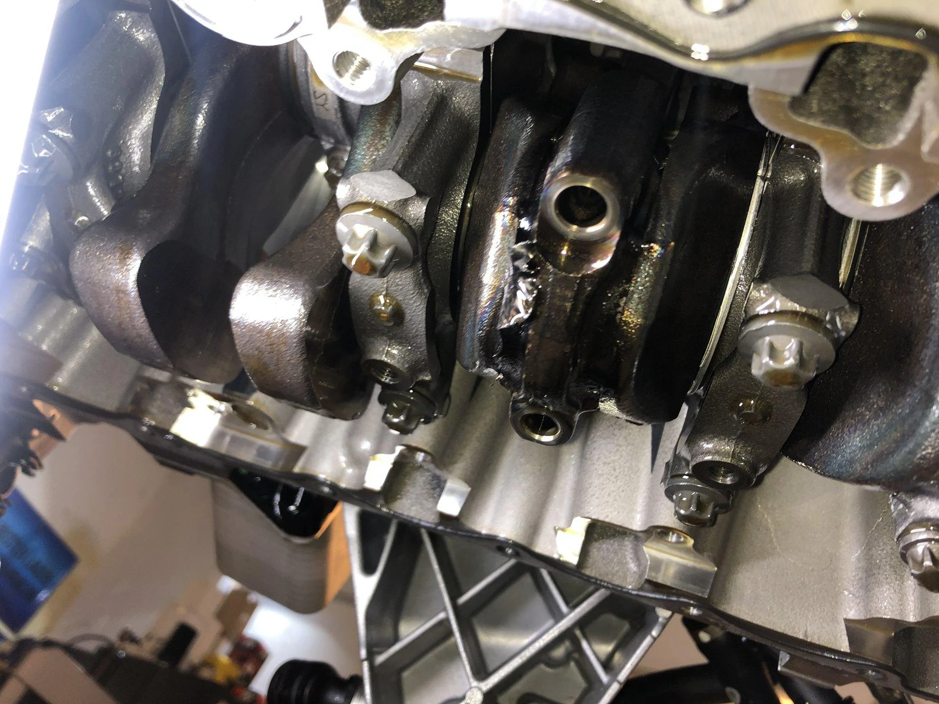

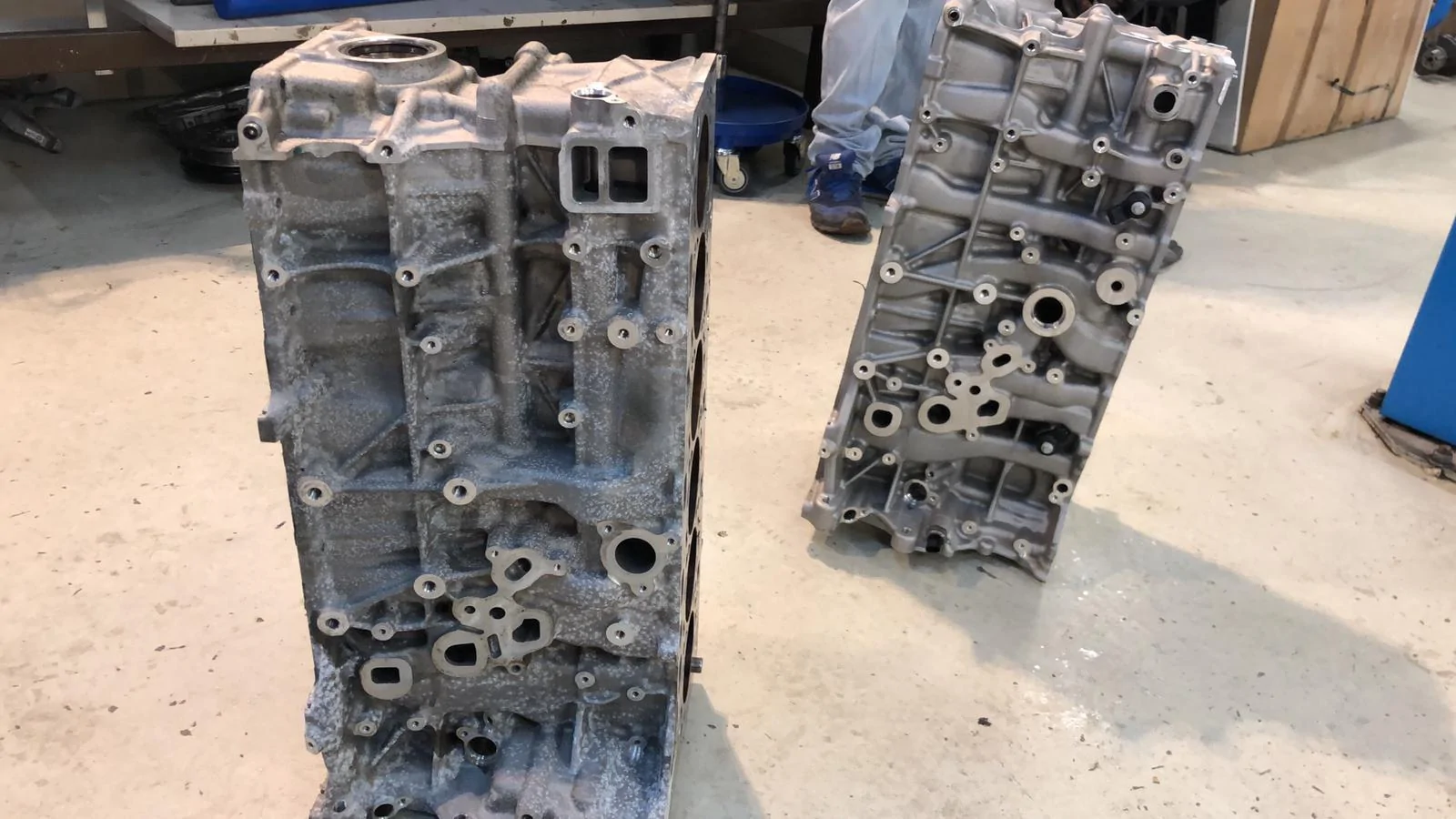

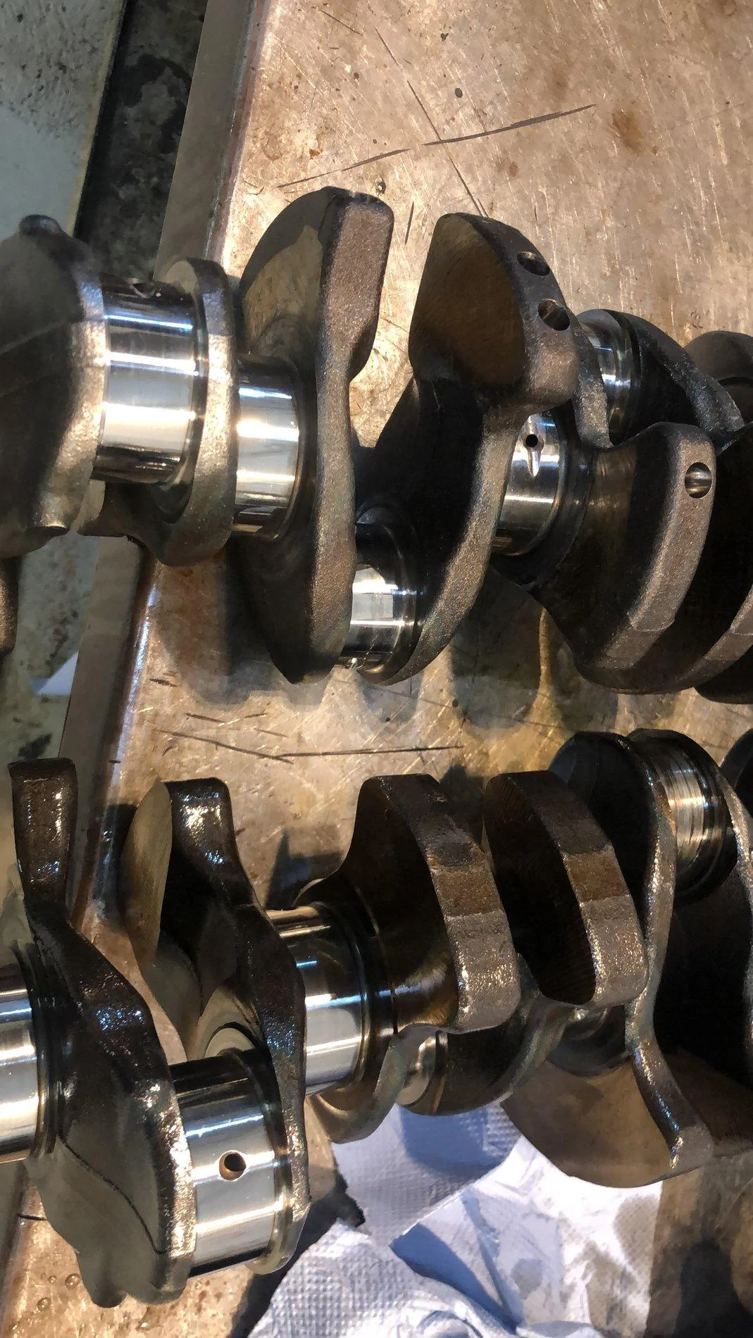

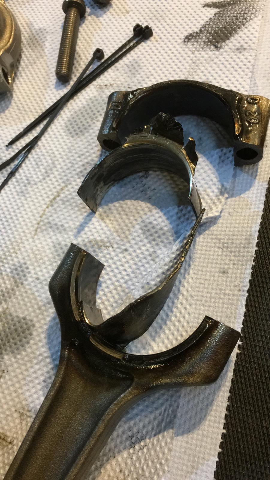

Hi,
unfortunately we have registered here too late. :rolleyes1:
It was definitely a manufacturer problem. We think a rod bearing mounted incorrectly.
As you can see it has only damaged a rod bearing. All other rod bearings are like new and all undamaged.

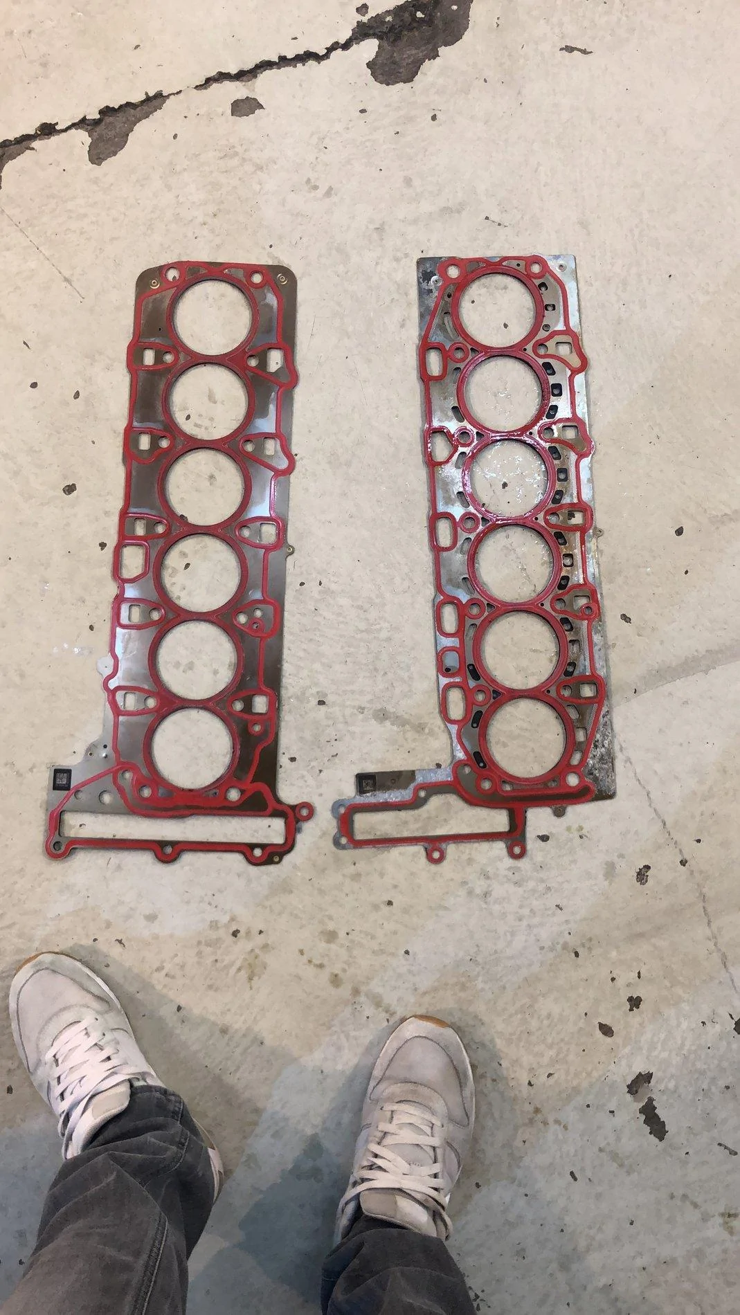

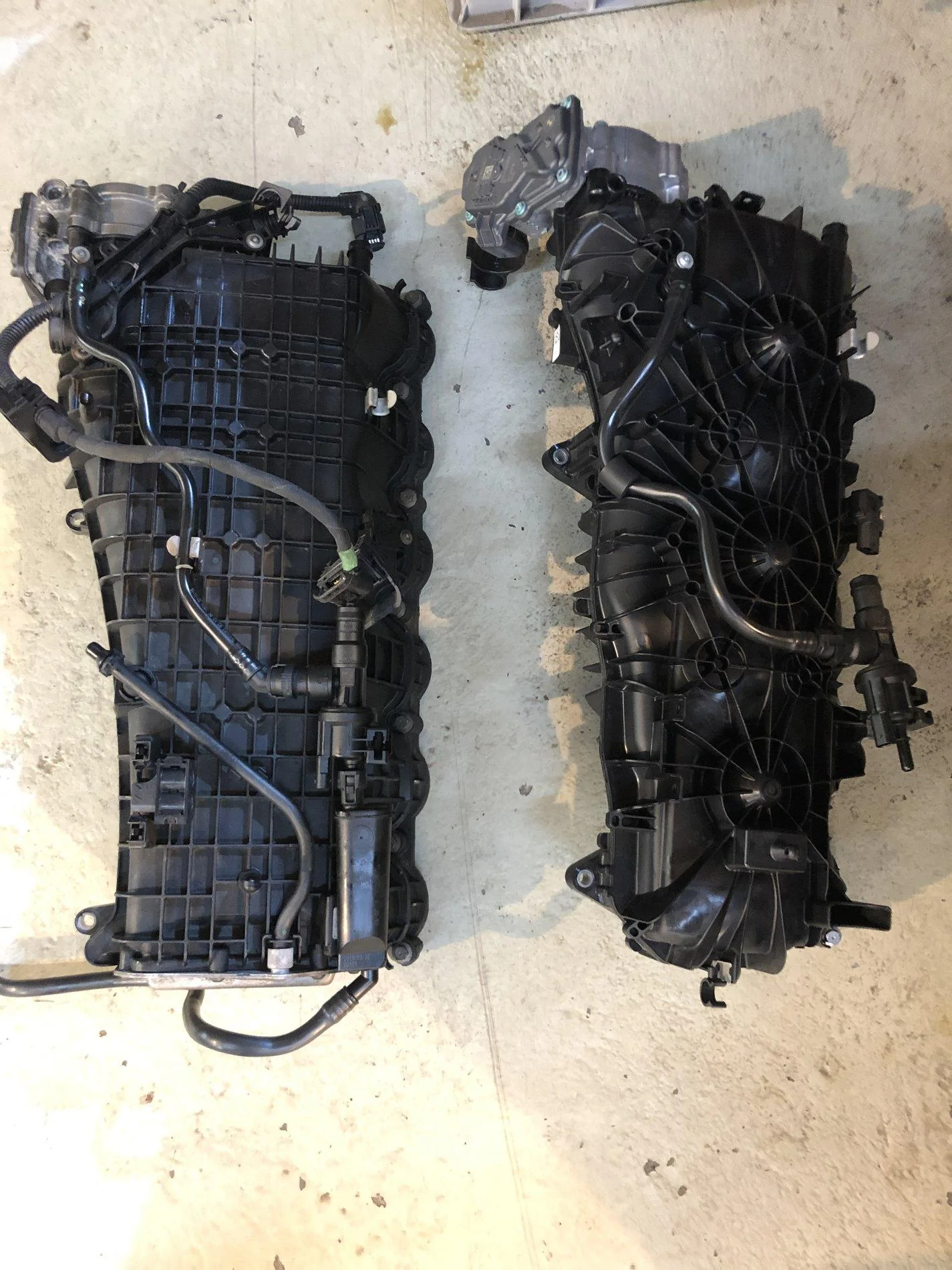

The B58C has a sturdy construction and very different to the B58A.
Block, pistons, cylinder head, chain drive, oil pump, intake manifold, etc. has been changed compared to the B58A.
If anyone has interest, we can make a thread where we talk about the details and differences.
Here only a small insight:

Hi,
An in-depth difference thread would be appreciated, since most users here ( includung me) thought that headifold would be the only difference between b58a and c
Dreihundert
Andy
Oct 17, 2019
40
Germany
Supra A90
We will gladly do that soon and show you details. :)

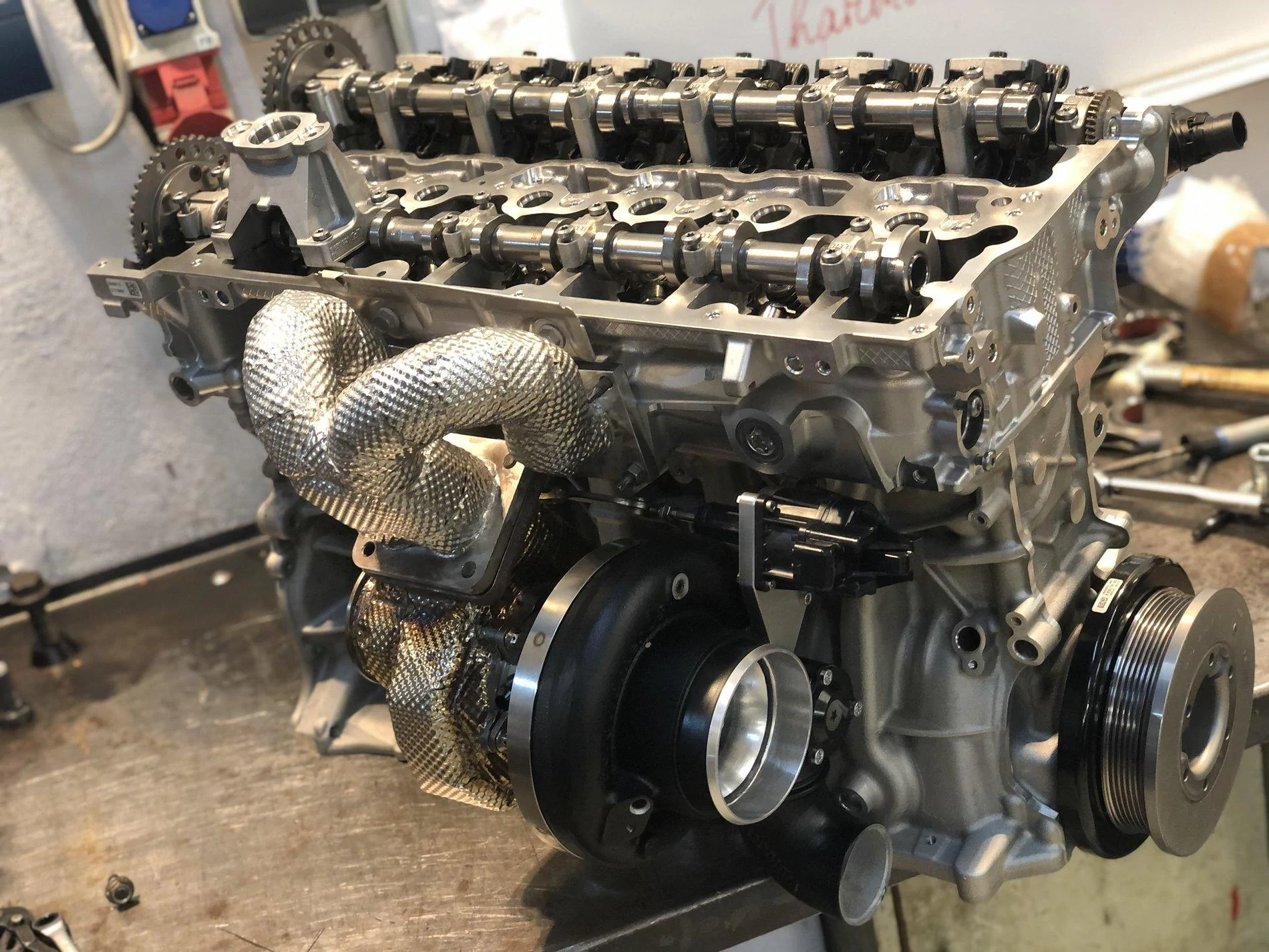

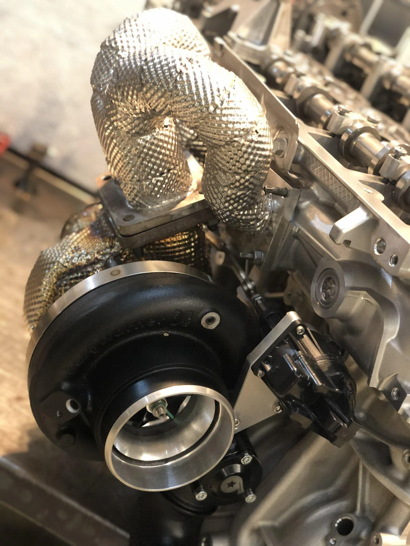

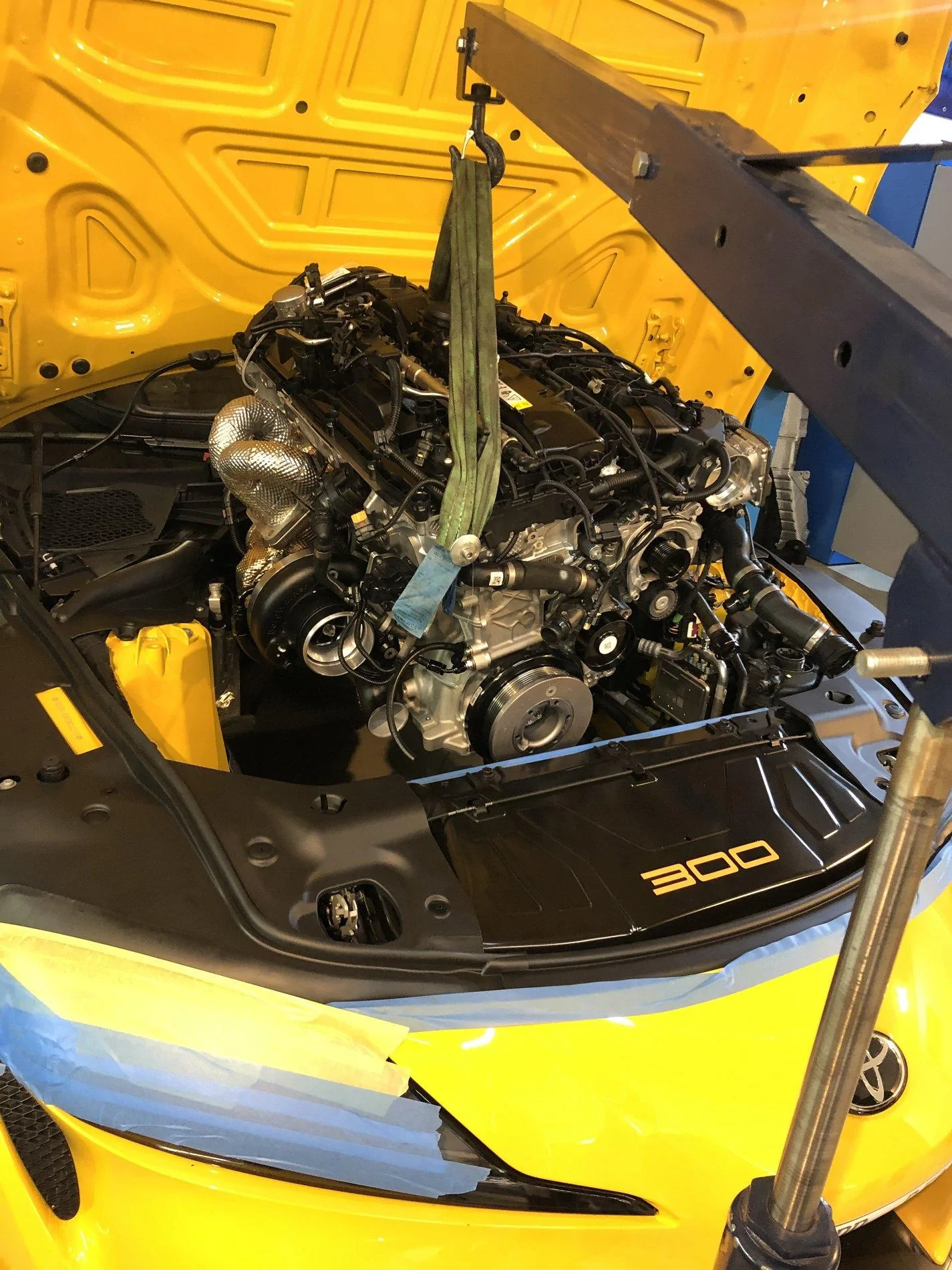

Currently we are at the finale tune of our turbo kit. The engine now has classic H-Desgin Connecting Rods, reworked pistons, modified cylinder head.
because some guys have asked our A90 Supra EFR8474 Kit - up to 950WHP is available end of October.
Introductory price is $ 9900 with custom tune via MHD (Pureboost)
(on request we give special forum discount)
The kit contains everything you need for installation:
- modified EFR8474 Turbo (thermo-insulated + turbo Compressor Housing in your desired color
- Exhaust manifold (thermo-insulated)
- chargepipe with meth bung
- thermo-insulated downpipe (on request with or without 200 cells cat)
- Oil hoses / pipes
- Silicone Couplers / Clamps
- Turbo Gasket
- exhaust Gaskets / Nuts / Bolts
- Oil Feed Line Kit
- CNC bracket for original Wastegate Actor.
- Coolant Pipe / Hardware
- custom tune via MHD (Pureboost)
everything plug and play...

Hi,
