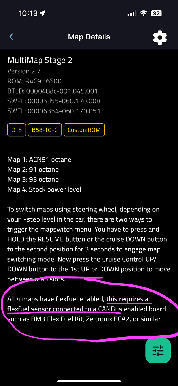

Yeah when you run Multi Map and you have the BM3 Flex Fuel Kit .. it will adjust all the way to E50 , nothing to do as far as picking a map.. I just put 91 and now have a reading of E28 it already feels better.. I thought I was recording the runs.. but did not log ill go tomorrow and try multi map and tune pur e30 tune and see what's up

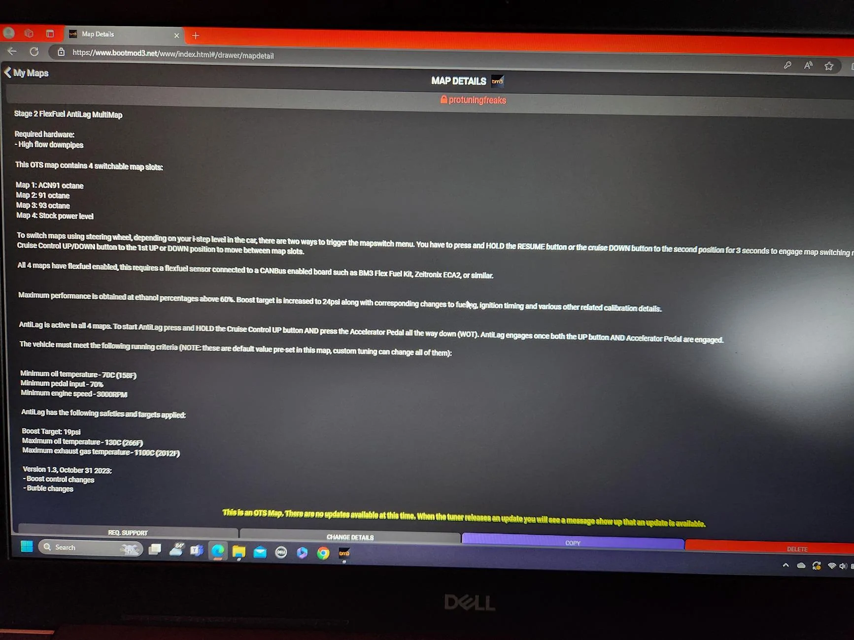

Strange, per bootmod max performance is at ethanol levels of 60% and above.
Yea saw that .. sounds fishy... Maybe with supporting mods? dont think stock fuel system can handle e60

Not familiar with BM3 as I have MHD, but you are in map slot 3 with e40 and 91 was map slot one. If your running flex fuel I would assume it should be the same map slot?
Well, just did some logs with 27 ethanol feels much better… I think that’s the sweet spot for this car in this heat
