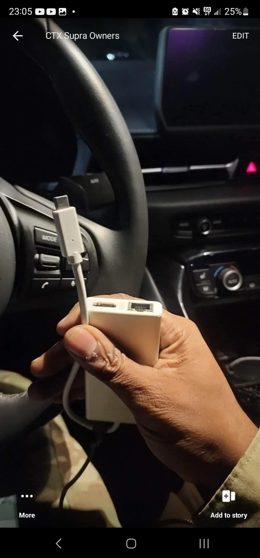

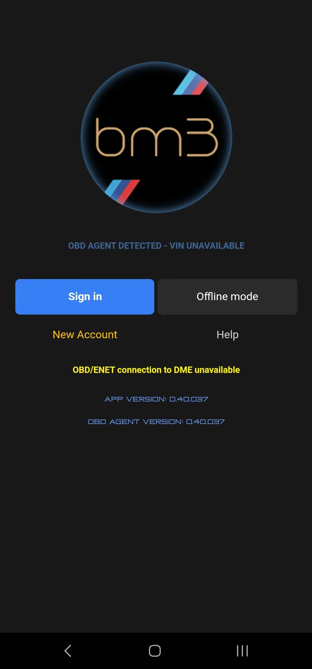

Please just do this from a laptop with Ethernet. Android supports USB-C Ethernet adapters, but you have to specifically buy one with Qualcomm chipset or it's not going to work. Whatever you're holding in your photo probably doesn't have a Qualcomm chip.
This isn't working because the Ethernet adapter for the phone is the wrong kind OR you did not manually enable Ethernet tethering in the phone settings after connecting everything.
This has nothing to do with the car running or not running, how many times you pressed the ignition button, what app version you have, blah blah.
It's the adapter. Use a laptop.
I'll try and use a buddies laptop, I dnt kno what any of that is going to take your word for it. Does this mean I have to keep going bk and forth to his house to flash my car? And i have turned on tethering mentioned that a few times. But I appreciate the help gratefully ??, I was getting way to upset. About it running something else was wrong

Like @Thraxbert explained better and like I tried to tell you before, you need a different USB-C to Ethernet adapter to get it working. Or a laptop or a long ass ethernet cable to your desktop lol.

I went to best buy and brought a different adapter didn't want to wait for the delivery
