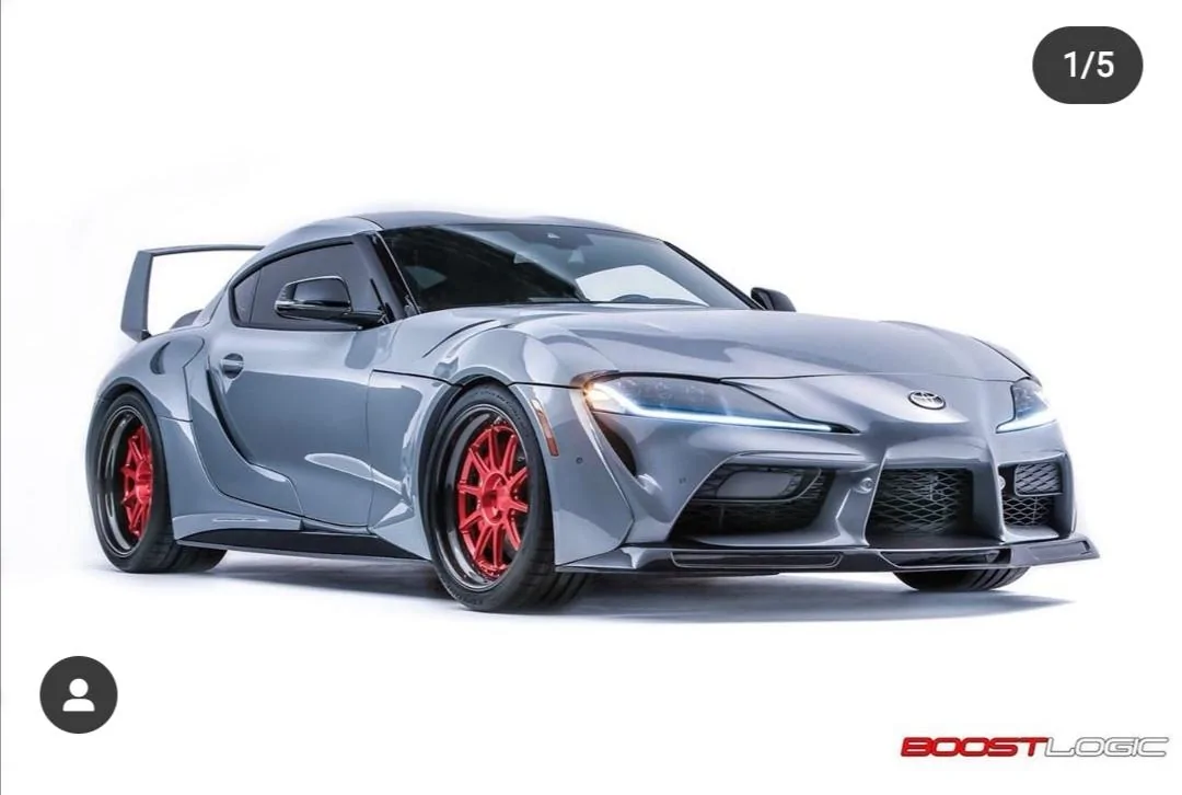

Soo, you've seen the hyperboost supra at Sema and the dyno pulls, Boost logic claims 750 HP with the turbo kit.
I am definatley down for one, anyone knows what turbo is it? What other fuel mods? Ecu? Will a piggyback suffice or do we need to go with a flash etc?
Stock Intake? Intercooler? Etc..
Anyone with sure details, please share.
We want in on the kit contents and prices!!
