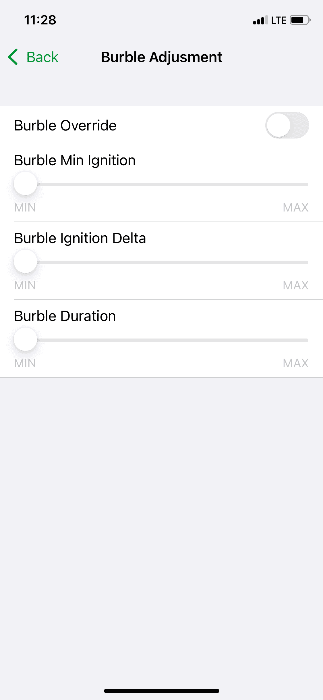

Any idea if a tuner can entirely remove the "gurgle" noises in sport mode when you're really down low in the revs? It sounds like water going down a drain...

What’s burble override & ignition delta?
I've never used Ecutek interface but I feel like you're supposed to enable the override to in fact override burble to min.
Screenshot isn't overridden, thus is at stock burble imo
This is correct, hit the burble override button, then you'll be able to drag all the min, delta, length parameters to anywhere you want.
yes, I left it in stock setting and it still loud as hell. It is a 2020…..
