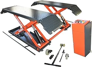

We just ordered a new GR and trying to get orchestrated here.
I know the GR has jacking points,
But
Can it just go on a normal scissor lift being raised on the outside of frame, on both sides?
located between front and rear tires?
The front and rear wheels will hang .
This is how I have done many cars (hundreds) and never a problem.
But I have to ask

There's jacking points infront of all 4 wheels that are more or less in the same place where you'd find the frame rail jacking points on other cars. Just get a couple of cheap jack pads to slot in to the jacking points so you don't destroy the plastic ones, and you can raise it on a scissor lift just fine

I am hoping that I can just drive onto this lift and hit the switch and up it will go.
It has worked for Porsche, Corvairs, Dodge Chevy, Ford etc etc etc
I don't k now what could be that much different.??
But I thought I would ask.
I guess I will have to inspect the bottom of the car carefully, and see for myself.
With the weight spread out and not point-loaded, each ramp , (about 16 inches wide by about 5 feet long) I will hope those will work.
But maybe they have some protrusions sticking dwn>?
The lift looks a lot like this
