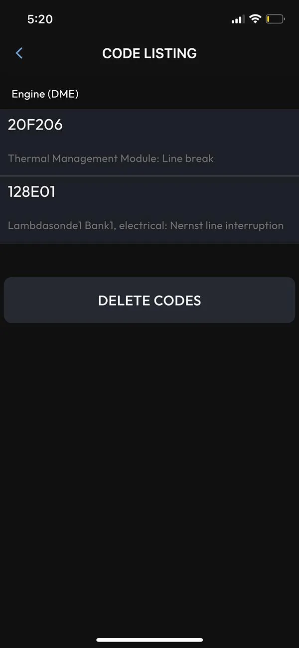

Hello everyone I’ve been getting these two codes recently when I scan my car. I was wondering if someone could point me in the right direction on what it is? Possibly. It’s been causing my car to go into limp mode

I forgot to mention I’m running a catless downpipe, exhaust, and intake

I'm curious how long after these mods before the codes started to appear.

Lambdasonde is German for "lambda sensor," AKA O2 sensor.
You have a CEL because of your catless downpipe. You cannot fix it without a tune (in b4 someone with a defouler goes "WELL IT WORKED ON MY CAR") or restoring a catted downpipe.

OP are you tuned or stock map? Bank 1 sensor 1 would make me believe primary 02. Is the car going into a limp mode or just the CEL?

I was tuned on a bm3 ots map, but I went back to stock because i thought the tune was causing my car to go into limp mode. I tried taking it to Toyota and they told me there was nothing wrong with my car and they weren’t getting any codes on their end :/
