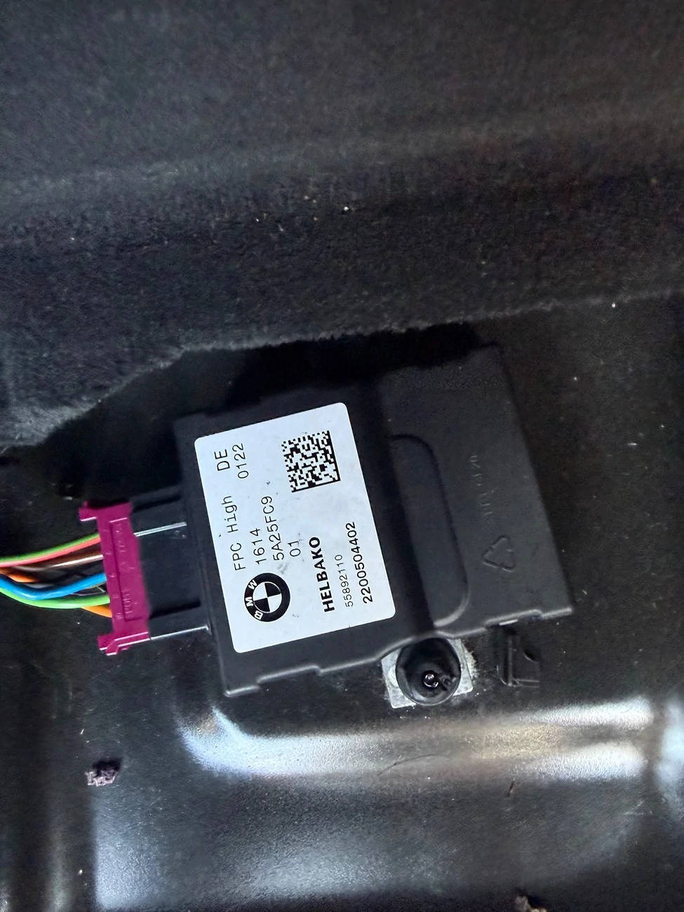

Hey guys. Another update, so my car has been going into a forced limp mode while driving and occasionally has a drivetrain malfunction pop up, car tends to go back to normal after restart just randomly happens and just kills the car. Just got the car back from toyota, they ended up wasting my time and money essentially stating they only allocate an hour for their techs to diagnose and upon visually looking at the car they decided it needed more time or a electrical diag so essentially paid the disnglsis fee to be told they need more time.
Bright side, got these two codes:
11B030
11B033
Any advice on what these could be for? I’m thinking it could be my LPFP module?

Do you think this could simply be an issue with my EKP?
I got rear ended a couple of months ago leading to some water getting into my rear, could it just have fried this module? Or should I not waste my time and look into just swapping out my LPFP?

Looks like that Pump Control Module is around $35 bucks, change that out before messing with the pump.
  • 21-26 BMW G80 G82 G83 M3 M4 Fuel Pump Control Module 5A25FC9
