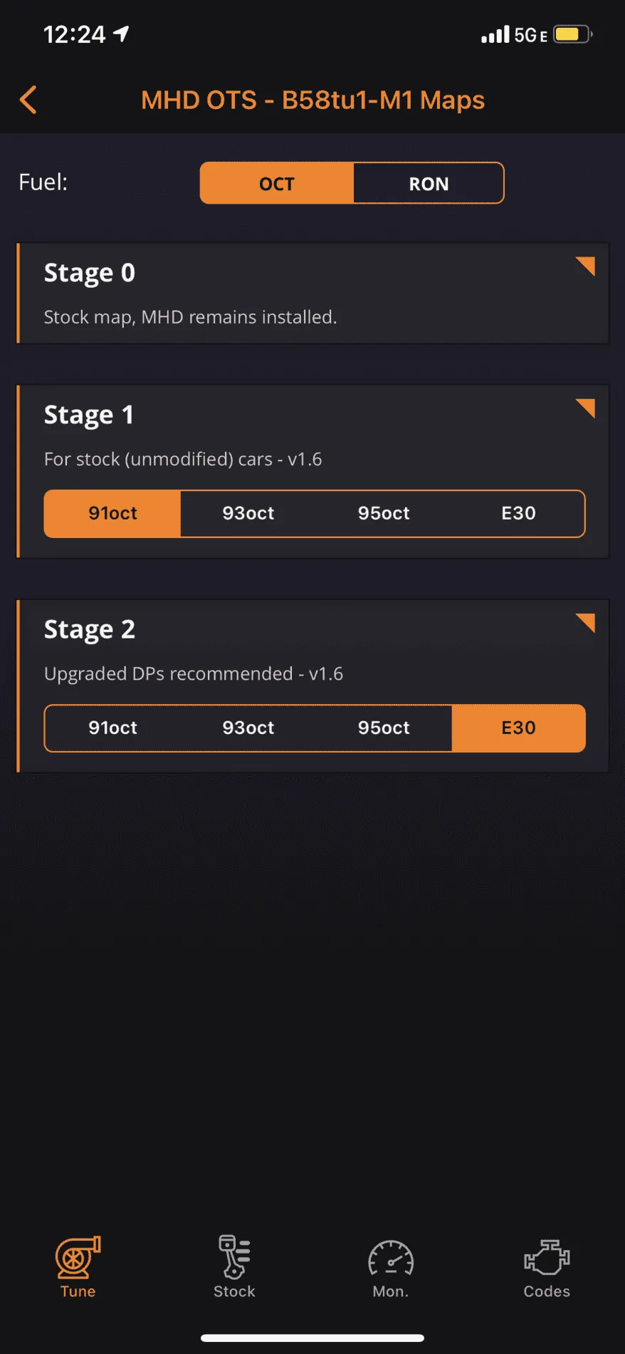

SD_MK
May 10, 2020
2,037
4,029
SD
2020 3.0 Premium
Haha. They should be releasing them to everyone pretty soon. At the moment they are still classifying them as beta maps.
EDIT: Also one thing to note is that my tunes are different than yours anyways because of engine differences, but I'm pretty sure the M1 should be getting revised maps as well.
The M1 gets the short end of the stick wtf. ? like E30 is cool and all, but i wanna sauce people wtf.
