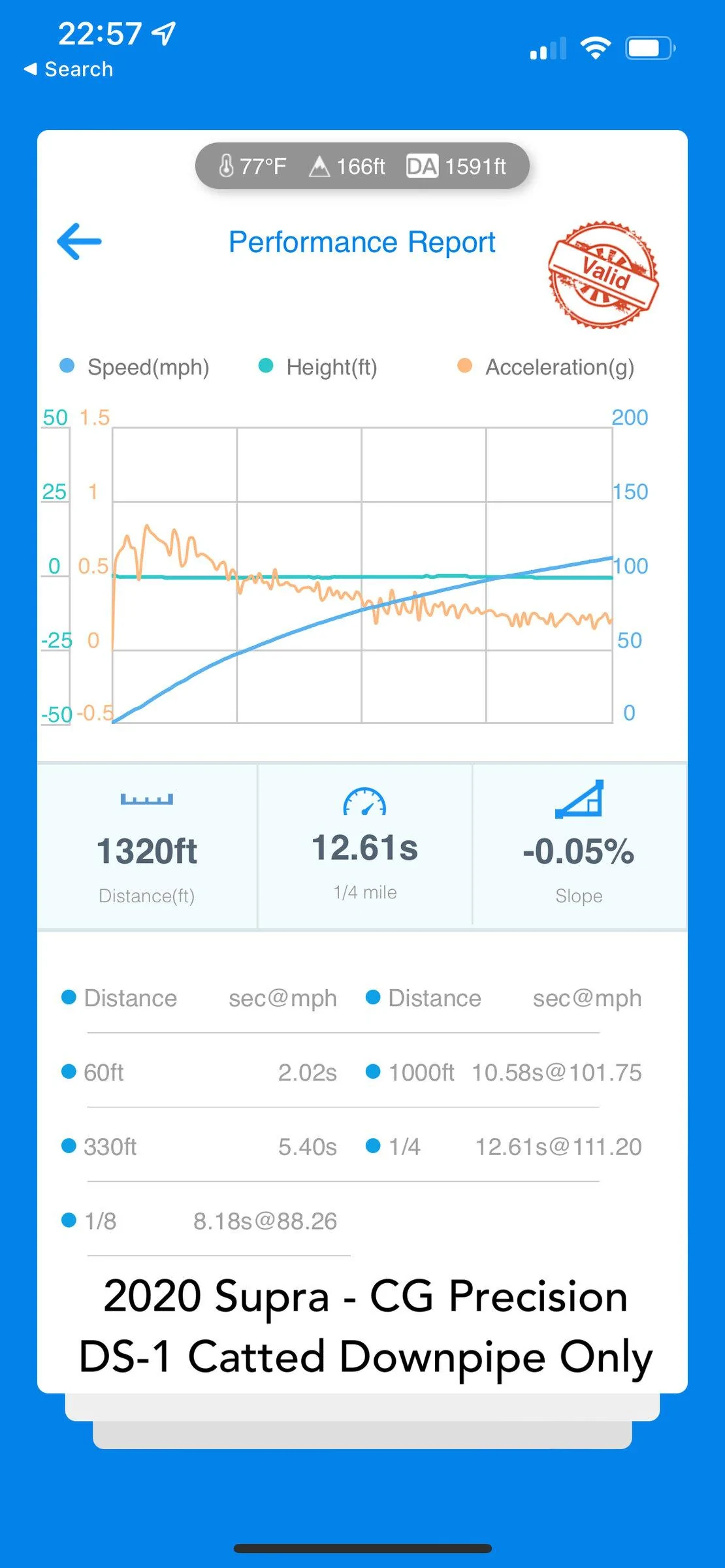

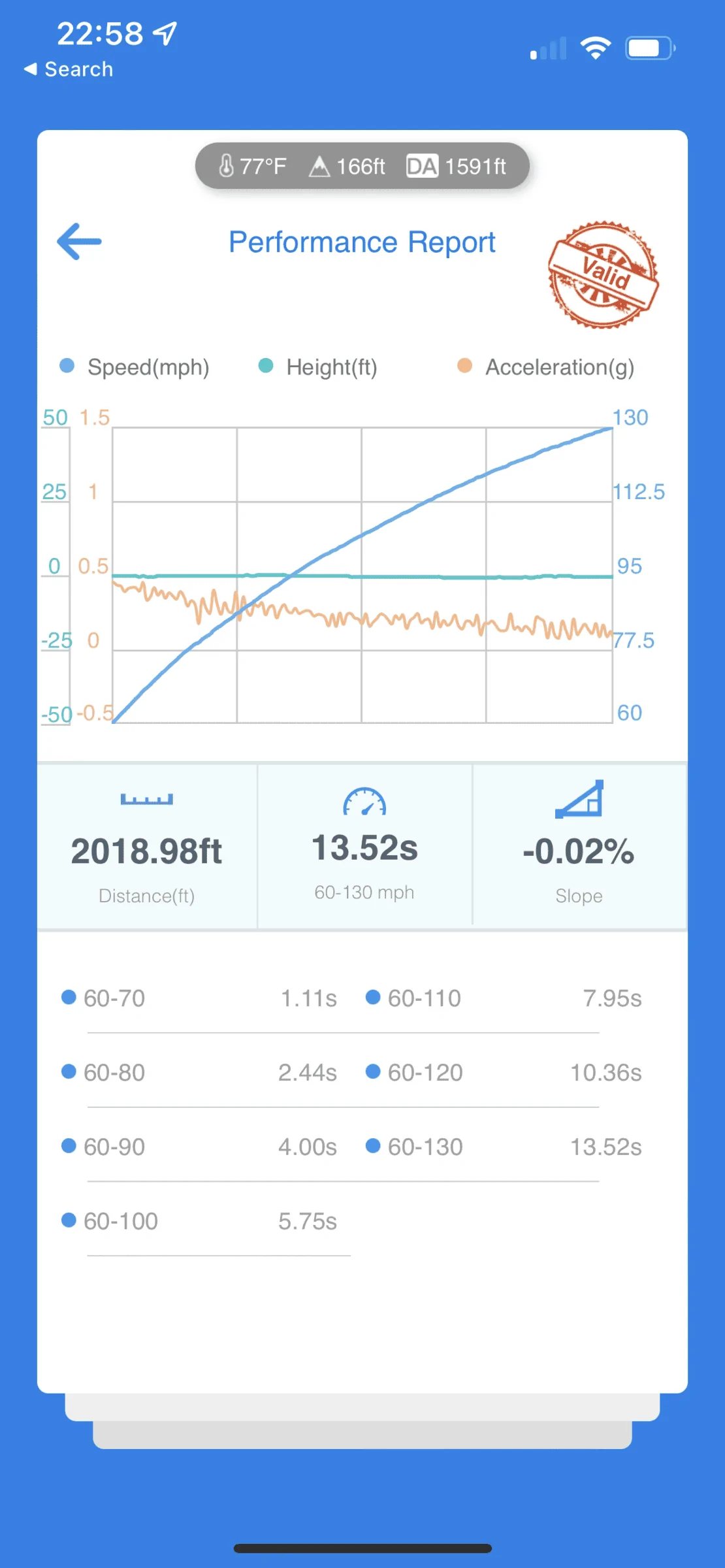

Downpipe only dragy runs below.
Stock dragy runs: https://www.supramkv.com/threads/slow-stock-60-130-times.12581/
Comparable DA (~500ft difference) with Michelin PSS on the street.
Stock 1/4: 12.57 at 110.56
Downpipe only 1/4: 12.61 at 111.20
Gain: + .64 mph
*Wasn't looking to continue launching to cut 0-60 given this is on the street. I was focused on trap.
Stock 60-130: 14.06
Downpipe only 60-130: 13.52
Gain: -.54s
Conclusion: Nice improvement in sound. Barely noticeable power gain with the butt dyno, and minor objective gains in performance.
I'm OTS Stage 2 now, so I'll share dragy results soon.
