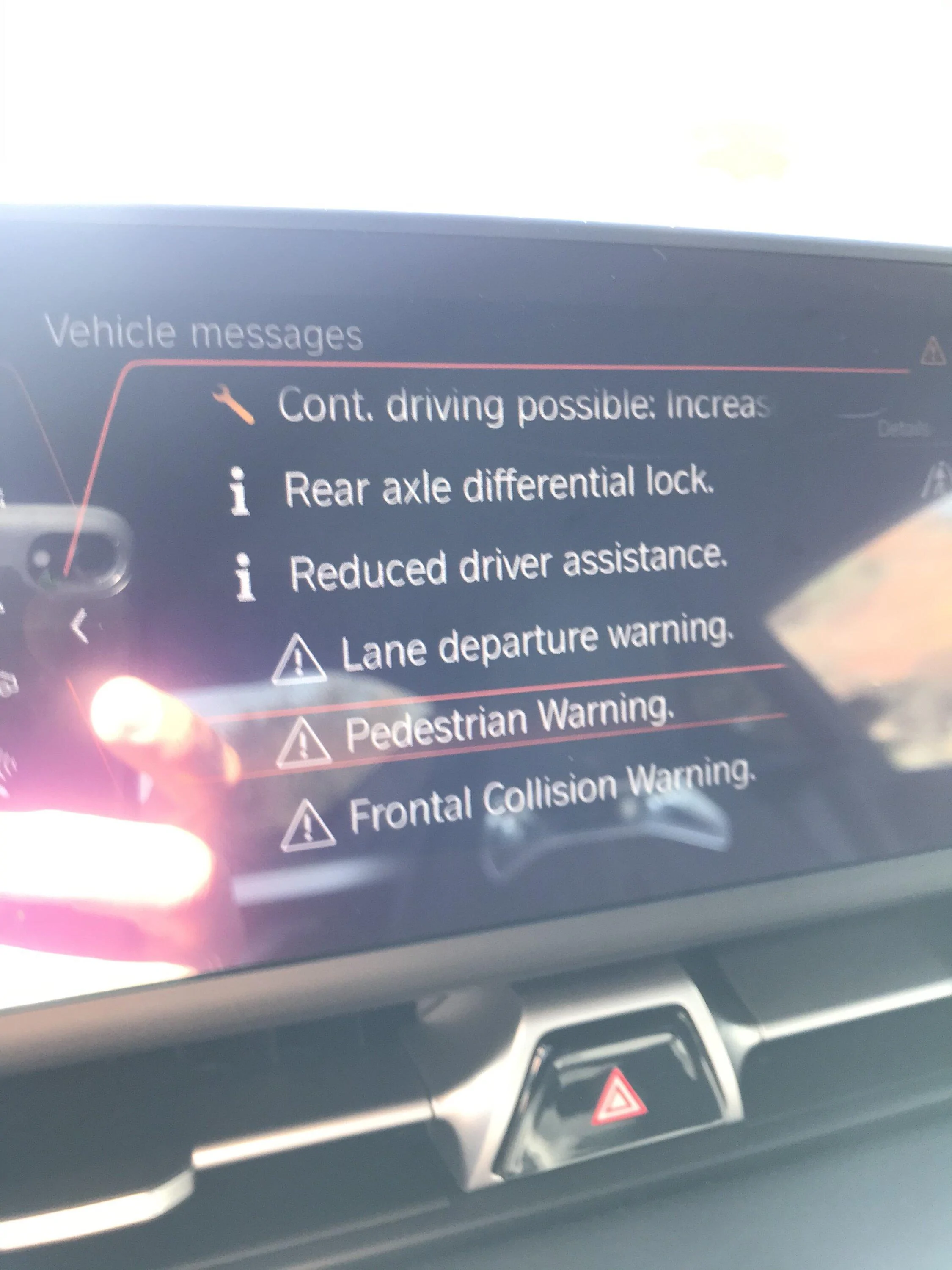

Mine did something similar and had to be towed back to the dealership with 1500 miles on it.
It went from the errors to a failed electric power steering rack (EPS). I think the timing of the two was coincidental but who knows.
I lucked out and the Supra tech was awesome. He had to reset the computer and replace the EPS (all under warranty). I've spoken with him a couple of times since and he claims its still the only one they've seen with that combination of issues (although I don't think its the only one he has had to reset).
I attached a pic of the errors I was getting. Tried to upload the video I took at the time but it was too large to upload.
My two cents...with 2K miles on it, it's under warranty. I'd remove the JB4 and get it checked out if it starts acting up again.
P.S. Mine had a lot more errors than is shown below. New ones would pop up as soon as I would close a set. It was frustrating but easily fixed by the dealer.

did the error messages happen multiple times before? Or they just all happen all at once?
It seems like initially it had a couple of errors that would clear for a few days by turning the car off & back on.
It became more frequent and the errors were coming back quicker after restarts until I had the dealer take a look (the power steering going out is the thing that pushed me over bc I was being stubborn before that).

woah that seems super frustrating, Ive seen all those errors you we’re getting except mine wouldnt keep going like yours, just simply turned car off for 5 min and they were gone, although its been about 2 days now since I disconnected JB4, still no error codes, if they persist I will definitely go to dealer because I too have been stubborn
