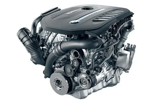

But is it driven off the engine crank? I thought it was driven with an electrical motor so the AC could function with the engine off
Belt driven off the crank. All we have is the alternator and AC pump. Water pump and power steering are electric.
I stand corrected. So, with the engine start/stop feature, I guess the AC compressor doesn't run when the engine is off and the remote comfort climate feature can't actually use the AC to pre-cool the car then. Interesting.
You are correct. If you use the stop/start feature, it will still work but the engine will kick on when it needs the ac to work. So if you are sitting a light, it will kick the engine on and off as needed to keep the ac blowing cold. Think of it as a halfway working start/stop system haha. The remote climate comfort system does not kick on the ac. It will only vent outside air. So stupid....
