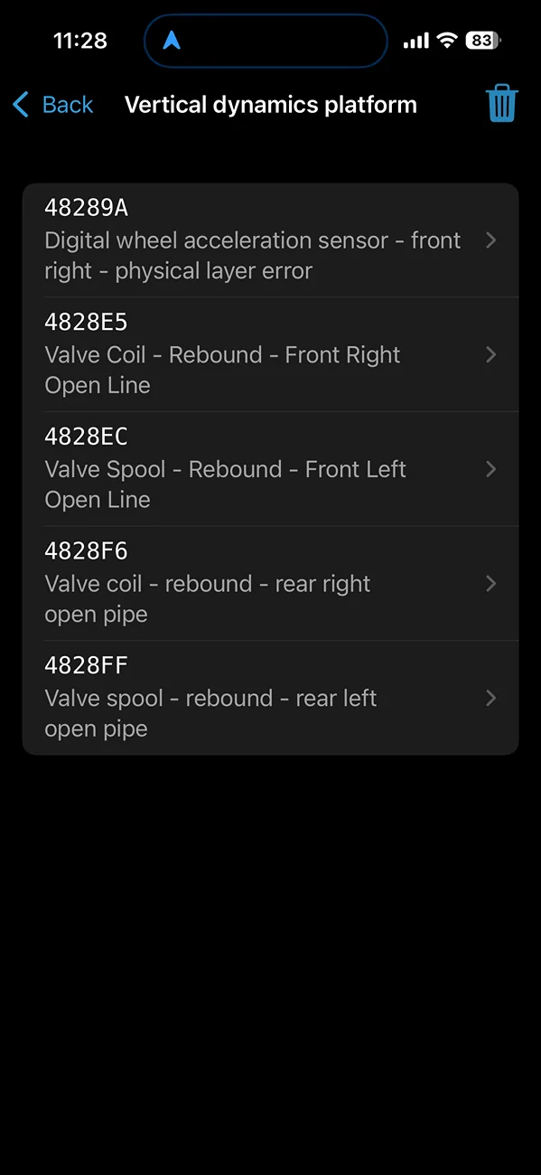

i just followed what the Pro Tool tab instructions said to do exactly. Instead of letting it remove things from all 7 systems, to select the certain ones, they say to. the message I was having about the headlamp malfunction is gone now. But now I have a message that says "driving possible: chasis." i am able to go into spot mode and turn traction off, so everything works as it should. here are the codes i scanned with bimmerlink, but it doesn't let me clear them.

double check your wiring and connectors
