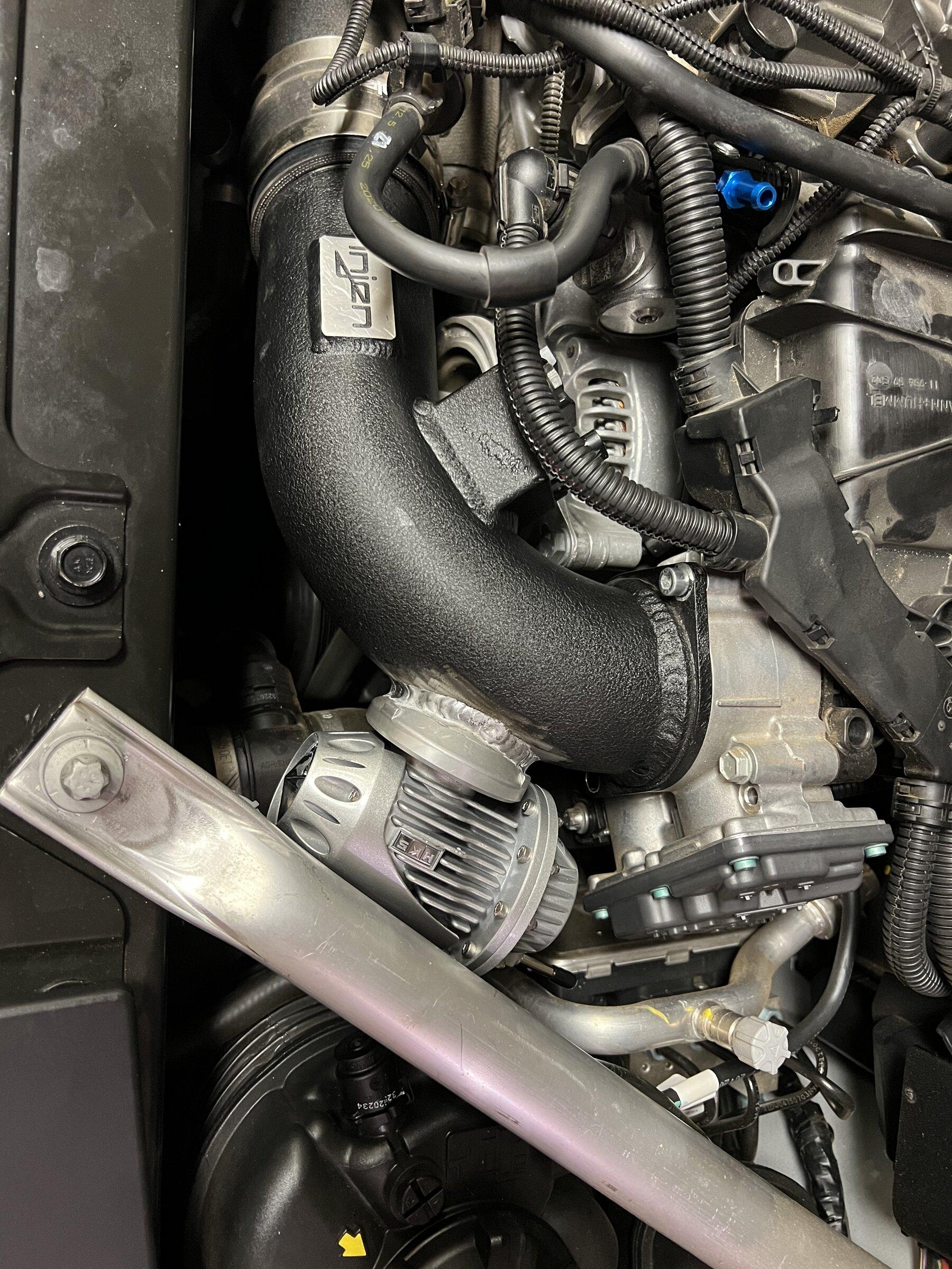

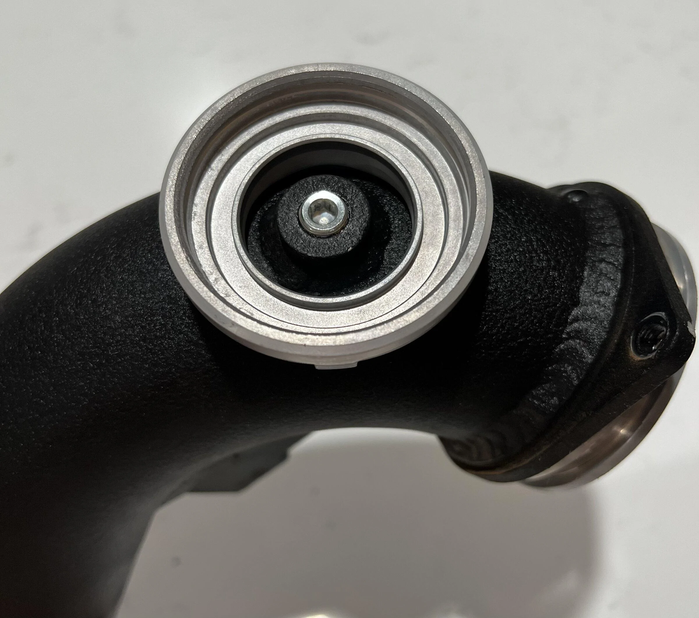

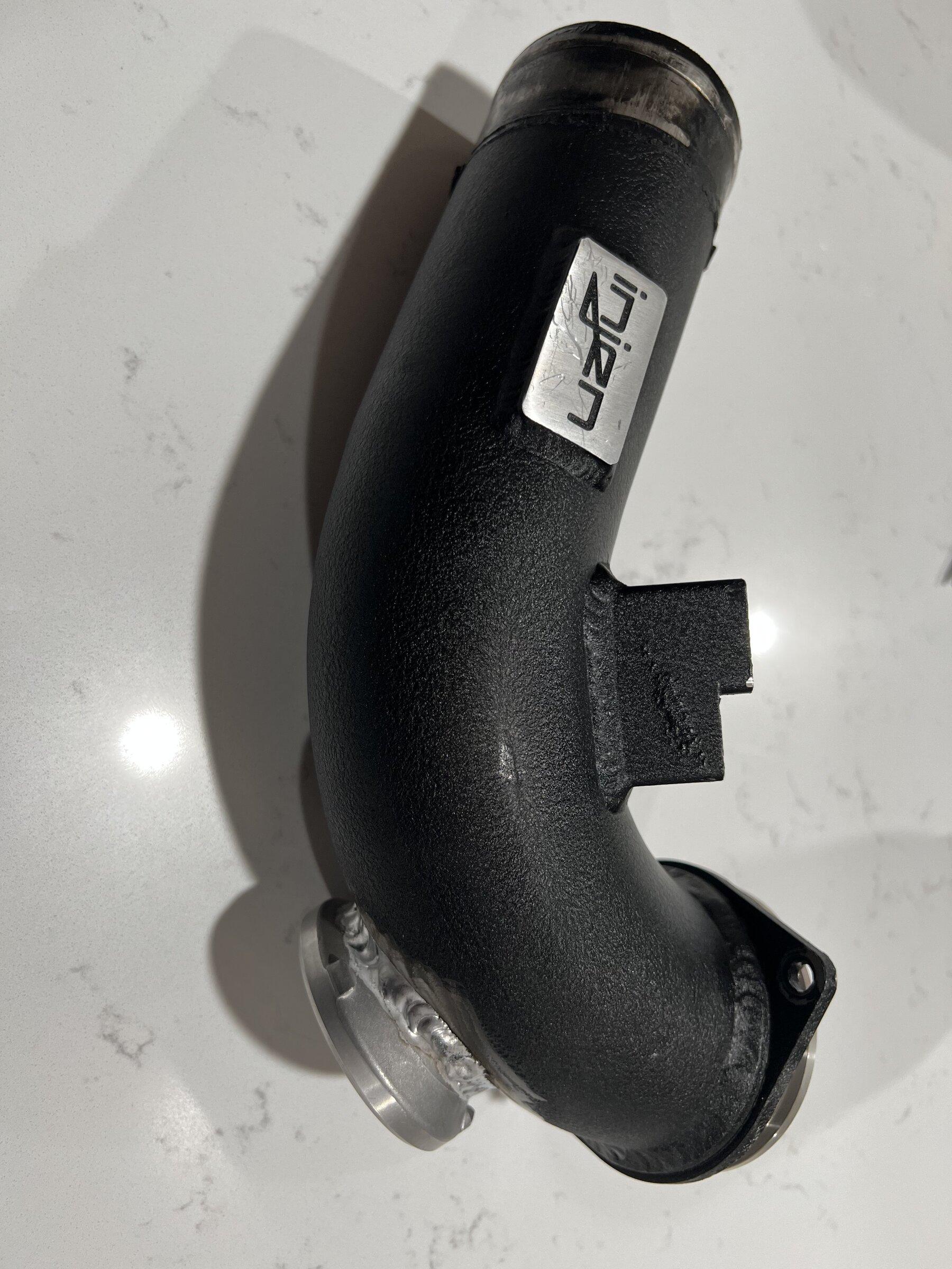

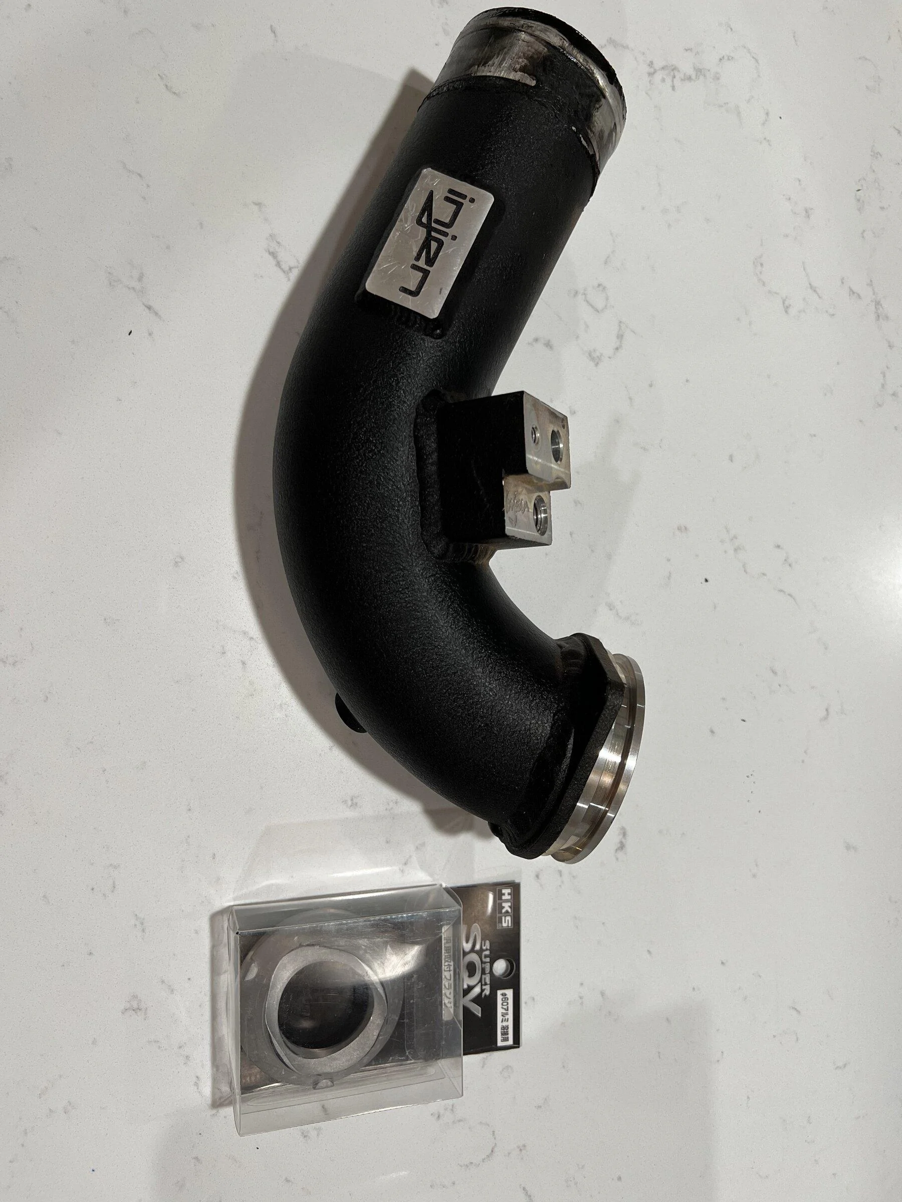

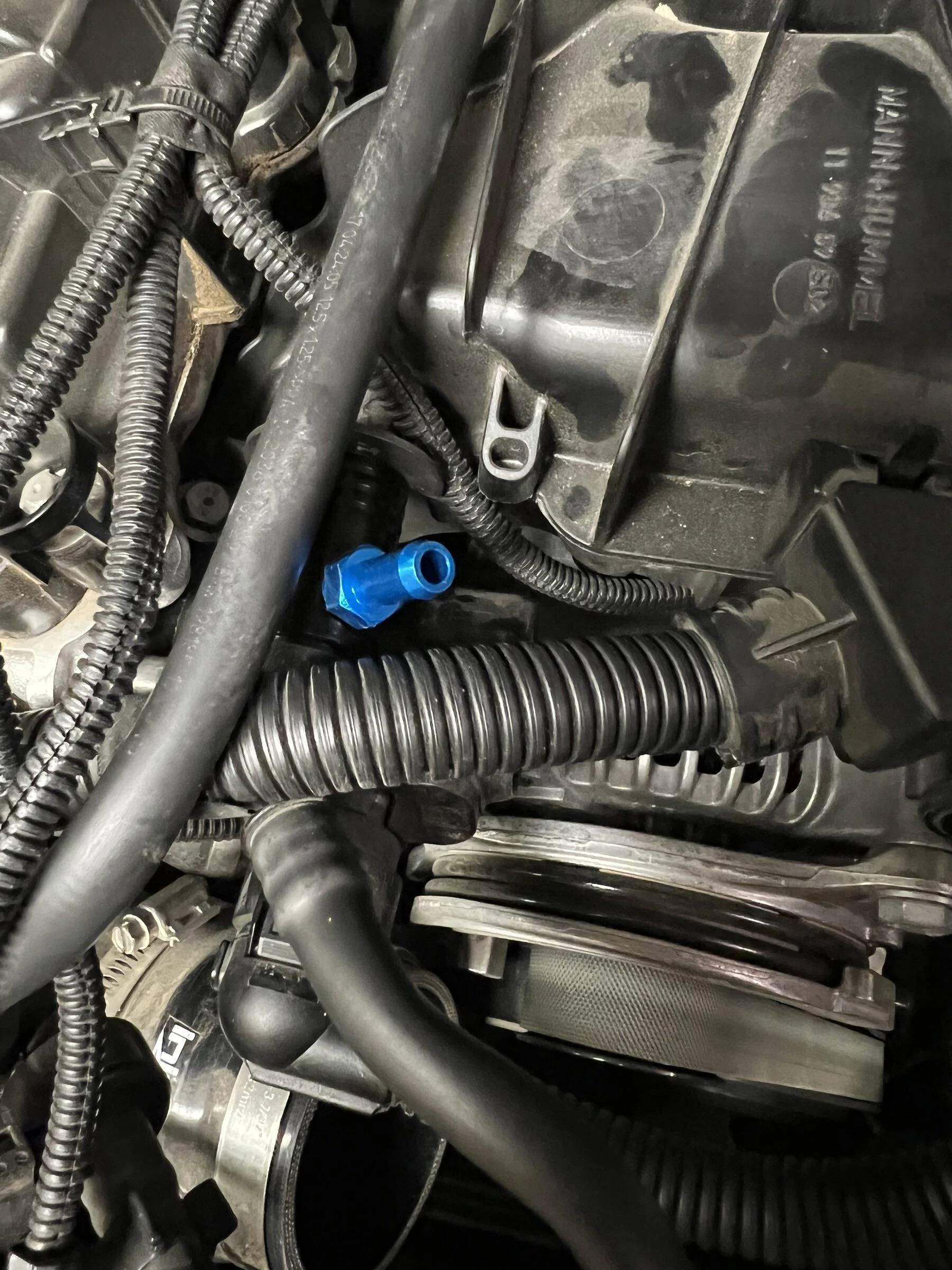

My first intention was to wait until the VTT black kit came available and write a review on it. However it was on a pretty big B/O. So I decided to get this moving. I purchased an hks flange, hks ssqv, vtt boost reference kit and went to work. Here are some pics. After the flange was welded I am test fitting to make sure everything clears and works properly before final powder coat.
Cost so far:
Hks bov - $225
Flange -$20
VTT boost ref kit - $50
Welder- $75
I had to get back to work, I will finish putting the vacuum hose on and fishing the throttle body bolt that fell down into the abyss. Will post more later.

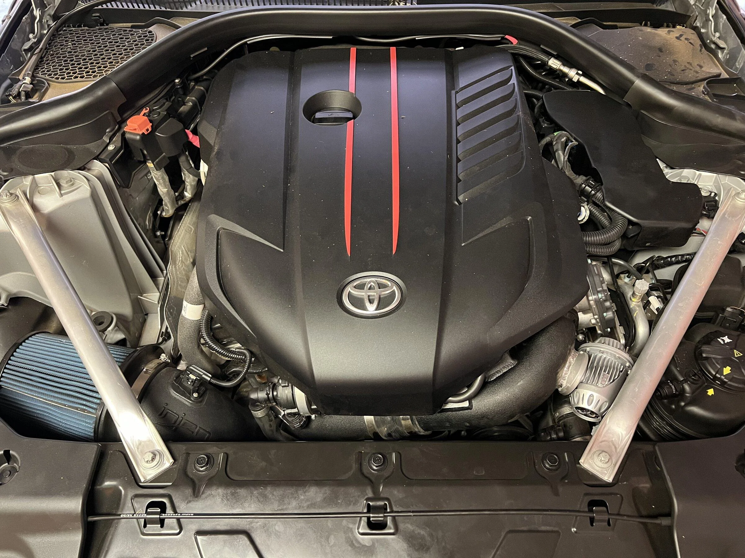

All is completed and works just like a bov should. Now I will take it apart and send to powder coat.

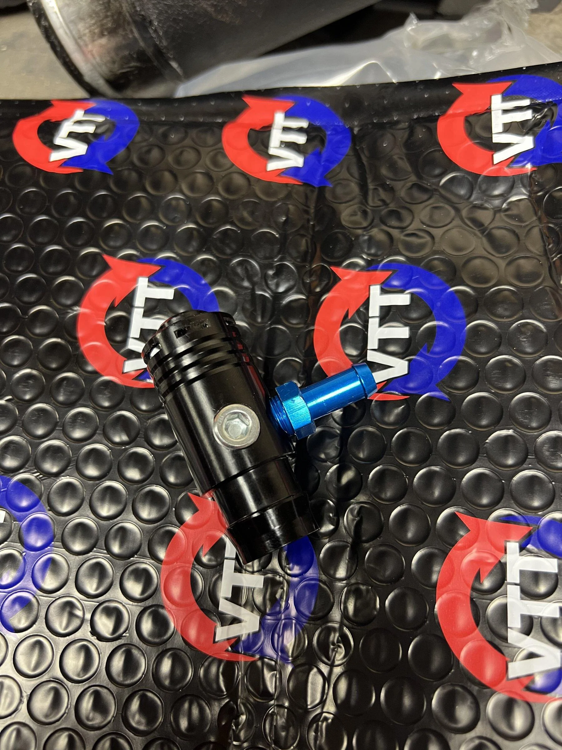

The bottom right insert in the hood cover will not go all the way down due moving the vacuum port back. I can notch the cover or use a different reference source.
Like this one.

I can tell you with certainty that you WILL NOT find a new boost tap like the one you linked a photo of. Trust me

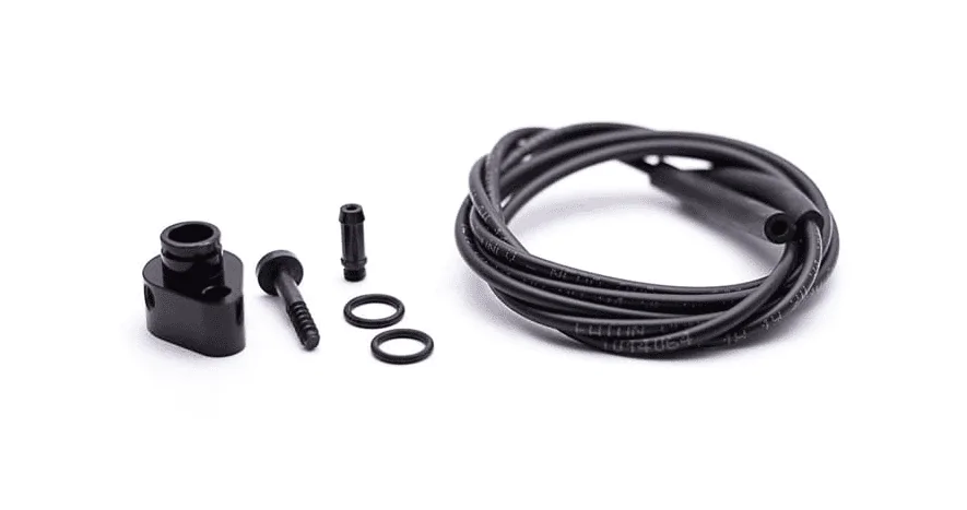

How does the Boost Reference Kit work?
WITCH3R
WITCH3R
Colby
Apr 25, 2022
66
51
Lubbock, Tx
2021 Supra Prem.
It provides a vacuum port for the bov.
