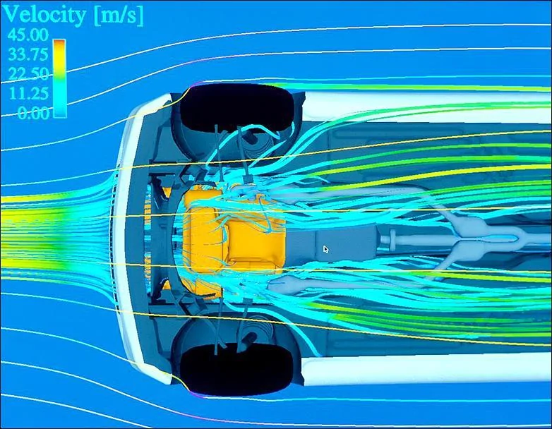

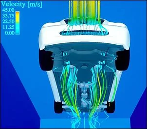

Sigh... first of all. Sales or no sales, it doesn't change my salary.
Second, I'm in the R&D department. So everything I work off has to be logical and backed with data to support my "logical claims".
At part throttle when boost is very minimal it's not at 300F like it would be at 20+psi.
Air comes in through the front grills and gets pulled under the car where the airflow has negative pressure. Standard practice in all car manufacturing.

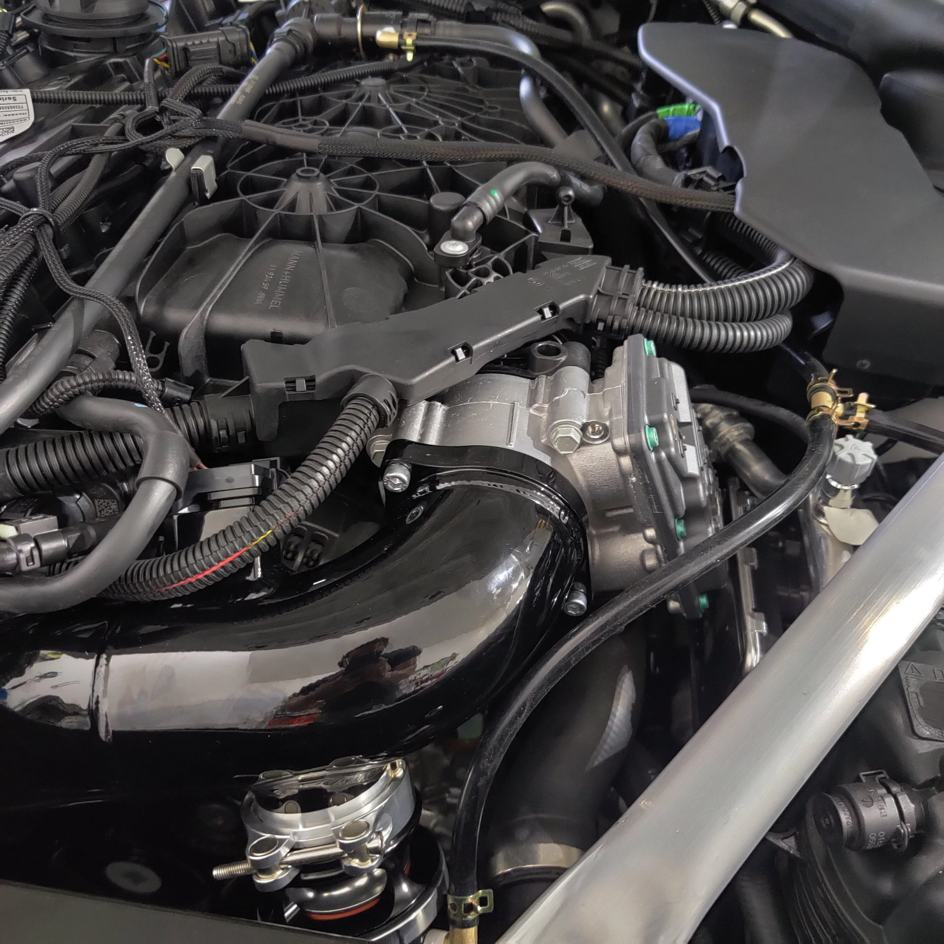

Since I'm not exactly sure how the provided tubing likes being Teed into, I replaced this with some thick wall silicone hose to hook up a mechanical boost gauge.
Parts list needed:
4mm ID silicone hose, 10/11mm OD. Reminder that the BOV run itself is 30 inches, but figure about 8 ft to run the hose up to the A pillar
two 1/8" NPT to 3/16" 90 degree barb fitting
one 3/16" barb tee fitting
I used 10/11mm ID spring clips. Your call if you want to use hose clamps. Need 6 clamps if hooking up boost gauge, 2 without.
Parts list needed:
what I did was get the tee with a female bung 1/8” to run my boost silicone line frommy meth kit with this.
