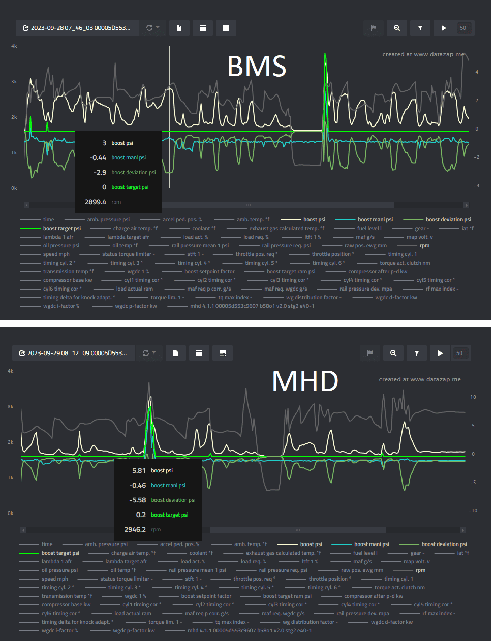

I’ve got some more logs to add to the shared info. I recorded two logs (Cold start and cruising/mixed driving) for both charge pipes (BMS and CTS).

I also have a video of the “hissing” noise present when the BOV opens at part throttle. My turbo is quite loud, as I have a T51R mod, but if you listen closely, you can hear the separate hissing sound of the BOV opening when it shouldn’t be. This has created a noticeable lag down low, and after going back to my CTS charge pipe, I can confirm that my car does feel peppier in the lower RPM range- enough to where I was actually surprised on the first drive after switching back to the CTS charge pipe.

Looking at your logs i'm not really seeing any smoking gun. During your drive with the BMS charge pipe, the ECU requested non-zero boost only 3 times, only one of which was part throttle and the other were WOT. Manifold boost was more than 3 psi off from target. However, the MHD CTS log shows 2-3 psi off target as well during part throttle accelerations when boost target is non-zero.
What's interesting is that i observed what @R8TTEDR mentioned. During steady-speed cruising the BMS log shows boost deviations that are much smaller in magnitude than the CTS. The deepest valley is -3 psi for BMS. Meanwhile the MHD CTS has multiple boost error excursions to -5 psi. Use the scale on the right for boost error.
Could you do a few more mid-throttle logs?
