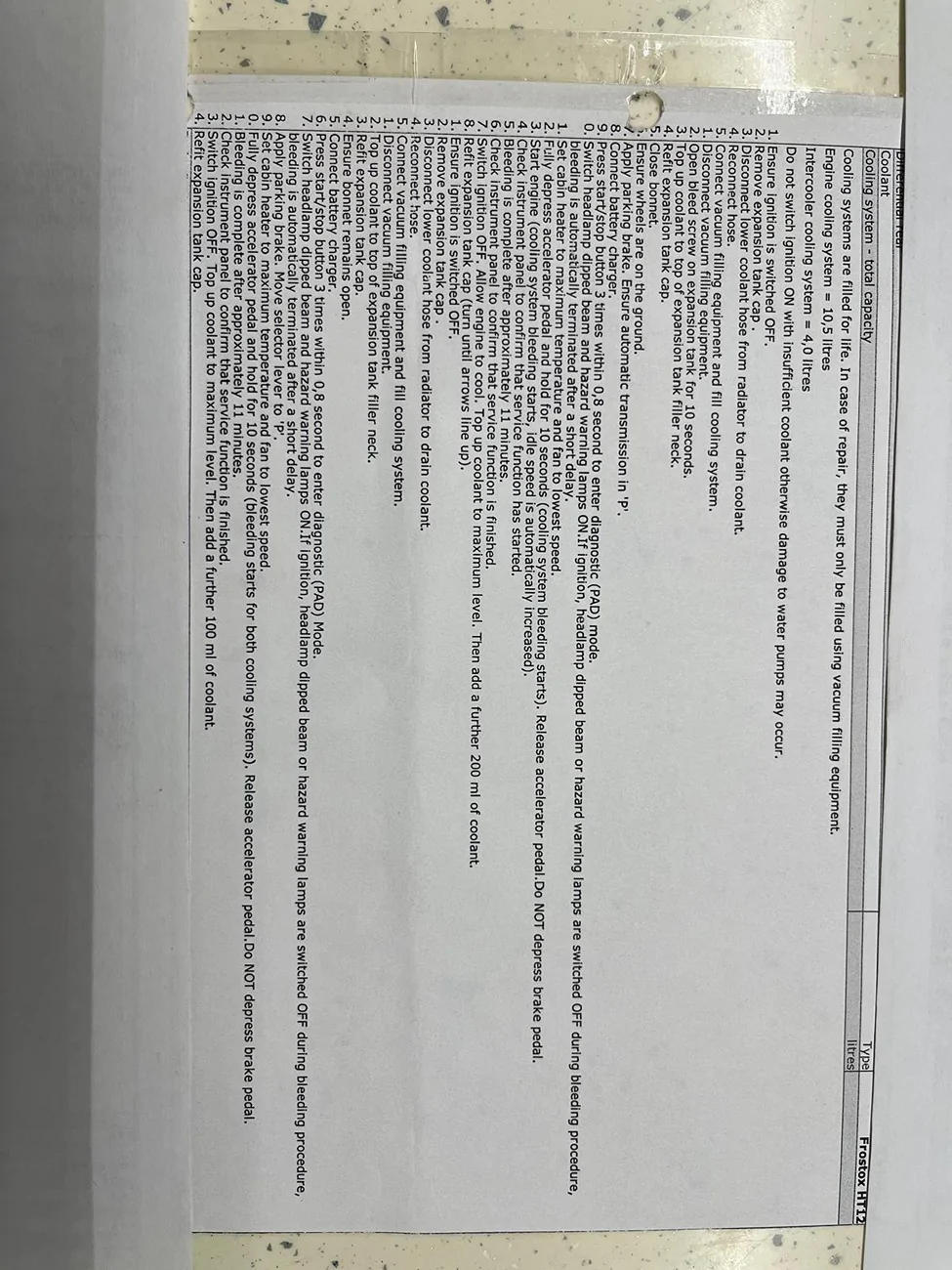

Hello. You need HT-12 in both tanks. You see that the procedure for bleeding the cooling circuit is very complicated and you have to do it because you don't know if the previous owner did what was right, he probably didn't if he didn't put HT-12 there too. I'll send you the procedure.

If there is water, remove it from the container with a hose and add concentrated HT12 until you reach a concentration of -30 degrees, if not, untie a hose somewhere but you still won't be able to drain it all, so you will still have to measure the concentration with a tester.
