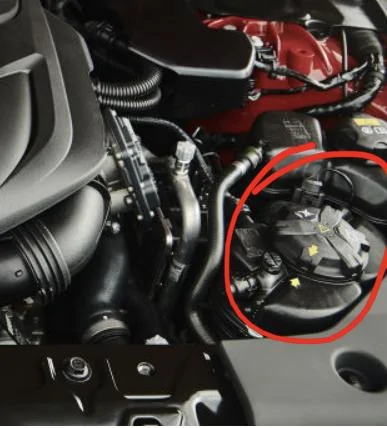

I have a 21 supra and have a low coolant warning light(top off) question is how can check don't see any clear overflow tank like normal cars have..temp seems to be fine.

Open this cap and look inside. From there you can see the coolant level since it has a little gauge that says the max amount you can add.

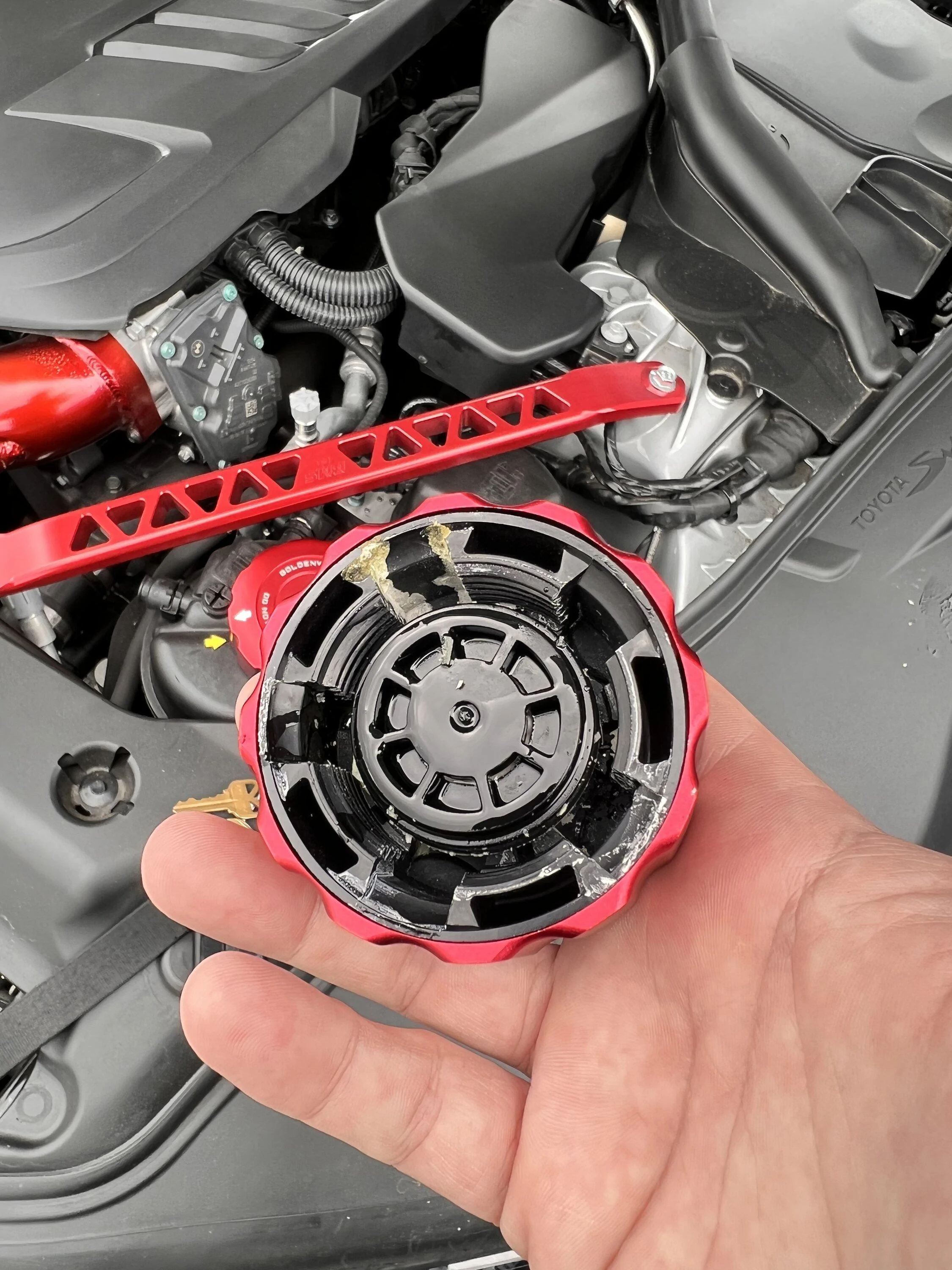

Check to see if your cap shows any dried coolant residue on it. These caps are common to warp or not fully seat and cause just the slightest imperfect seal and the coolant will evaporate. I replaced both my caps.
