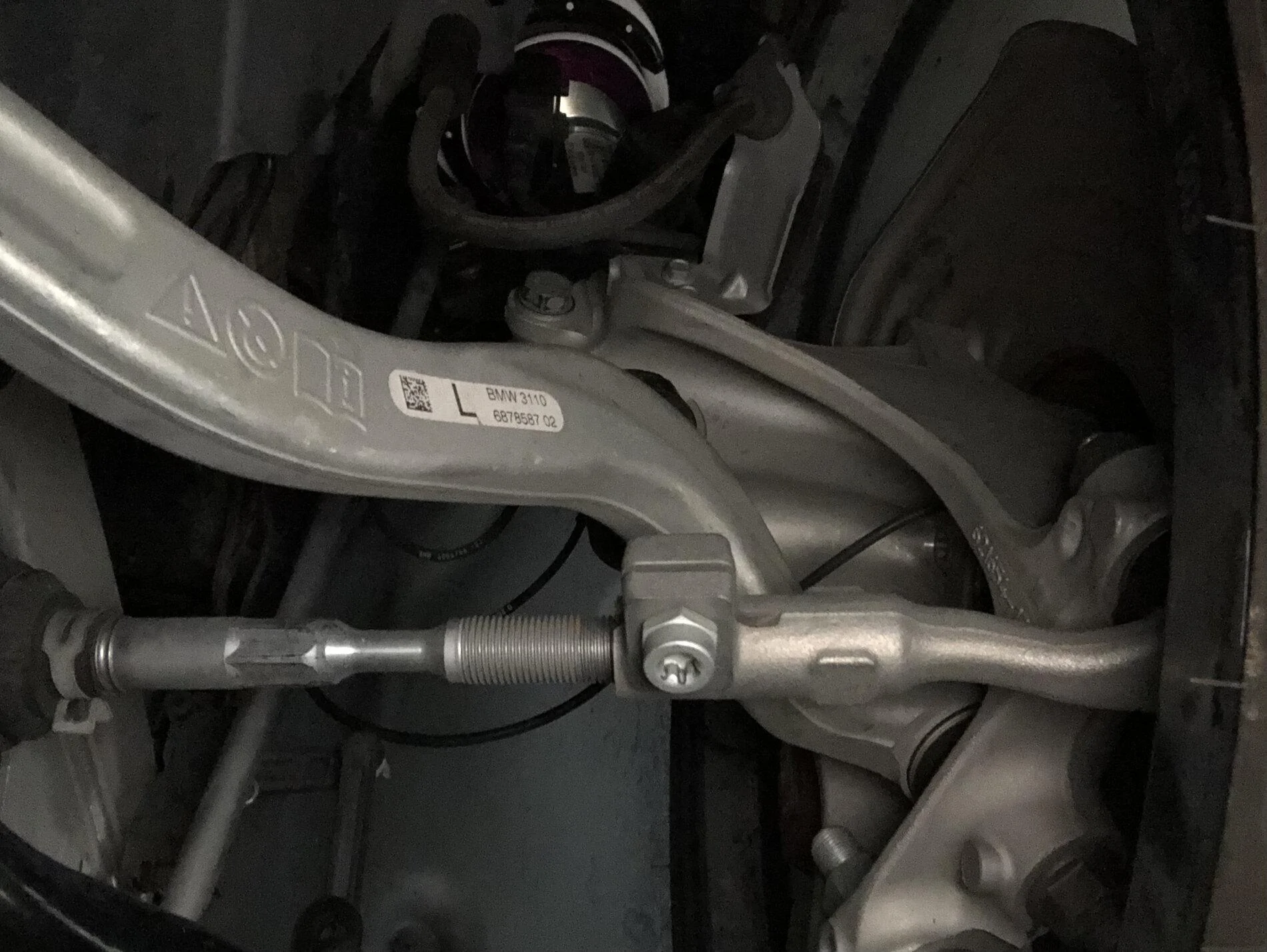

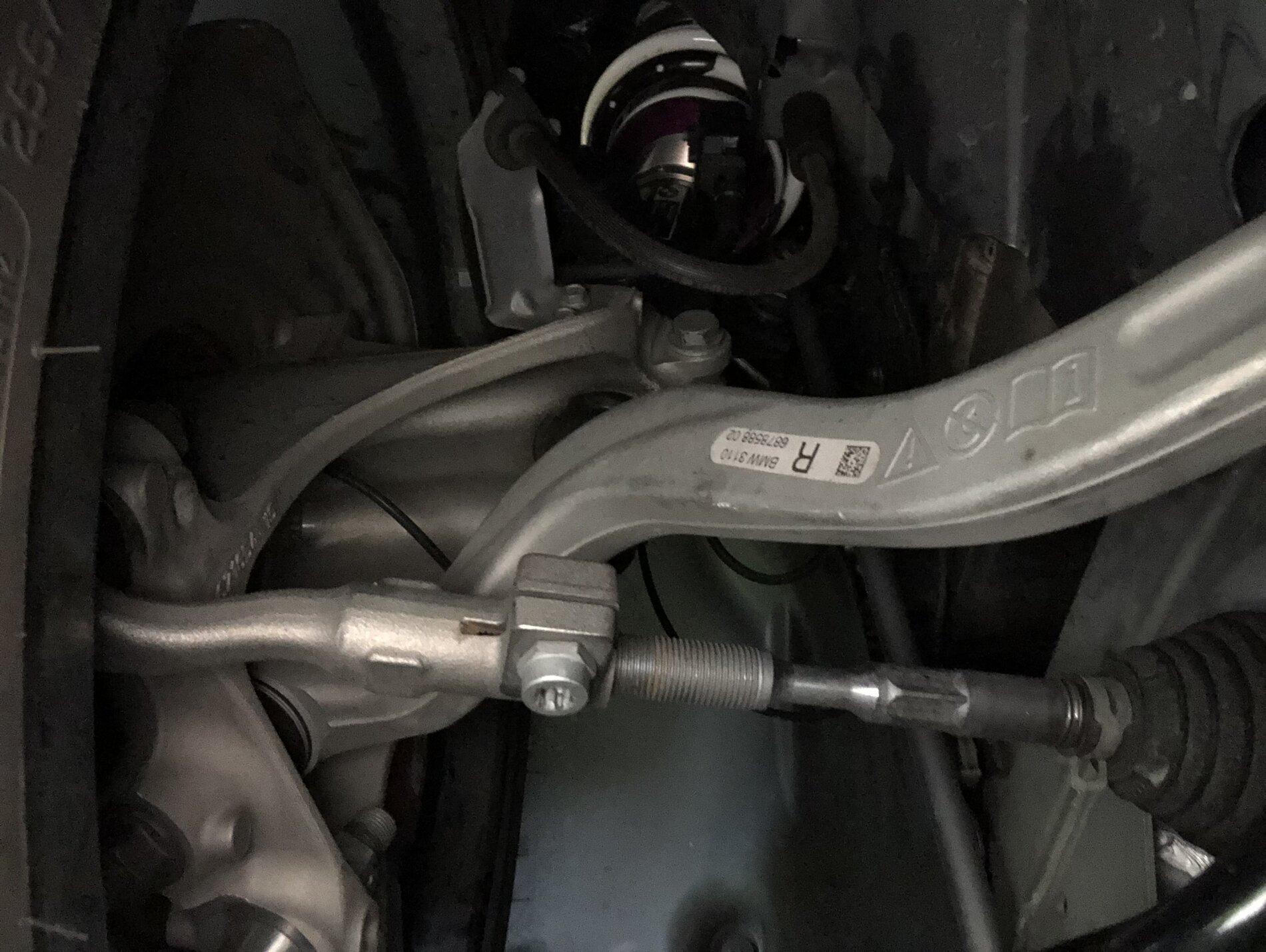

Check your steering tie rods. I've seen these bend quite easily and will definitely cause a crooked steering wheel.
OneTimeAccount
OneTimeAccount
Jun 23, 2021
335
255
2021 Supra 3.0 Premium - Turbulance Gray
Thanks! This is the kind of advice I was looking for. I know the alignment could be thrown off after a very unforgiving track day but wasn’t sure what I should be looking for, and what would cause the alignment to go off.
Hopefully it isn’t bent, though lol.
OneTimeAccount
OneTimeAccount
Jun 23, 2021
335
255
Looks fine to me ?
