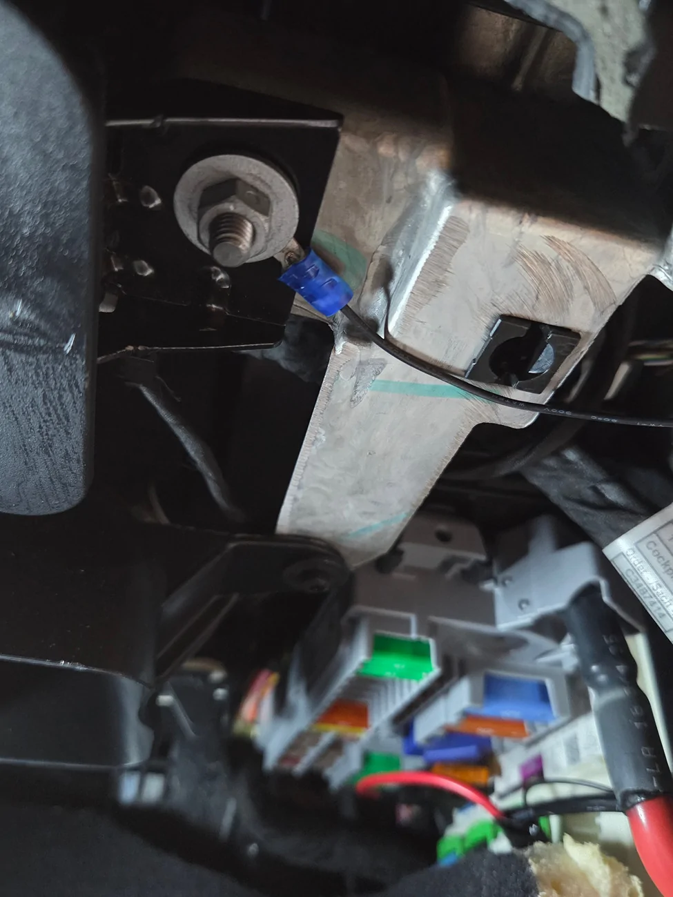

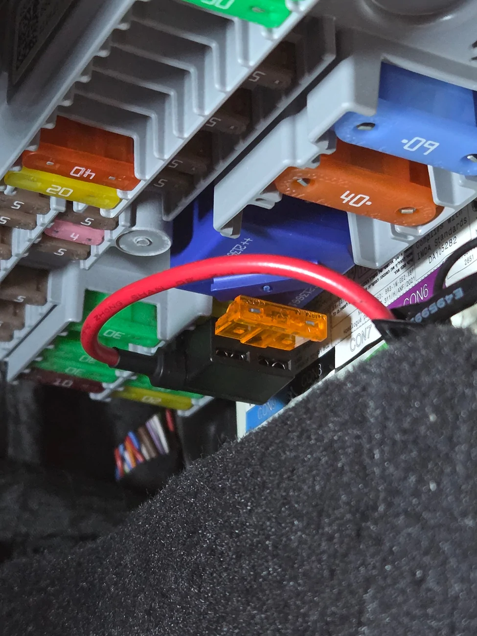

My dash cam came with a USB A to mini USB cable. I cut off the USB A end and spliced the red and black wire. Red went to the fuse tap and black to ground. Fuse tap is in F47. The fuse tap has a 5amp fuse. I'm using a ground location I saw mentioned in a few other posts.

Moving the fuse from the top to bottom of the tap (another post said it might matter which one is used)
Added another 5 amp fuse so both fuse slots in the tap had 5amp fuses (another post said this might matter)

Adding a washer between the plastic and ground connector

Bump and updates. I checked the fuse tap with a multi-meter. The style I have does need both top and bottom fuses installed to work. So with them in I am seeing power in ACC mode. All the grounds I'm using are fine too.
So I guess it comes down to my camera (which works fine plugged into a normal usb port). It must need some sort of converter.

The Viofo kit I used didn't end up working. I picked another random kit and that one worked fine.
The fuse tap still needed both fuses in place.
