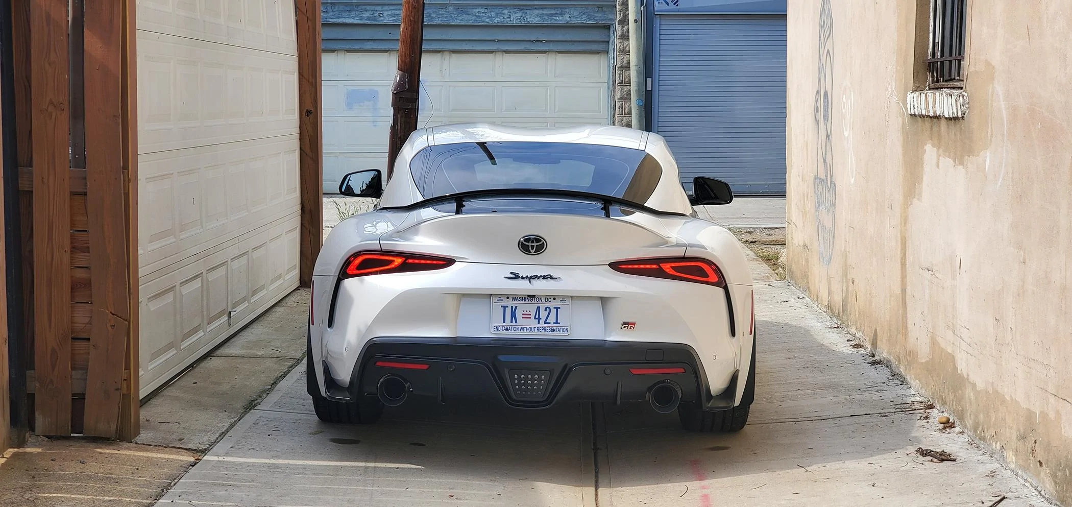

I installed this exhaust a couple weeks ago myself. For what it's worth, mine aligned just right first try. I was actually surprised I didn't need to make any adjustments. I left all the joints loose as I installed them, and pretty much just tightened them down as-is.
