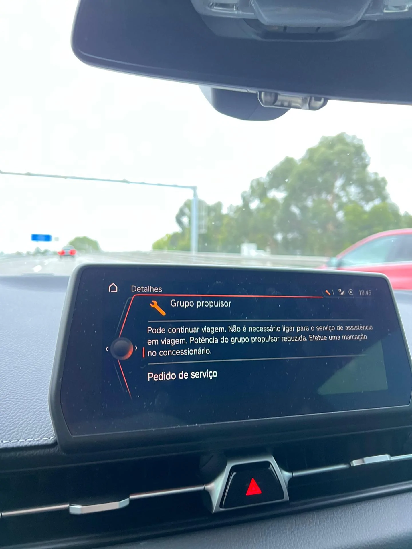

hi guys, hope someone can help me on this, yesterday i installed a catless downpipe on my Supra, and today after flashing it with MHD, the car keeps going on safe mode with the "Drivetrain Malfunction" Error. I already canceled the Downpipe error on the MHD tune...
Btw its a European Car, dont know if it makes diference....
And the downpipe if from Whifbitz bought from R44 Performance

Pulling the code would be the best idea. I'm MHD tuned and have been for a while now. Which tune did you flash, and what fuel are you running? The only Drivetrain malfunctions I ever got with MHD was when I was running the OTS Ethanol map. Every time I would go WOT, it would throw a Drivetrain malfunction every time it got close to red line. The fix was to get a custom tune, haven't had the issue a single time since.
