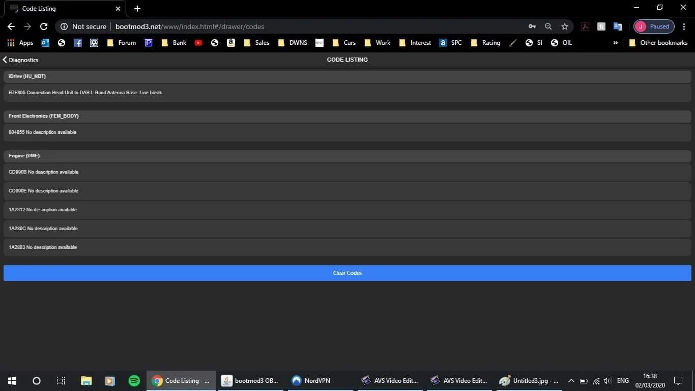

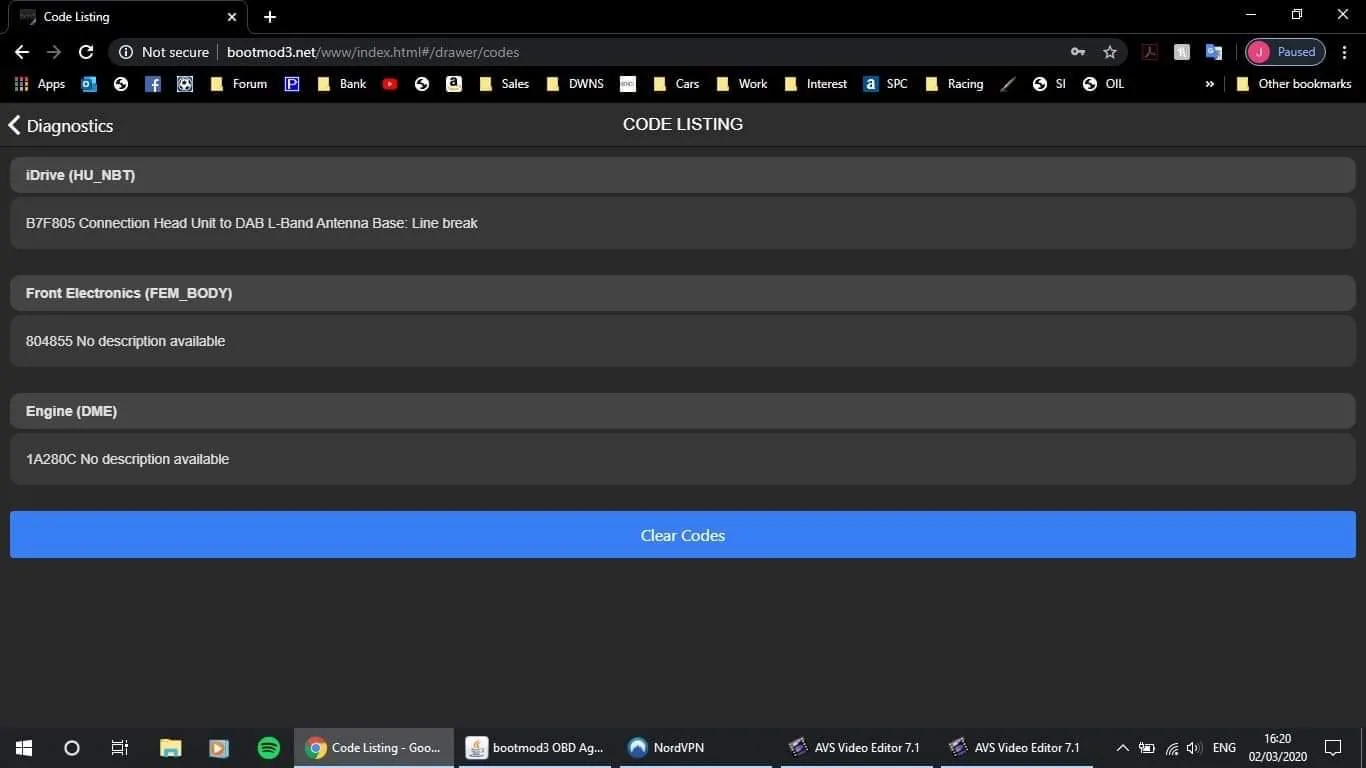

These are the codes after first flash and drive:
These are the codes tha stayed even after clearing:
And these are the codes again after stock flash, stage 2 reflash and drive:
Thanks,
Josh
@J_Orr we've received your ticket, responded with code descriptions. Tuners are reviewing and will be in touch soon. All the best.

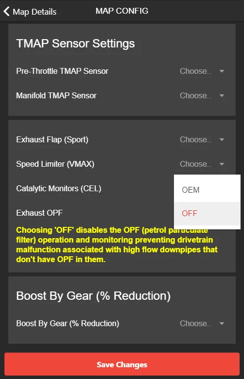

I think it might be that the OPF sensor hasn't been turned off. I was advised just to block it, but by the sounds of your reply it needs to be open to atmosphere and turned off on tune?
If you removed OPF then yep, you'll need to go into the map configuration screen and select OFF under the OPF selection and reflash. That will sort that issue. See screenshot attached.
