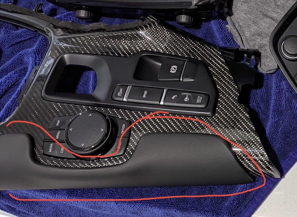

Does anyone know how easy these are to remove/take off?

Can you share a link to that diagram? Thanks
When you take the carbon fibre centre piece off you can take that fake leather/rubber piece off from behind.

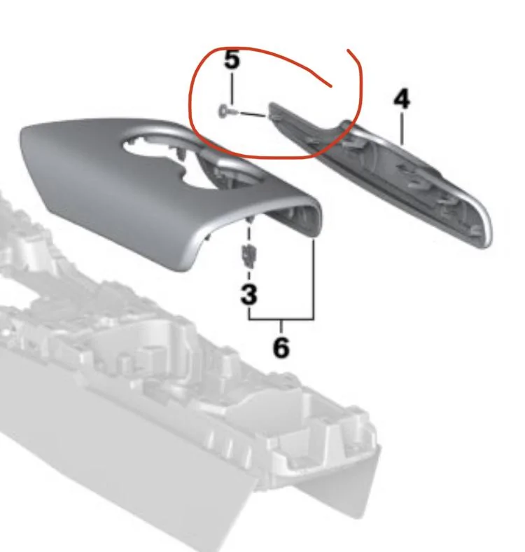

Could anyone advise if the passenger side knee pad also pulls right off? Borrowing @dazza’s pic, I’m referring to the below
from the Realoem diagram captures, it appears to be attached by a bolt/screw... if so, it’s attached to the carbon fiber trim?
Yes there are screws behind the carbon piece. I would suggest wrapping the gear lever in Tape or plastic film as it can get scratched when the carbon trip is pulled up.
Also note that there are 2-3 connectors that need to be unplugged so when you lift the carbon piece just gently unplug the connectors.
