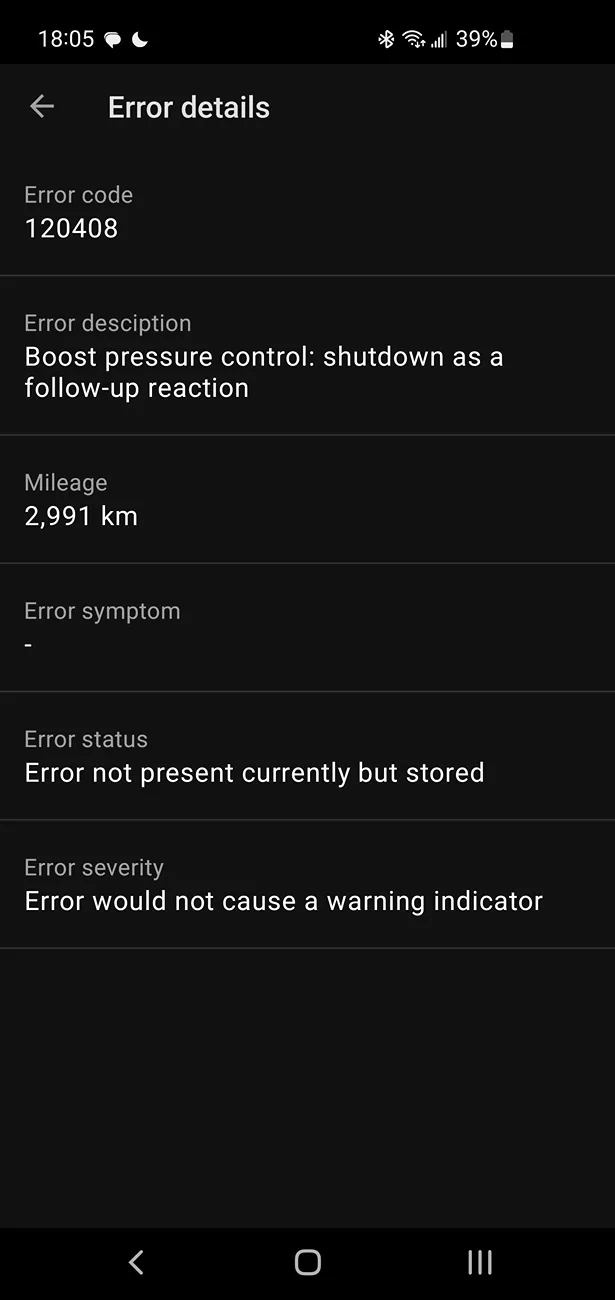

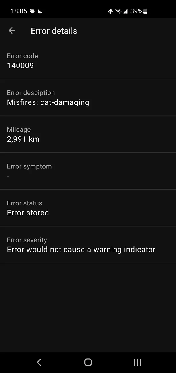

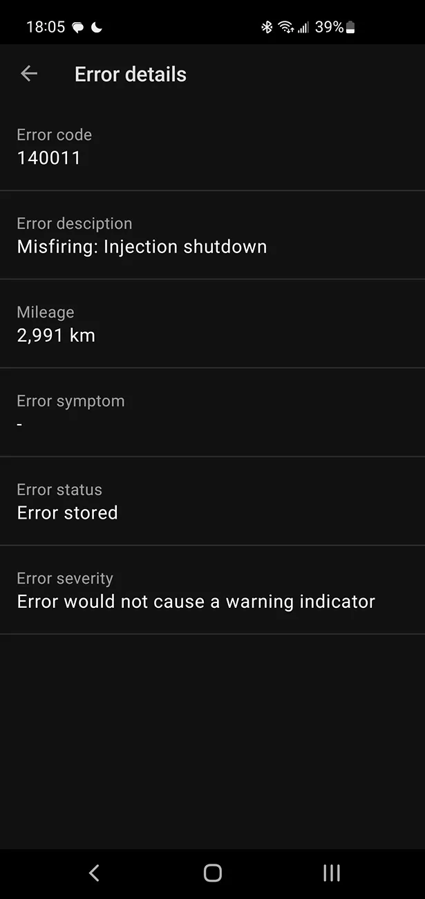

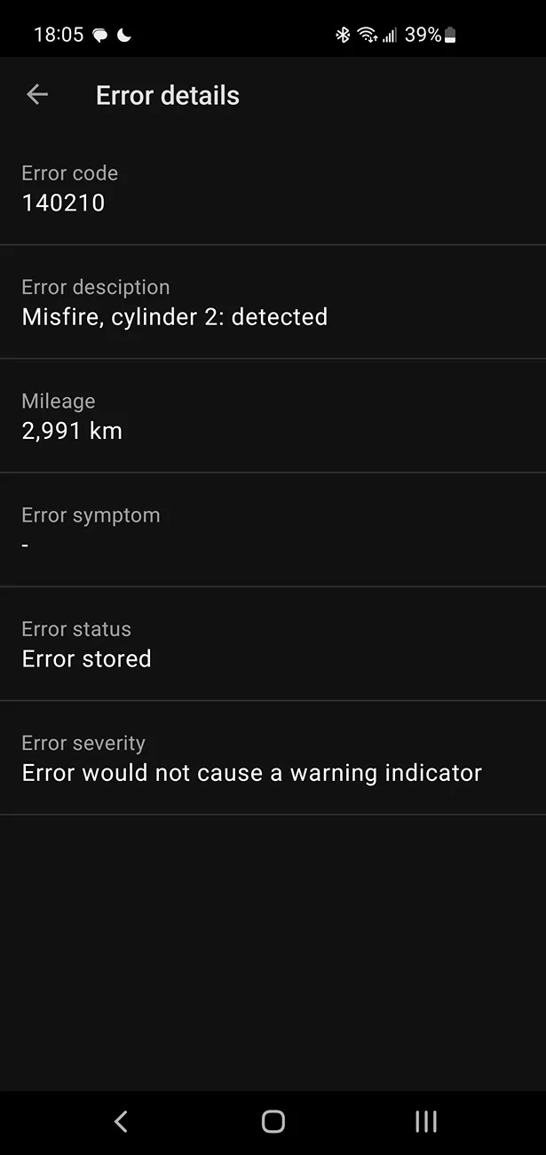

Brand new 2026 MT purchased 2 months ago. Driving home yesterday the car threw a drivetrain malfunction and went into limp mode. Pulled off and restarted the car, message went away and drove home fine.
Pulled the codes with Bimmerlink today and found some misfire codes which I believe may have caused the drivetrain malfunction.
Anyone experience something like this? Looking to get some opinions before taking it to a shop. Car is bone stock with ~1,800 miles

100% take it to the shop, it's under warranty. If it's a bigger problem than just the injector, coil pack, or spark plug, you definitely don't want to pay for it. Not that you want to pay for any of that anyways...
You're running 91 Octane, right? Under what conditions did the car throw the codes in? Redline? During a pull? Standard driving?
Details will be in ISTA, shop will be able to investigate, but still would be interested to know.

93 octane. It happened during regular highway cruising

Dealer swapped some plugs and coils around to see if it happens again in the same or a different cylinder. Hasn't happened again so far, but I've only driven the car maybe 100 miles. Snowy season in MD, so I haven't been able to drive much.
I'm thinking about maybe changing all the spark plugs myself soon since I've heard the ones from factory can be pretty trash. Other than that, no real solid answer.
