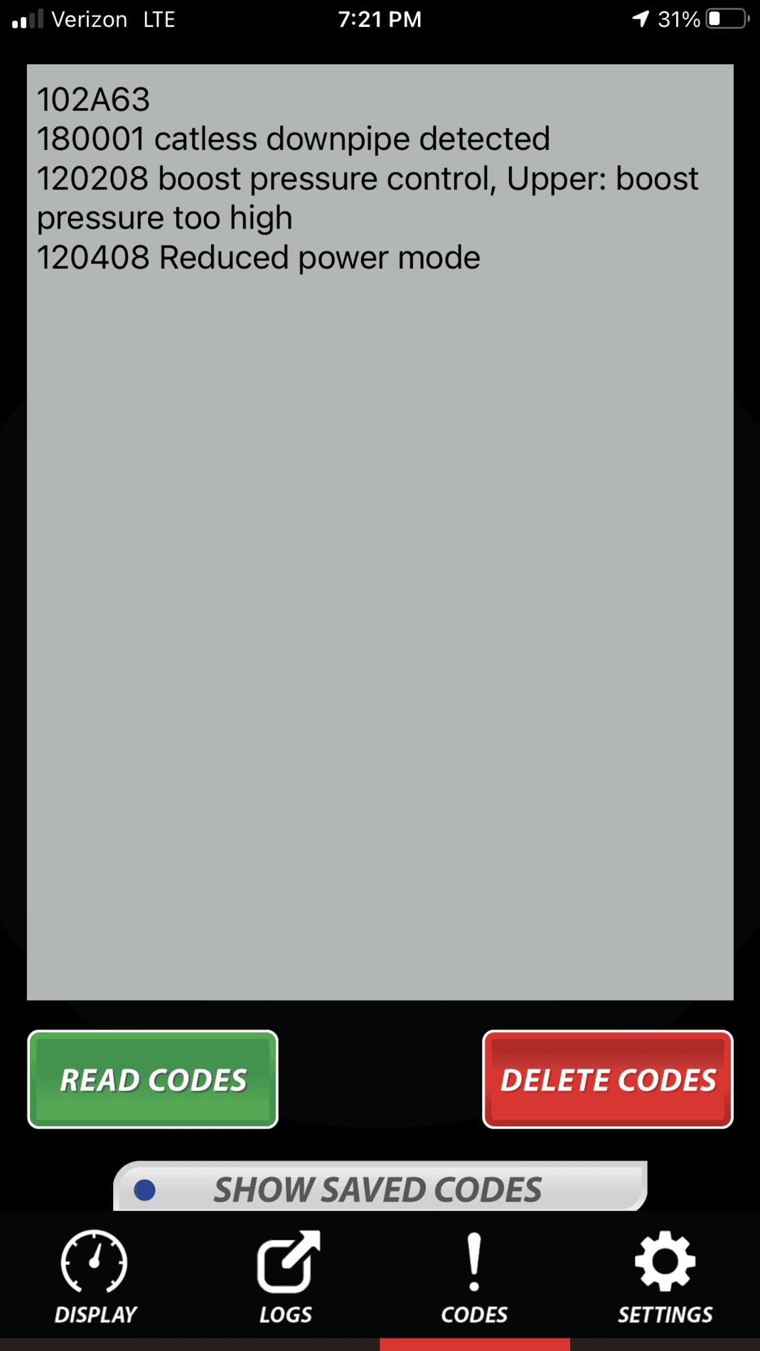

I was doing a pull a couple nights ago and the same “drivetrain malfunction” occurred around 150. The thing is I was on map 0 the entire time, i just had the jb4 on for parameters. Yesterday I took the air box off and checked if anything was out of place and found nothing loose. This is the code it read. It didn’t go away until I cleared the code last night, so far it hasn’t come back.
edit: I don’t think this because of the JB4 anymore. I believe it’s because I have a downpipe with no tune.

this 100% due to JB4+catless without custom tuning for being catless.
Car stock flash (even on JB4) thinks a certain amount of WGDC needed to hit a boost target based on OEM DP backpressure.
WGDC - how much exhaust directed thru the turbine compared to around it
As you can imagine, being catless does not require nearly as much exhaust through the turbine to achieve the same charge pressure. So you can put together how this causes overboosting when stock WGDC targets are used.
JB4 with EWG control can tune this out by intercepting/modifiying WGDC targets lower and not have any limp mode issues.
