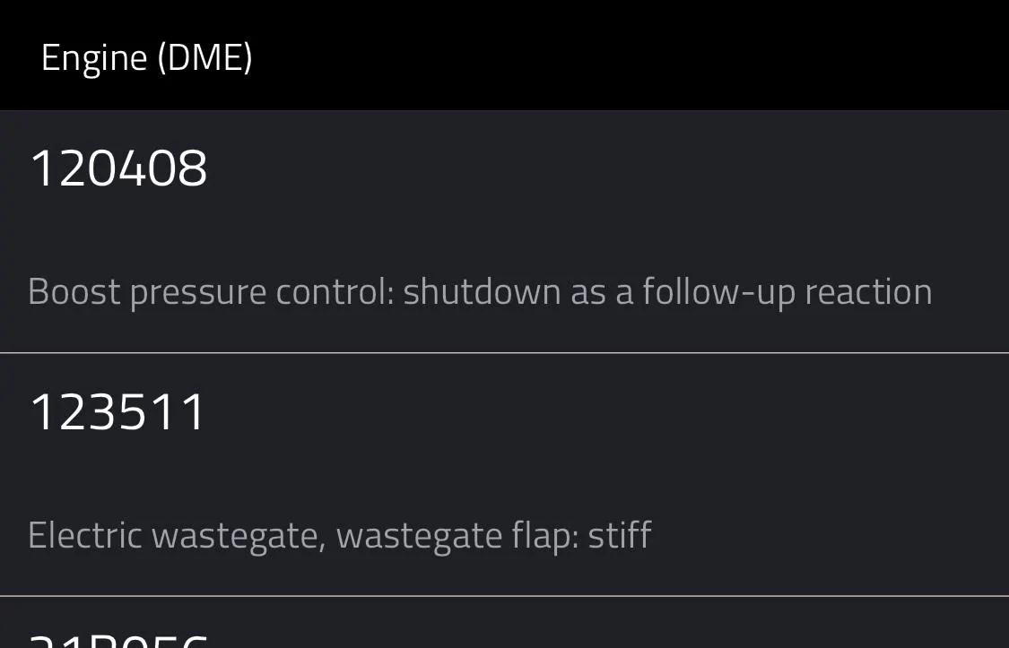

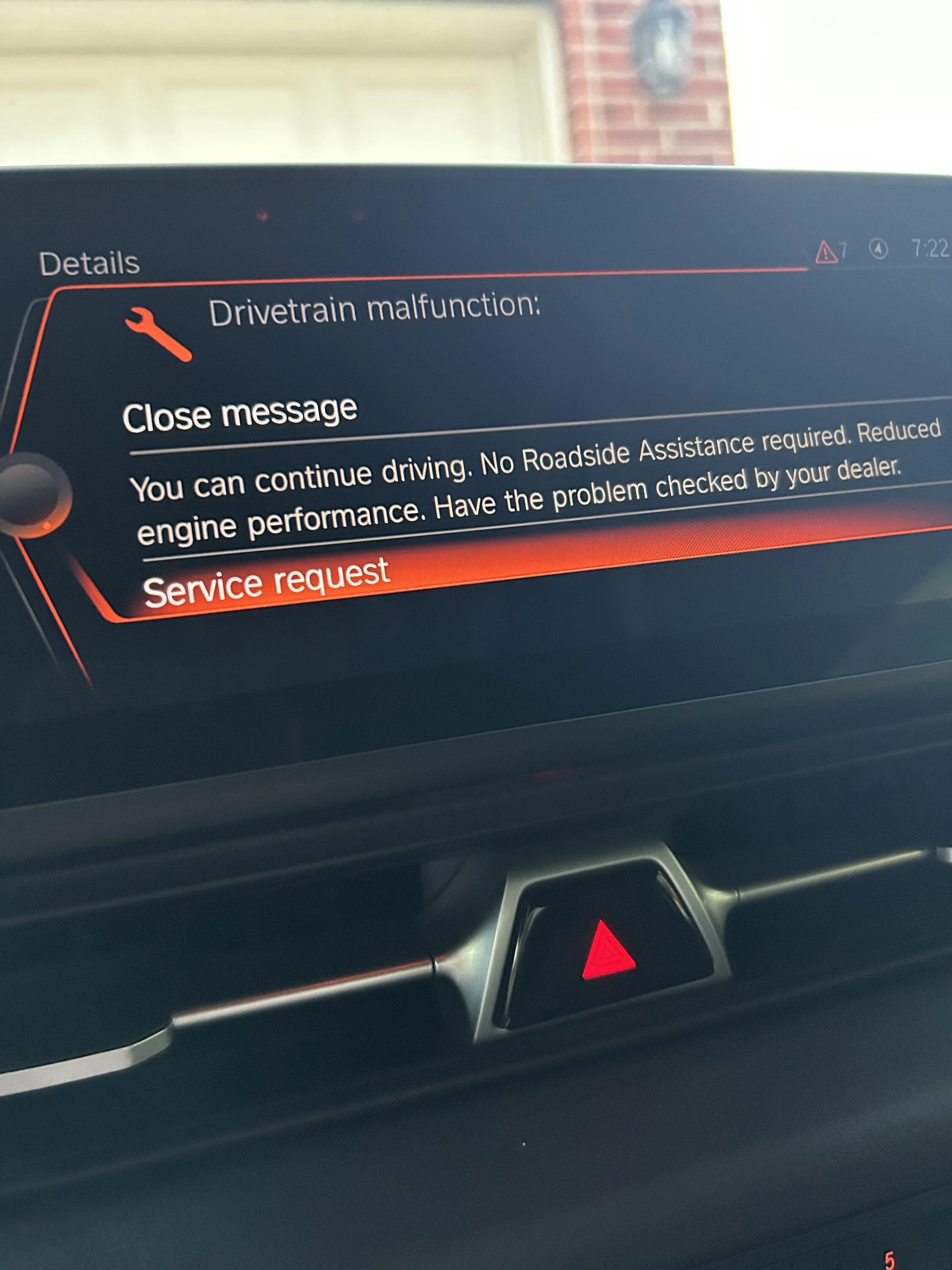

So, have been just recently getting a Drivetrain malf. error. Scanned the car with bm3 and these are the codes popping up. Any ideas on what it could be? For context, car is a 2020 with about 30k miles, tuned with bm3, catless dp, and a pure 800 thats been on for about 2800 miles.
When i clear the codes, they stay off for about 20-30 minutes of driving and eventually come back on, putting the car in what i assume is a limp mode.

Oh wow, those codes makes you think the wastegate or actuator is getting stuck. Maybe have a peek at the WG actuator and linkage to make sure all looks ok.

Did you get it figured out? Has your car ever been on a dyno, or do you know?

Haven't gotten to try the WG calibration yet. Will probably do it this weekend. Car has never been on a dyno, no. The only thing that has changed "recently" with the car was the Pure 800 install, but that was again almost 3k miles ago, so dont see why the WG would be giving issues now.

I just had this fault on the drivetrain error and limp mode.... strangely never happened until I collected the car from the dealer for the first oil change and drove about 20 miles. Next morning the error came up (on cold start and driving), car went into limp mode. I pulled over and stop/started the car, problem went away and she accelerated normally/boosted well.
Only thing I can guess is they did a software update and the car is "relearning"?? I have an air intake and cat back exhaust. No tune yet. 2023 3.0 manual.
Its happened twice, both on cold start in the mornings, and not again all day with normal use.
Im going to try and replicate the fault in the morning and have Bimmerlink connected. If it happened again on cold start, Ill drive it back to the dealers, as this didn't happened before they did the "first service and inspection:"
