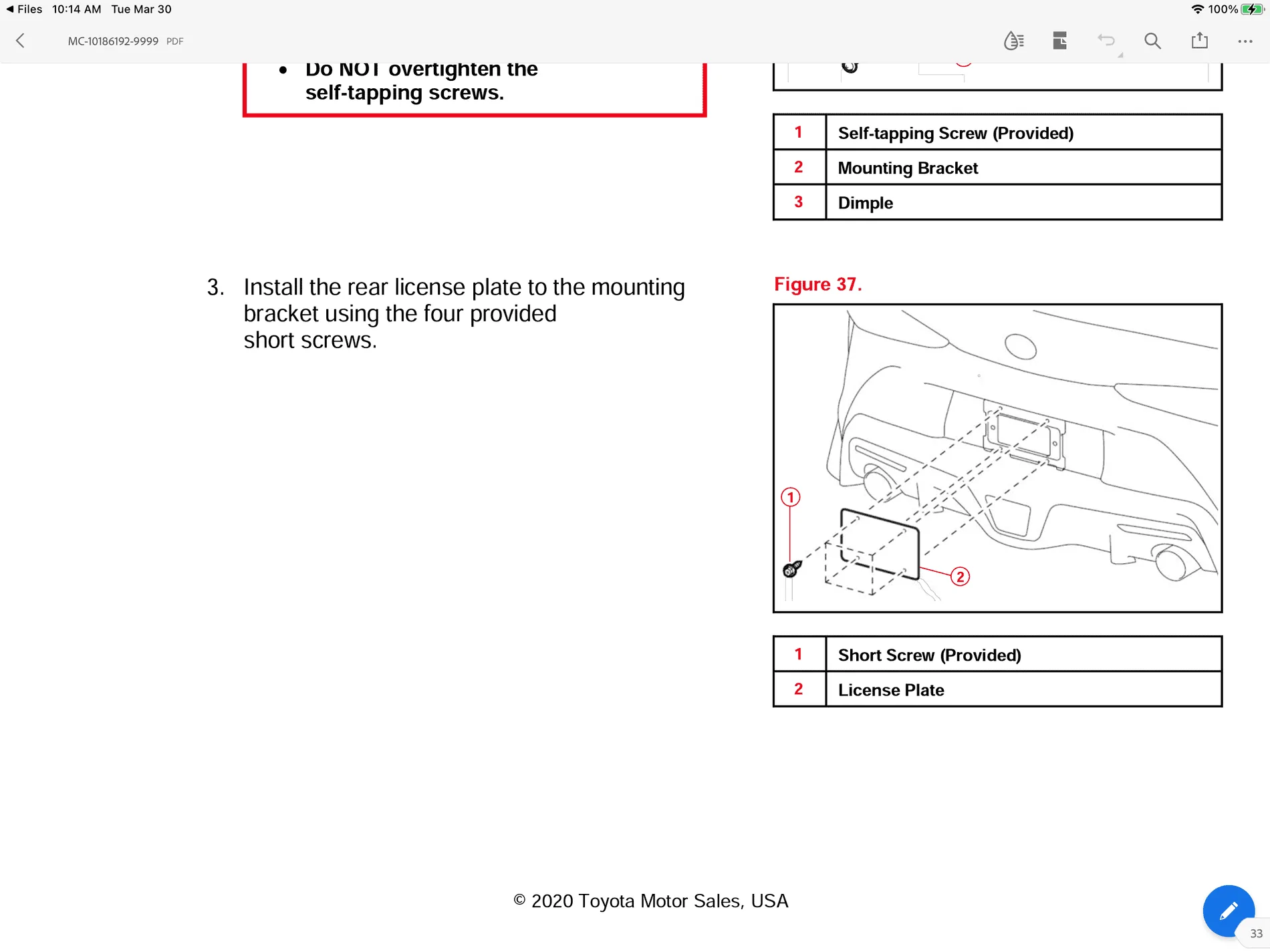

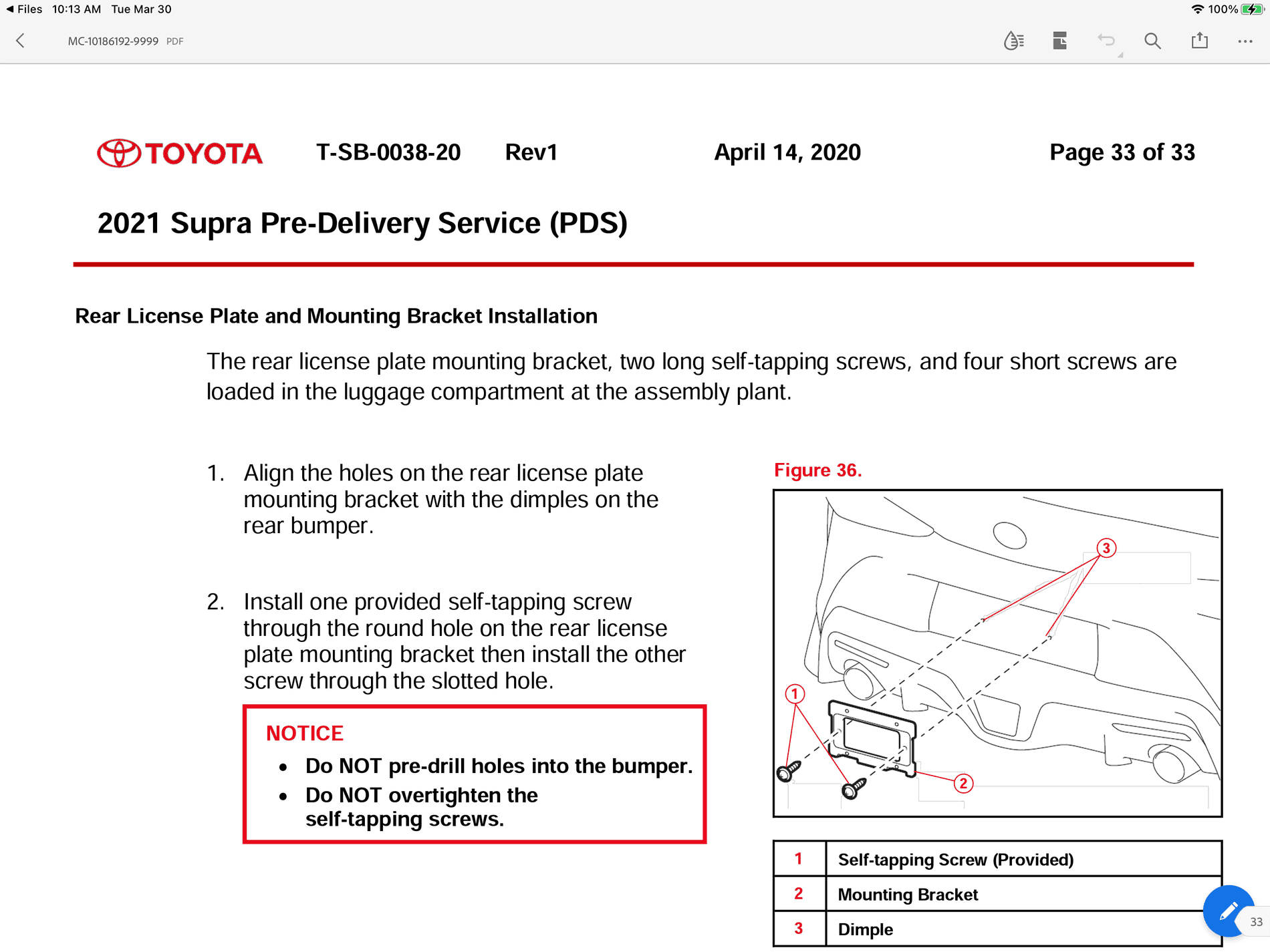

My rear plate holder mounting bracket is metal (6/20 production date) and it has plastic cage nut-like inserts for the self taping screws used to attach the plate. The bracket itself mounts to the rear plastic body panel via a threaded insert and machine screws. Sometimes that bracket gets installed upside down during PDI and then there is literally no clearance for a license plate frame (or a regular plate is resting on the diffuser to scratch it). I had to flip mine around in order to use the thin framed stainless plate holder. And yes it was a PITA to find the right length replacement screws at Ace Hardware.

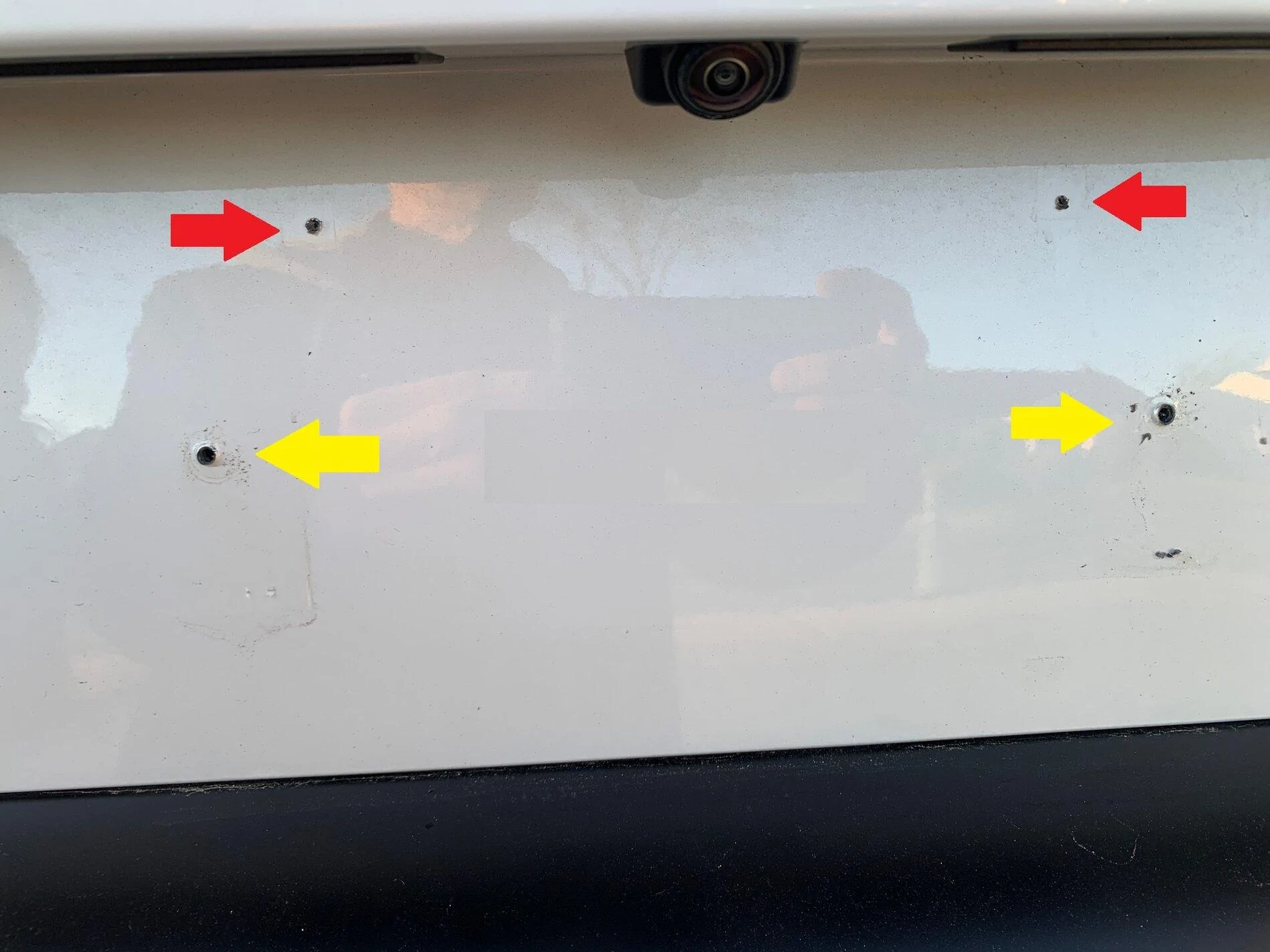

This one was plastic (same as my 2020 BMW)- I'm surprised yours is metal. Wonder if they changed that for 2021?
Can you confirm which way is right side up? The plate was resting on the diffuser (luckily it wasn't scratched) so I wonder if it was upside-down?
I took out the 3/4" screws out of the plate and they penetrated the back (red arrows in pic).
The yellow arrows are where they screwed in the plate holder. My BMW has the threaded inserts you noted but this is just screwed directly to the panel. Not to mention additional scratches. Are the threaded inserts not part of 2021 builds?
What a mess - we are never going back to that dealer for anything.
Not much we can do and thankfully it's covered by the plate but it is a shame they drilled 4 holes into a brand new car. I should have known to tell them not to mount the plate so I sort of blame myself. At least I told them not to mount the front plate.
When I took delivery of my BMW, I transferred plates so I did it myself but that dealership was far superior to this one.

I cant remember if the “tab” is on the top or on the bottom of the frame. I fiddled with my plate bracket until it had enough clearance on the bottom for the plate frame. Here are the install instructions from the Yota PDI checklist. It appears that they do drill holes for the mounting bracket, so I can’t explain why mine had threaded fastener inserts like your BMW. Maybe a running change. As for the extra holes you have, the screws my dealer used were not long and did not contact the rear panel. I did get a bag of fasteners and the front bracket, so maybe the PDI tech just grabbed the wrong ones. Maybe put a piece of electric tape over the extra holes to prevent water from getting in there.
looks like you had a dealer who cared. Thanks for the instructions!
