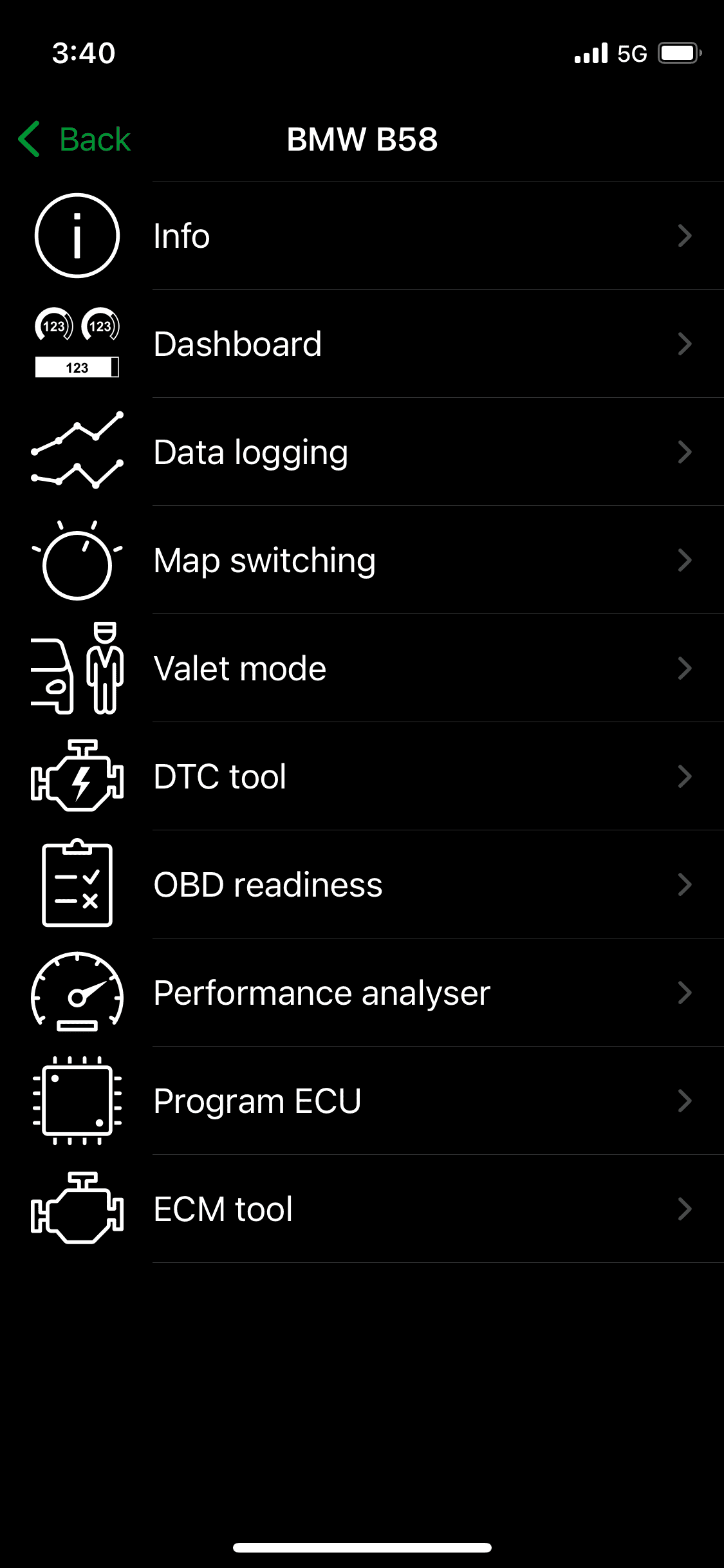

I recently got my 2020 Supra unlocked and tuned, and was just wondering how you guys have your app dashboard setup? What are some good parameters to have on there?

Semi-related. I think I paid for RaceROM but cannot figure out where the slider is for the burbles and other things. Haven’t heard back from tuner yet, any insight in the interim? Or is that not in the app and only controlled via laptop?

'Custom Inputs'
