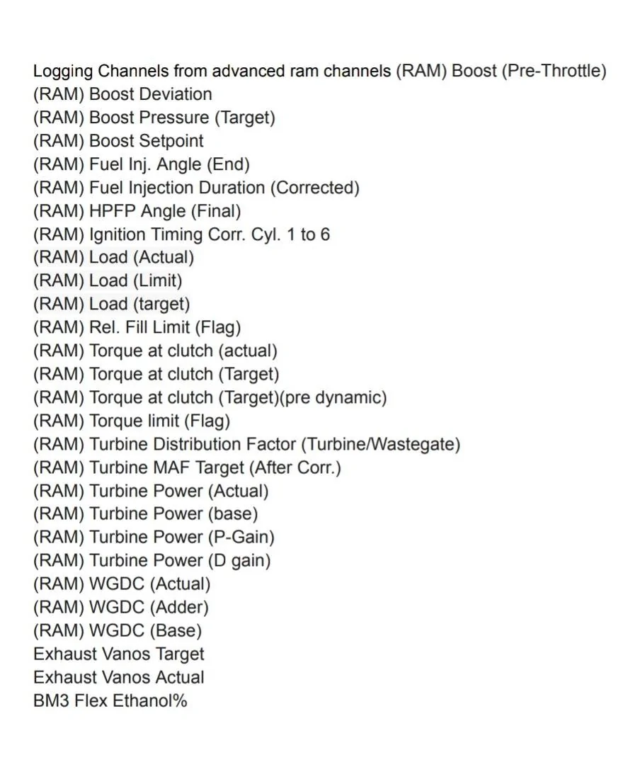

Currently being tuned with BM3 by Sameh and first datalog went normal and he gave me my second map as well as more options to enable within BM3 datalog settings. Only issue is that after enabling these settings, the gauges stay at 0 and I cannot datalog anymore. Almost as if the app freezes.
During this, I checked if I could use custom-rom for live adjustment, checked to see if my connection was still green, and yes it all still works. Anyone had this issue before? Image of the settings he told me to enable in advanced datalog included

Yes, this happens when the actual item isn't using the right address for the ROM ID. I have this issue with my Supra. I cannot log Vanos, it freezes the app. I have tried to get support to fix it but they keep giving me the run around and saying they are putting all their effort into Rev2 that will probably never come out.

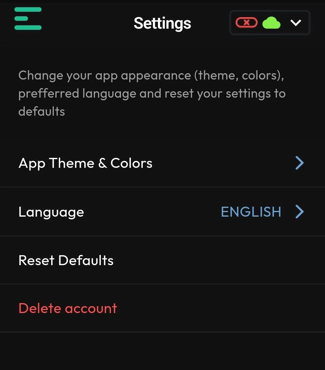

This happened to me. I went in under settings and pushed the reset defaults.

Its annoying having to reconfigure all the channels again. Reset to defaults fixed it for me.
