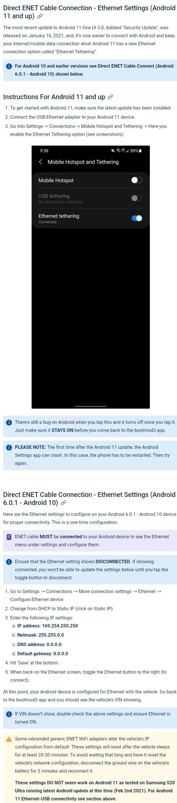

Did you enable Ethernet tethering on the phone? This must be toggled ON in Android's "Hotspot & Tethering" menu before USB-C Ethernet will function.

Ethernet tethering was greyed out and it wouldn't allow me to select it
You may have to reconnect the USB-C adapter after the enet cable is plugged into the car before that toggle is active.
Also, not all USB-C Ethernet adapters are supported by every phone. I had to switch to a UGREEN-brand adapter with an Ethernet chip supported by my phone (Atheros chip), as other Ethernet chips in other adapters did not work.

This is an Android thing, not BM3. Android devices are really finicky with Ethernet over USB
Specifically: Android has good support for Broadcom-Atheros chips, and not much support for Realtek chipsets. So it's important to select the right ethernet adapter to ensure there's a driver in the OS kernel.

I believe the BM3 guide mentions that it's not possible, or nearly impossible, thru Android to do so. I had S20 and S22 and never got it working despite assigning static ip, etc.. Dev settings, etc.. always on..... C to eth works for sure. Used it for other purposes but not bm3. Though, this was perhaps 6-9mo ago. Apps may have been updated, so still try the above Amz link ..

BM3 worked just fine for me on Android with Ethernet. It is absolutely possible. You just need the right Ethernet adapter, and don't plug it into the phone until the enet cable is in the car. Toggle Ethernet tethering to ON on the OS and off you go.
