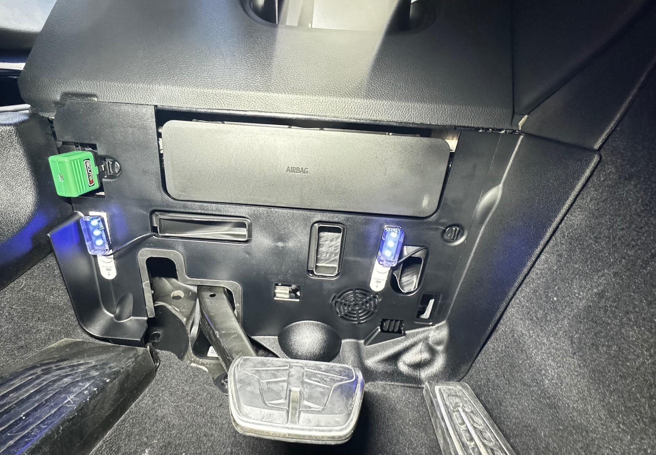

Can you send me a picture where that speaker is at ? I’m having the same issue on my car

Anyone have a picture od the location for this siren? Or a way to code out/deactivate the emergency call warnings? Thanks

It’s the kick panel above the pedals on the drivers side. I’ll try and get a picture since I’ve been asked in PM’s also.
Edit: here is the picture of the panel. The “speaker/siren” is under that circular grill just to the top right of the brake pedal.
