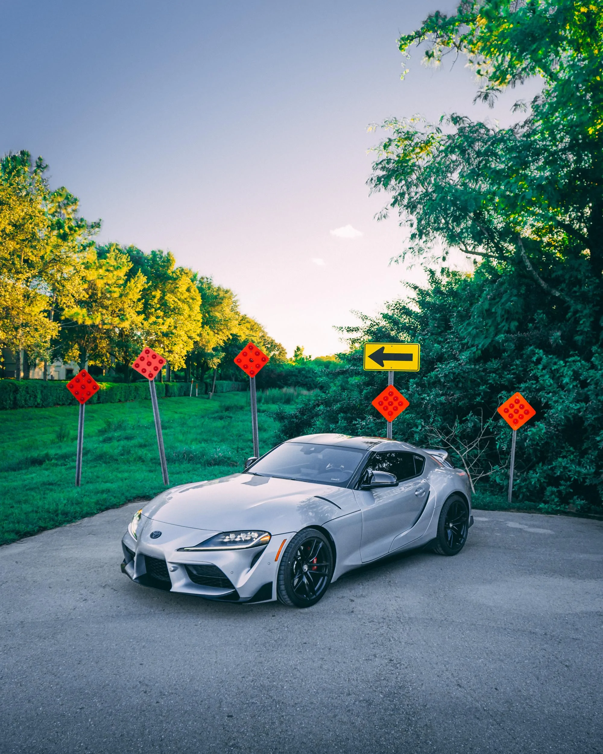

Haha that sounds great man. Any chance you could possibly get a video of you doing some pulls or drive bys? Have you noticed any difference in the overall powerband curve since installing the dp?
Also gotta say I love your current setup as we have the same color and I am trying to get some black rims as well. Which rims are those?

They are the stock ones powder coated black! Here is another photo (13mm front spacer, 15mm rear):

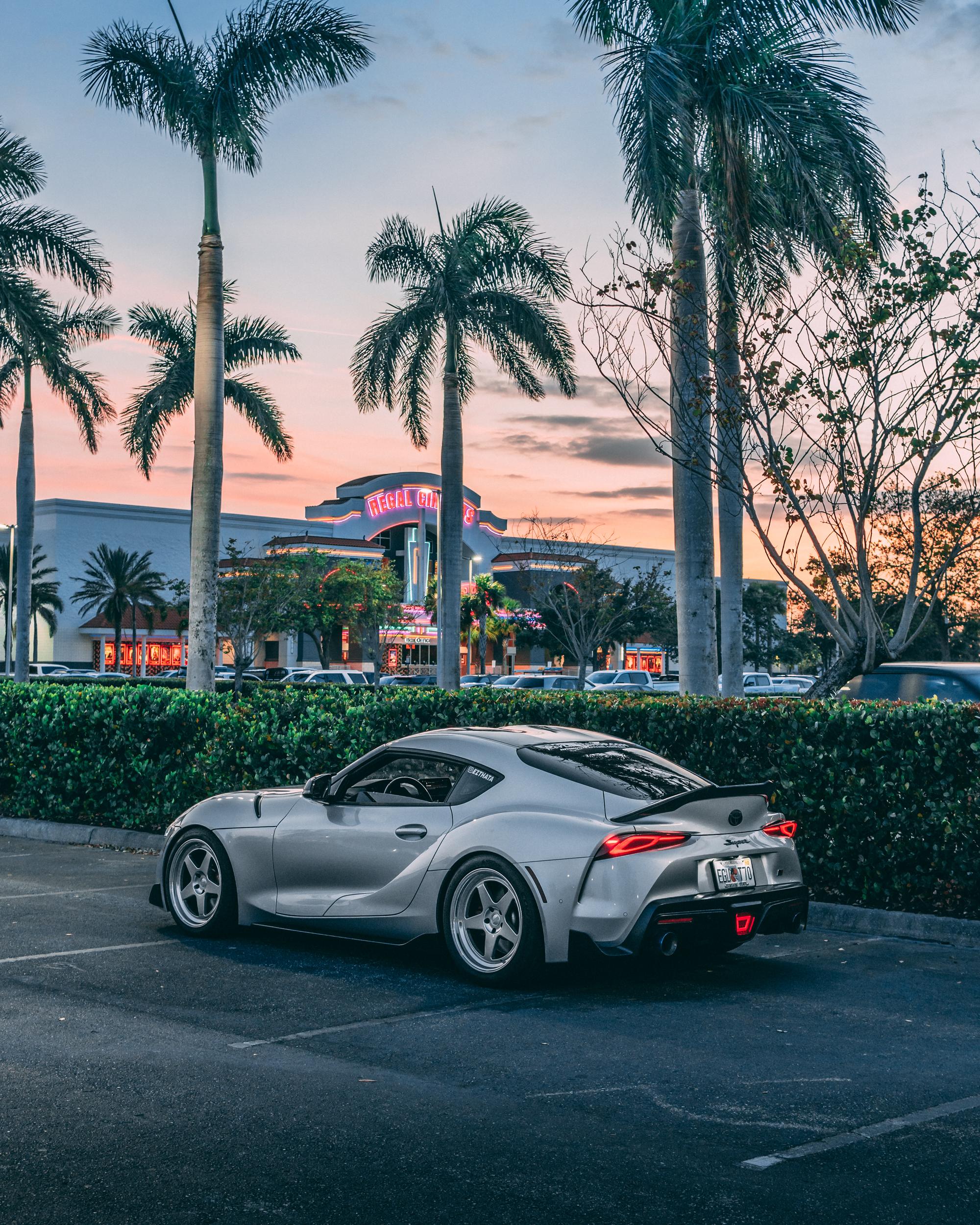

Believe it or not, I just got new wheels and coilovers installed. I went with the Kansei KNP's, they are a good price.
Wow that looks so clean good job!
If you don't mind me asking how much did you pay for the powder coating on the OEM's?
I paid $800. Looking back, I wish I just saved the money and put it towards new wheels.
