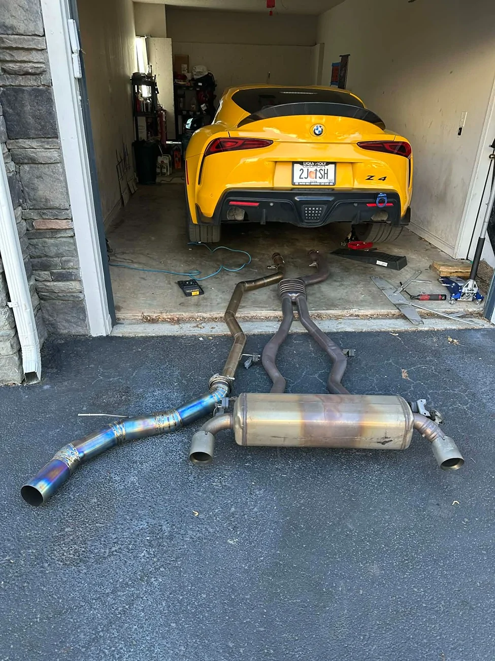

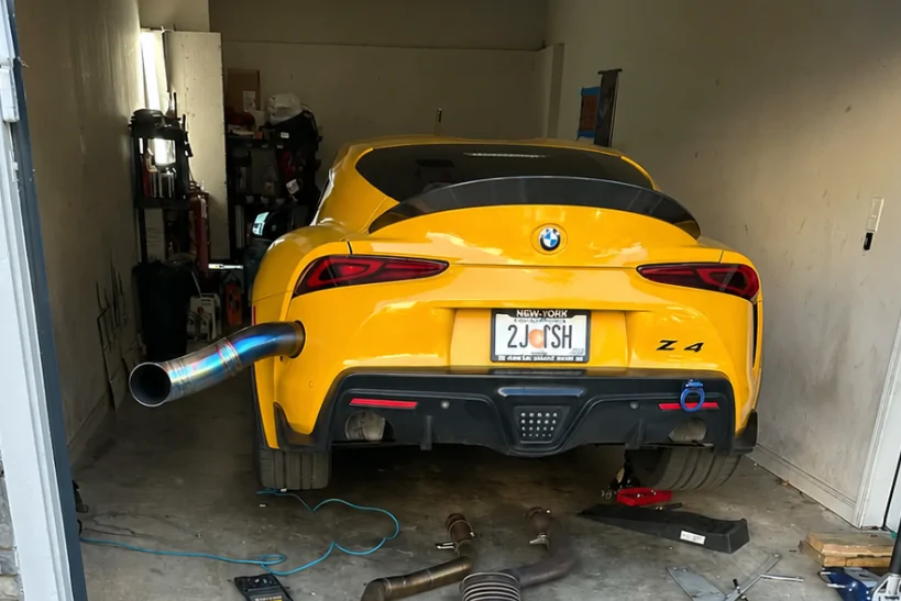

Just get something valved if you're concerned about noise levels then pick based on looks/sound/fitment. I have the valvetronic titanium exhaust with an AA catted dp. Valves open its very loud since there are no resonators or mufflers. Valves closed its probably 20% louder than a stock dp/exhaust with the valves open. Minimal drone too with valves open or closed. Fitment could be better.
