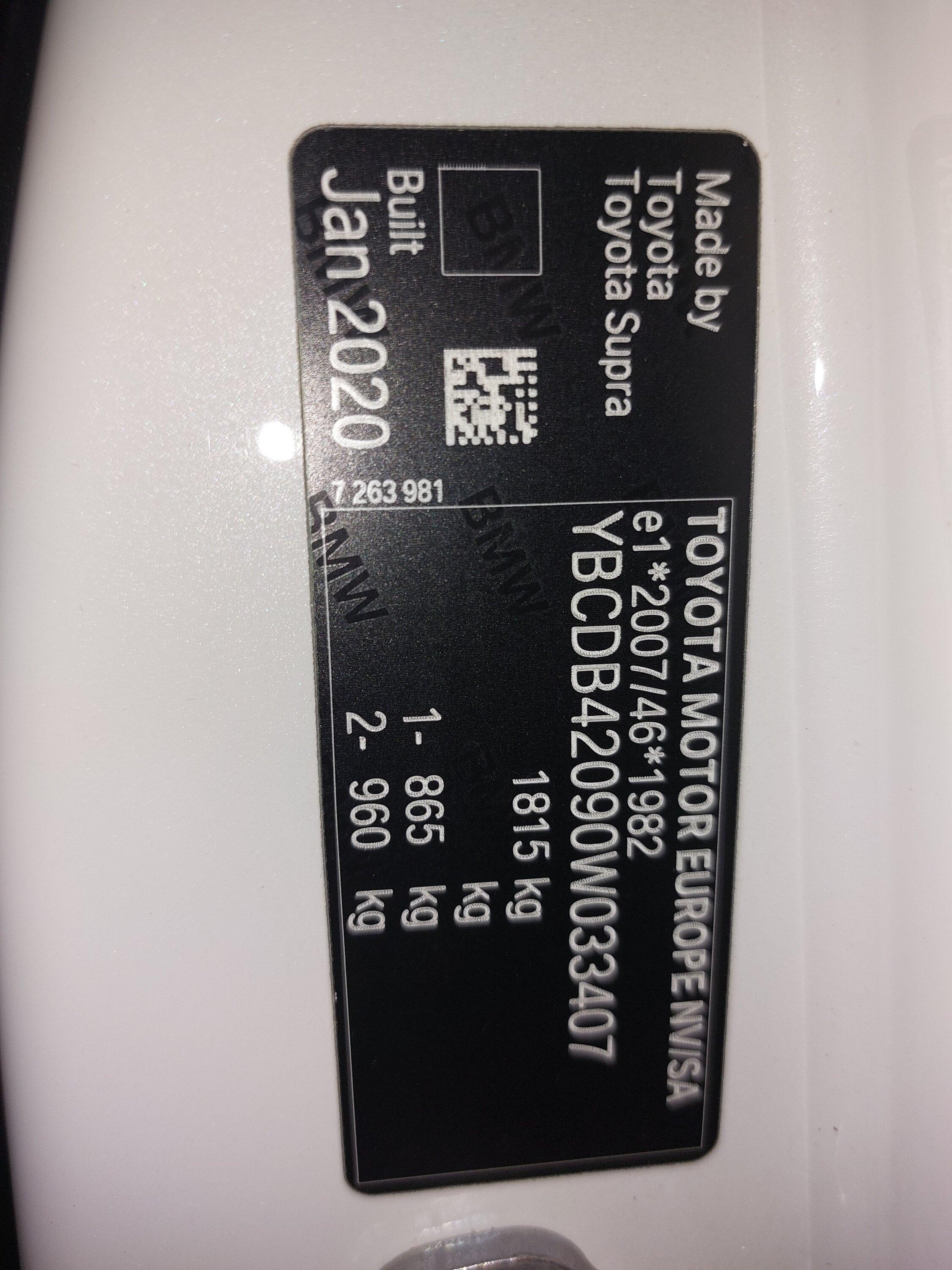

Regarding the ECU date. One option check the build date sticker in the door. See how close it is to June 2020 Or if confident enough to find the guide to check the ECU sticker.
You have options either way but itā€™s a lot easier with an tuneable ecu.

I should have a tunable ecu with that date?
