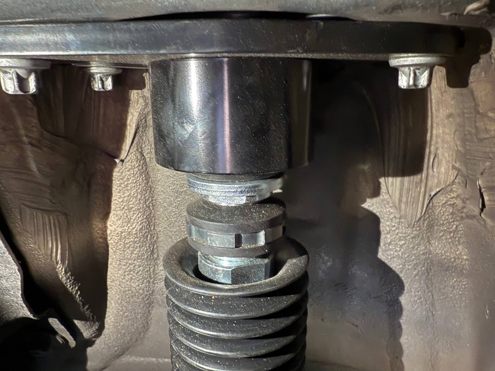

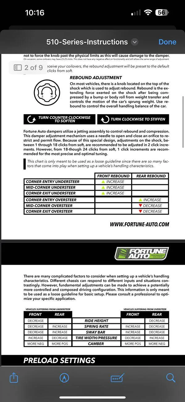

@rwense I got the suspension installed a couple of days ago. Not much drive time yet. I was looking at the rears and realized that I don’t know which direction to turn the dial for hard/soft. I don’t see any H/S indicators. Can you please let me know? Thinking the orientation would be top looking down for clockwise and counterclockwise. Thank you
