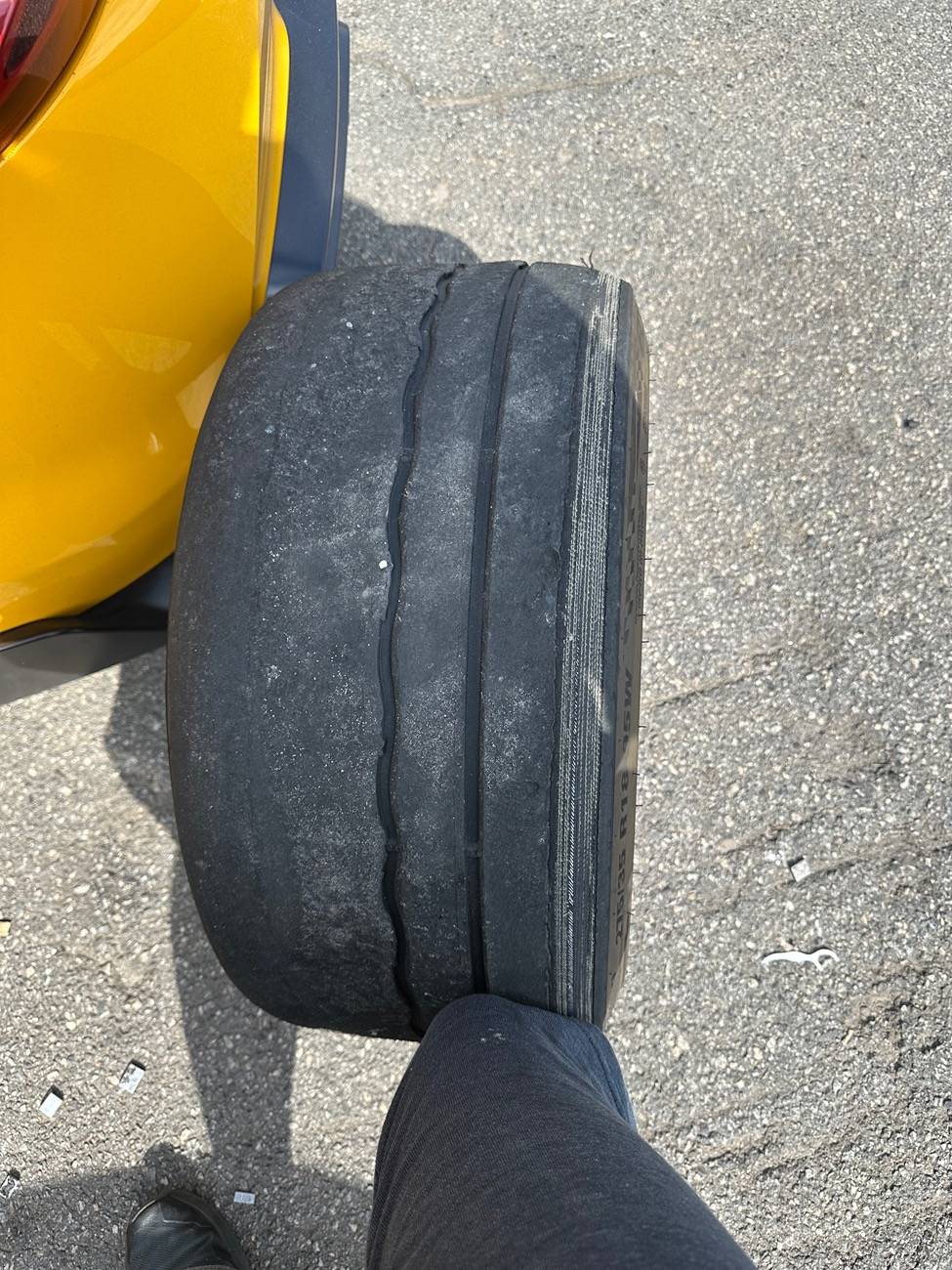

@rwense @Rensuhlo @FLtrackdays - Did you guys ever figure out the cause/fix for the inner shoulder wear? I know the season hasn’t started yet but just wondering.
Any rub issues I had was up front and before getting coilovers. We used 10mm spacers all around & probably only needed 5-8 mm. Everything after that was outer wear (rubbing on the fender/hood) until adding enough neg camber. Coilovers added more wiggle room.
Summary, spacers, more aggressive track alignment = for me, some toe out up front (turning in quicker & back end to rotate better) & more neg camber up front where I was chewing on the outer tires.

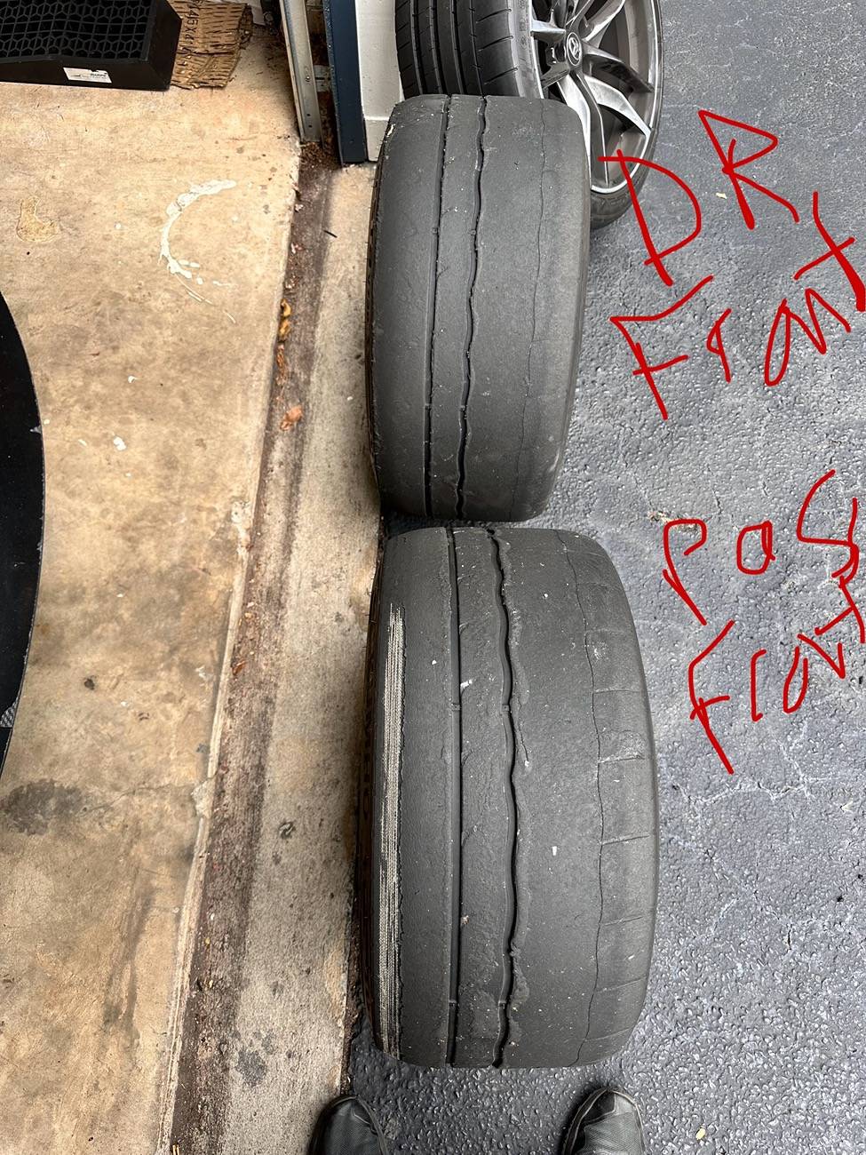

This isn't the issue he's referring to.
He's referring to the fact that @Rensuhlo and I had issues running v730s that tended to chord on the inner shoulder.
The issue has not been resolved as my car has been on stands until spring. However there doesnt seem to be one singular answer. Most likely the biggest contributing factor atleast in my case was too low of a spring rate. HOWEVER this combined with a flat ride height, a stiff front bar, tires with very stiff sidewalls, and running -4.1° camber all compounded. So after some discussions with friends, I will be going to a stiffer spring rates. 16kF, 20kR and adding ~0.5" of rake. So not only will my aero work better and get less understeer, this should also fix the issue.
Something to note however is I did not have this issue with Nankang CRSs or A052s (both softer and 40 profile).
Additionally I have spherical caster bushings thus the issue of toe out under heavy braking is not the issue.

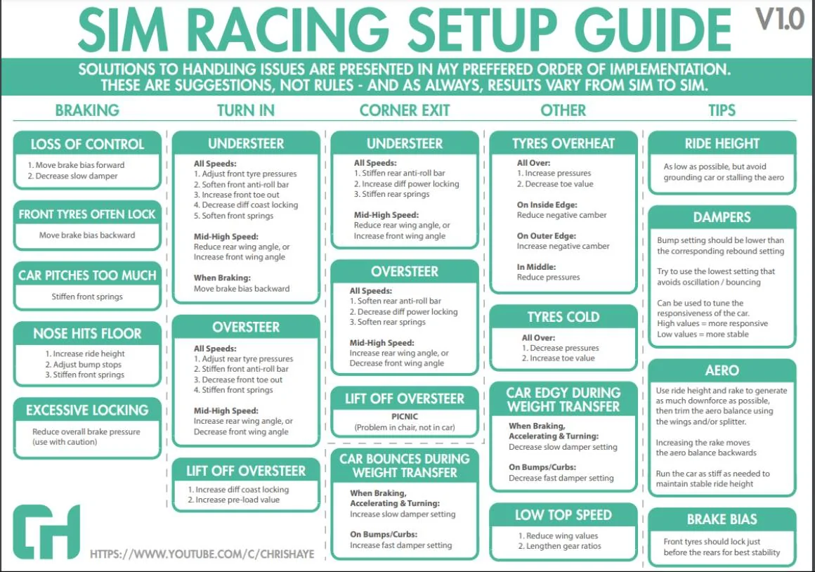

-4.1 camber - wow!!! Glad you got her resolved. My setup is obviously way more basic. I’m without aero as well. Regardless, dialing down my sway bars a notch and having less understeer helped me too. My Ohlins street & track coilovers are much less aggressive. But can still make more adjustments than stock.
Edit: Just found this online. I don’t SIM race or even practice on one (probably should). Crazy how so much of it translates over to what we’re doing. Obviously we can’t do all this with a click of a button or try it out as easily. But still, pretty impressive for a SIM guide ?
Something to note, I run that much camber because I mainly run Nankang CRA or A052s, I.e. soft sidewall tires that LOVE camber. So my setup is also not ideal for super stiff sidewalls
