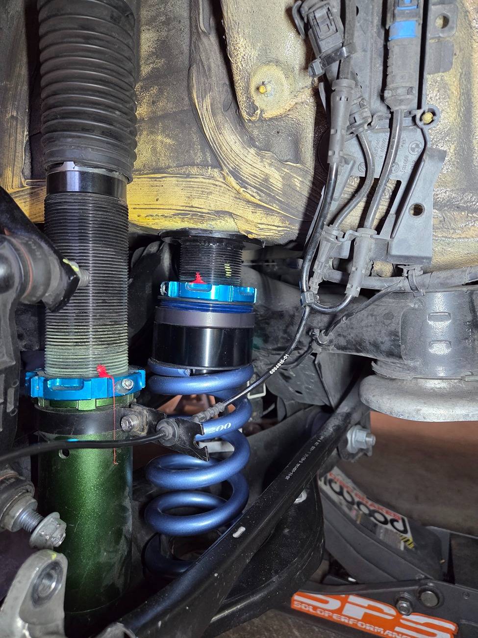

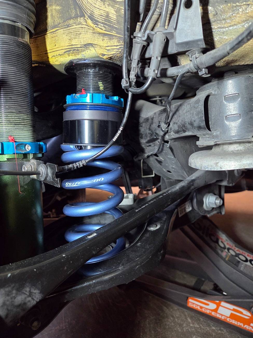

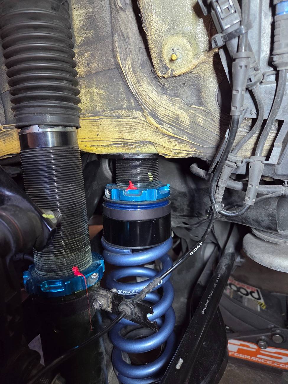

Alright, time for an update!
Now that im running more aero and such, ive upped my spring rates to 14kF/20kR (divorced).
So far the car responded extremely well to the stiffer springs and im now able to set my dampers much closer to the middle of the adjustment range (12 clicks, 24 total). Prior to this rate i had to try and control body movement by cranking up the rebound....which isn't really how you do that but regardless thats what I had to do.
Ive driven the car on track twice now and have another event next weekend along with some street miles here in Pittsburgh. If anyone knows Pittsburgh, the roads are less than ideal, and the higher rate definitely highlights that. so overall ride comfort has definitely suffered but if your Supra is more of a track car it feels right. Ride quality is such a subjective feeling but if I had to sum it up on the street, it feels like a track car.
As for on track, man it feels worlds different than the prior rate. The car takes a set much faster, transitions quicker, and pitch/dive is minimalized. Looking at pics of my car on track before and after the rate change, ive noticed the car retains positive rake at WOT and doesnt squat as much which is a definite plus when it comes to aero.
As for shock longevity, I cant speak to that so far, although I was assured by Fortune Auto that a rate change of 4k really shouldn't be a big deal. I spoke with them on the phone and was basically told that yes the 510's valving can tolerate an 8k rate swing but thats definitely more toward the extreme.
An important thing to note:
RMC motorsports specs a 9" spring for the divorced rear. More than likely you'll have trouble finding a 9" spring at 20k or similar rates, this means you must run a helper or tender spring along with am adapter for said springs to coexist. If you hope to run relatively close to stock ride height (14.5" from wheel center to fender) you will either need a tender with an appropriate stack height fully compressed, OR Fortune Auto's helper spring perch spacer. Most helper springs have a very low to 0 rate and thus when compressed contributes very little to the stack height. This spacer essentially adds to the compressed stack height to ensure you can reach your desired ride height. See the pictures below:
