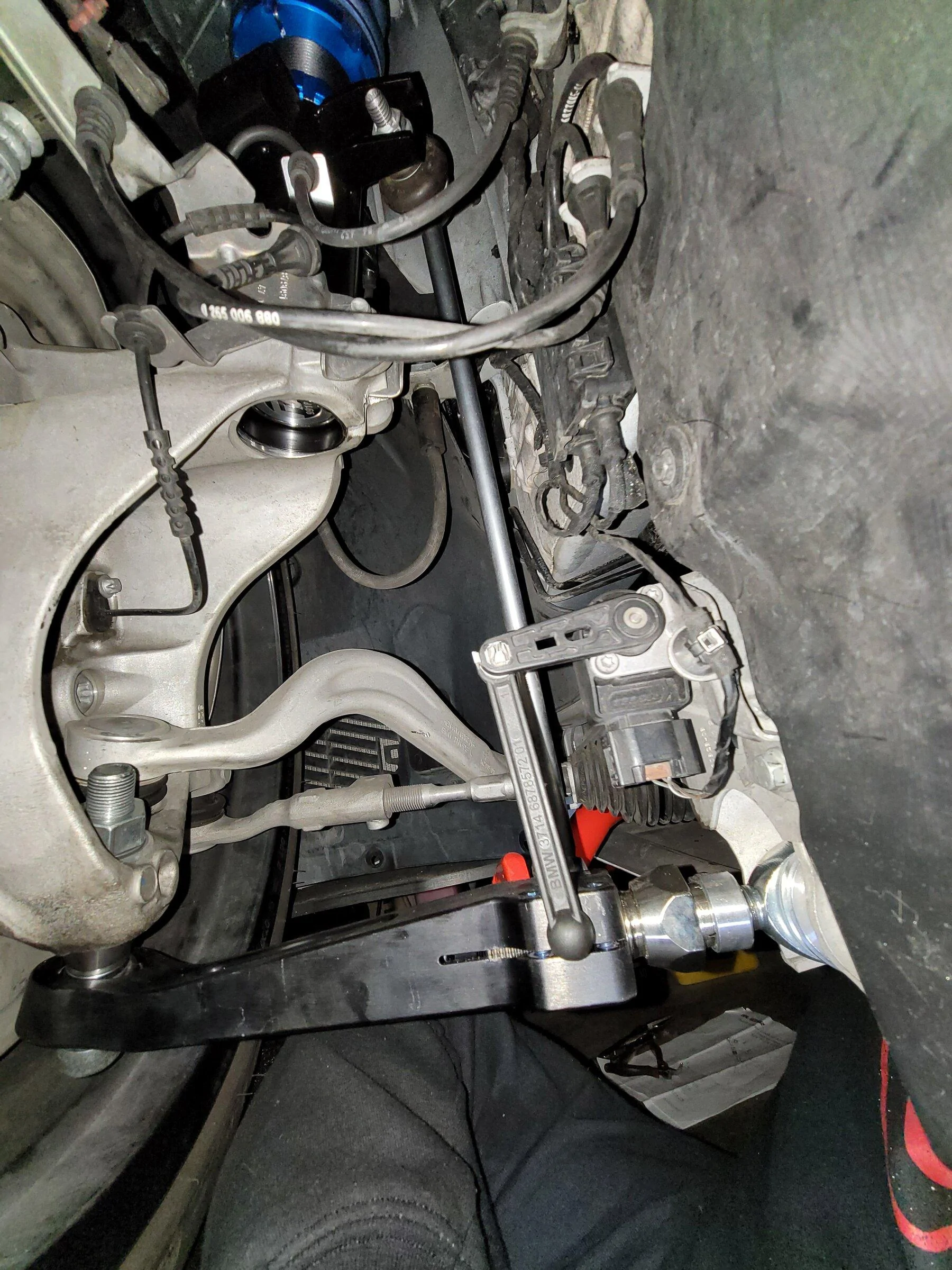

Which is the easier way to dial in some additional negative camber, the SPL lower arms, or some camber plates? It seems to me that the SPL arms would be easier to install and adjust. Long term I'll probably end up with both as I would like to take the car to the track a bunch, but for now I'd just like which ever will be quicker/easier.

After 1 autocross event Iā€™m seeing significant wear on the outside shoulder of my fr and rr tires. Iā€™m happy to go with SPL control arms, but Iā€™m concerned about ride height sensor issues. Is there a consensus about whether these will cause issues?

There is no issues.
I have them. Justuse the second hole with the supplied bracket t

No issues with mine at a lower ride height. I have the ball for the arm threaded directly into the control arm.

Thanks for the input. I just ordered a set of the SPL arms. Now to wait then install them.
