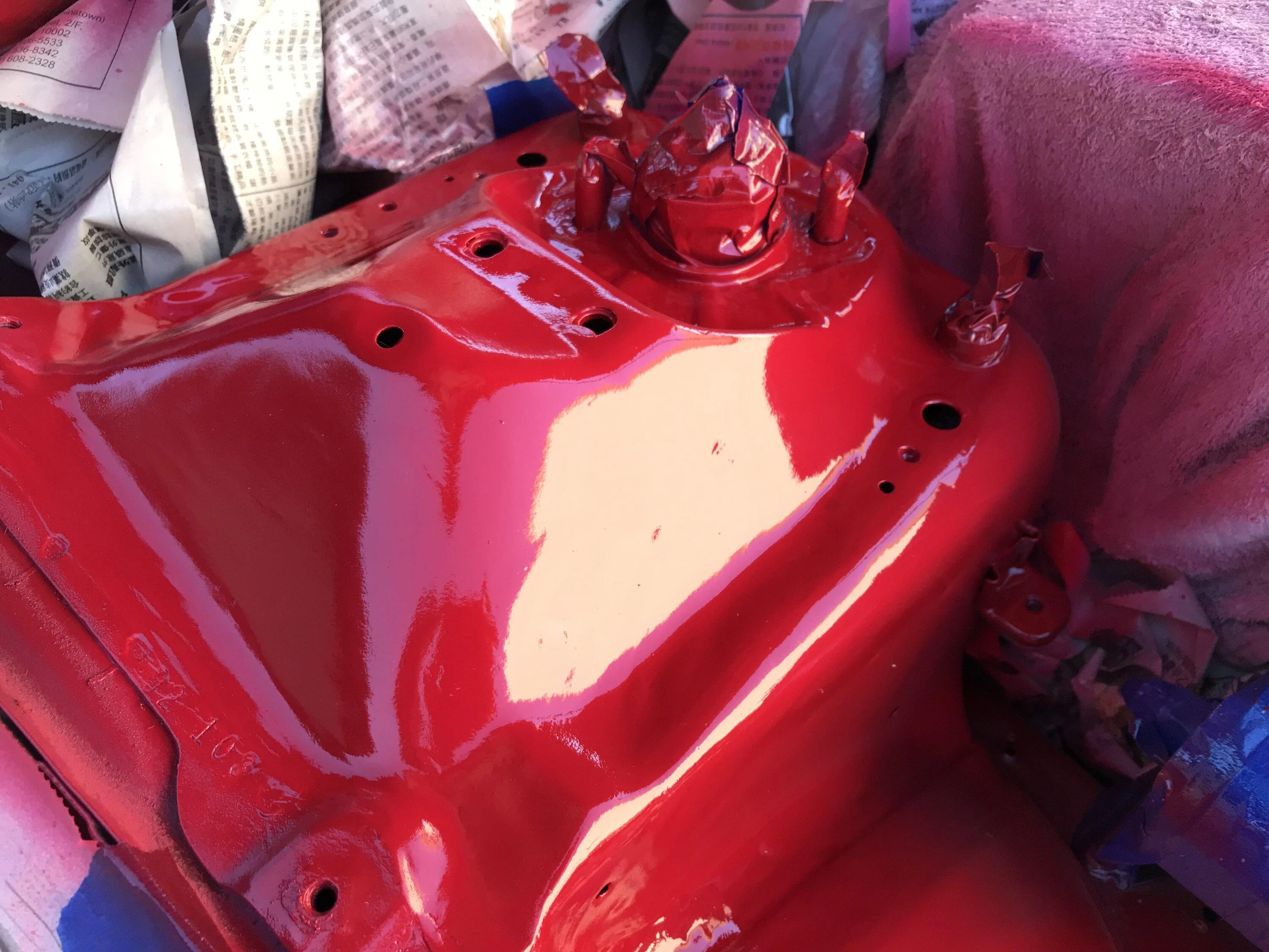

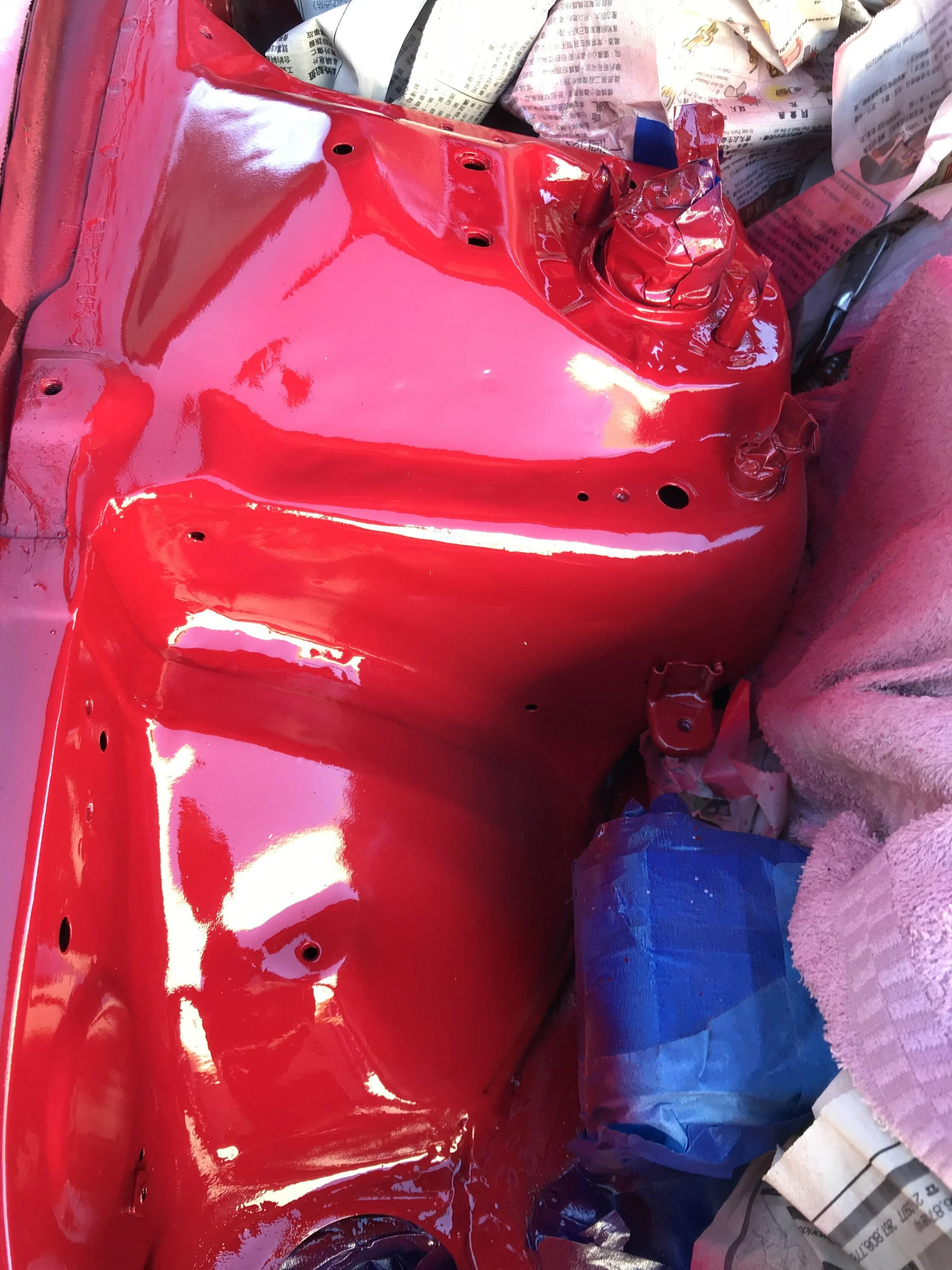

Your never wanted to “spray paint” components that are exposed to high temps like exhaust tips. While the high temp paint will look okay in the beginning, it will never last.
You definitely would want to do it right the first time and save the headache. Get it anodized or powdercoated. Even with powdercoating, I have seen engine components deteriorate over the years…. I have a ton of experience in “painting” stuff myself…

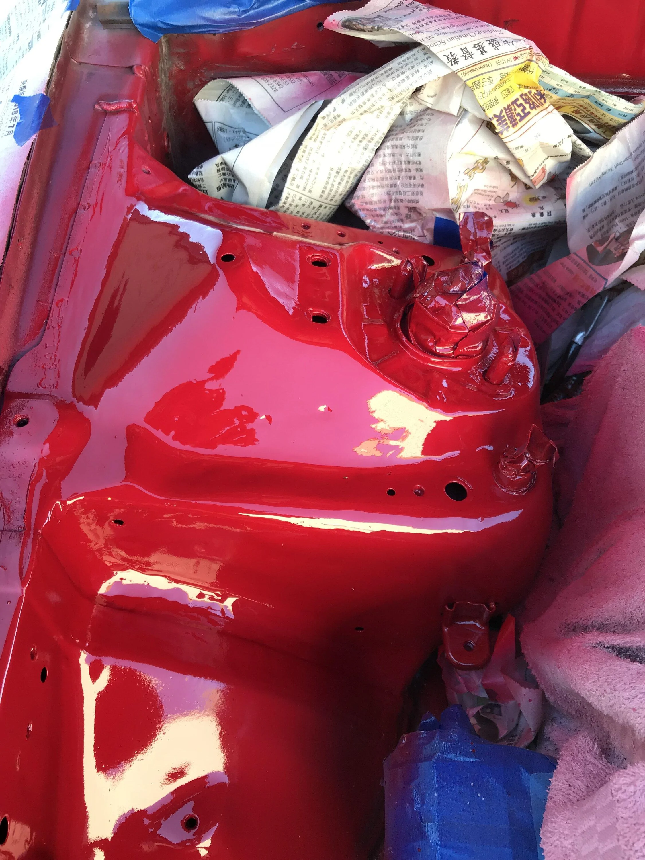

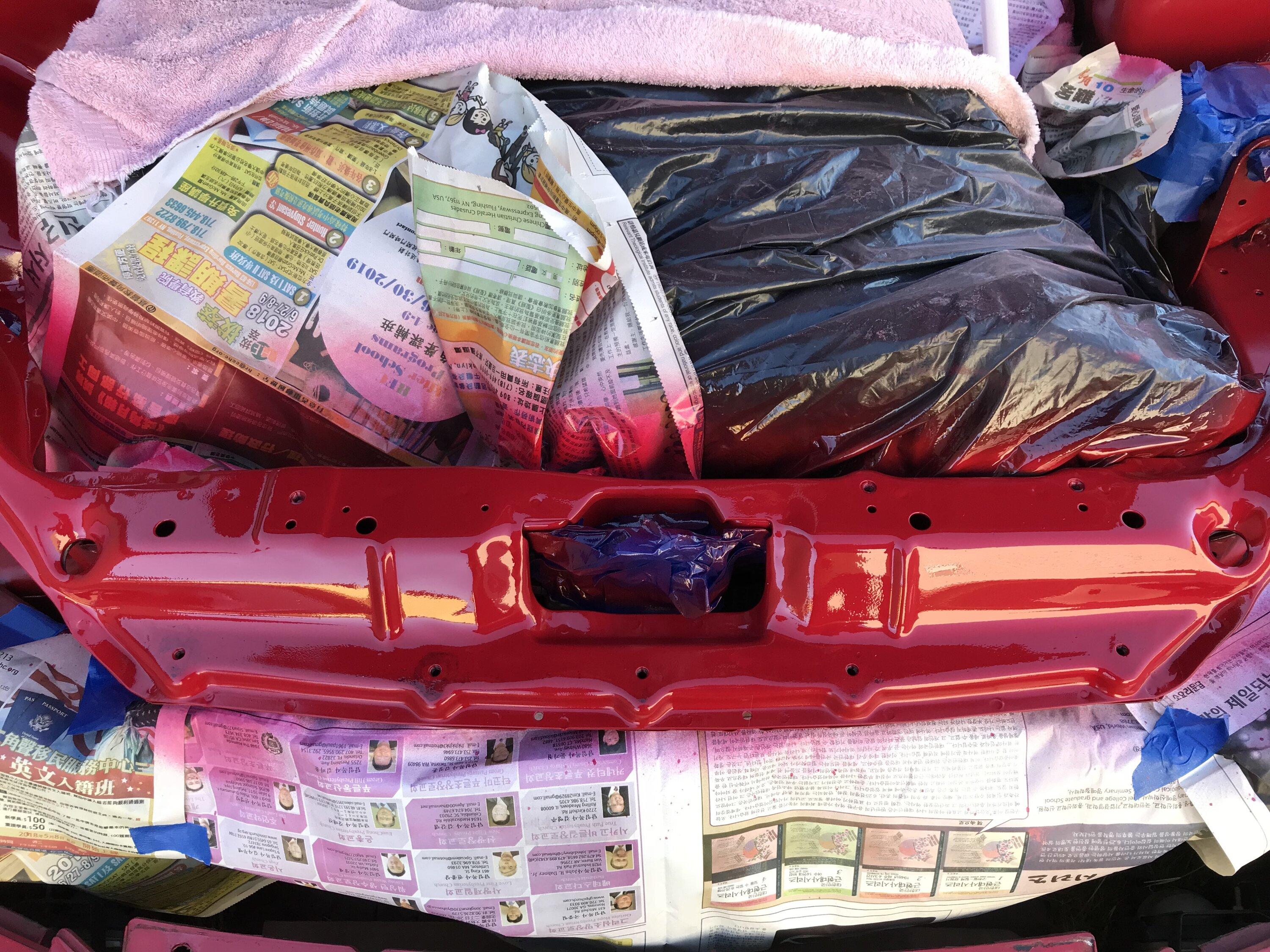

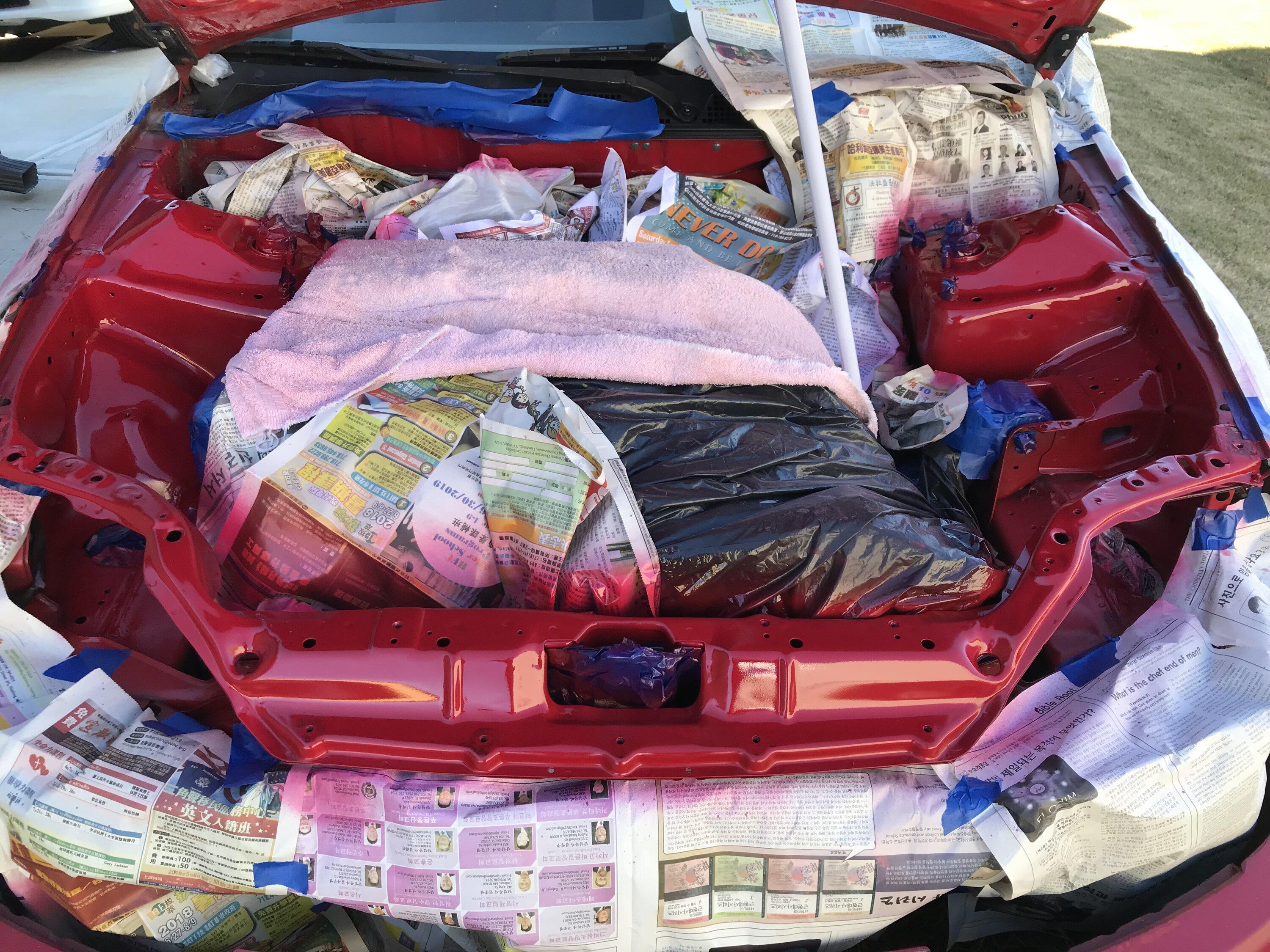

fyi, I have used the 2k stuff. It is comparable to the paint shop paints from a gun. I painted my civic’s engine bay with it. It held up for a long time. It didn’t use it with high temp stuff… Good luck with that…

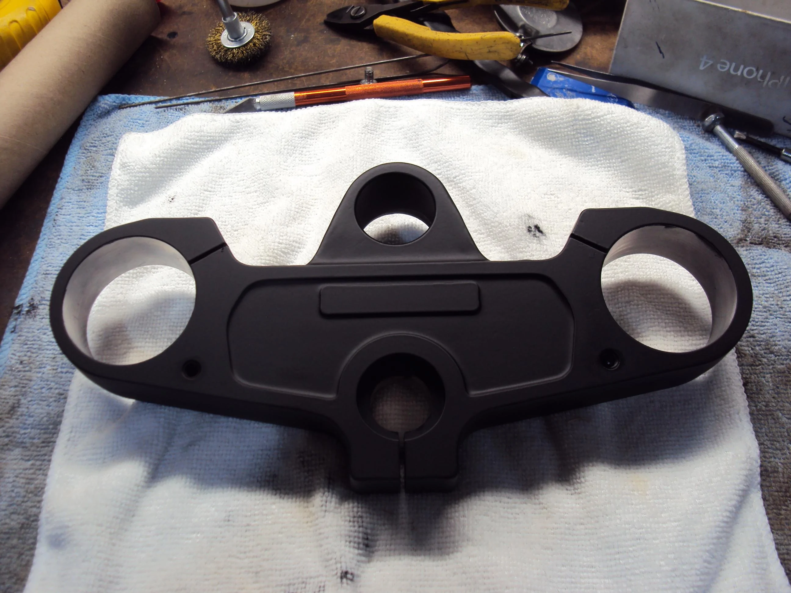

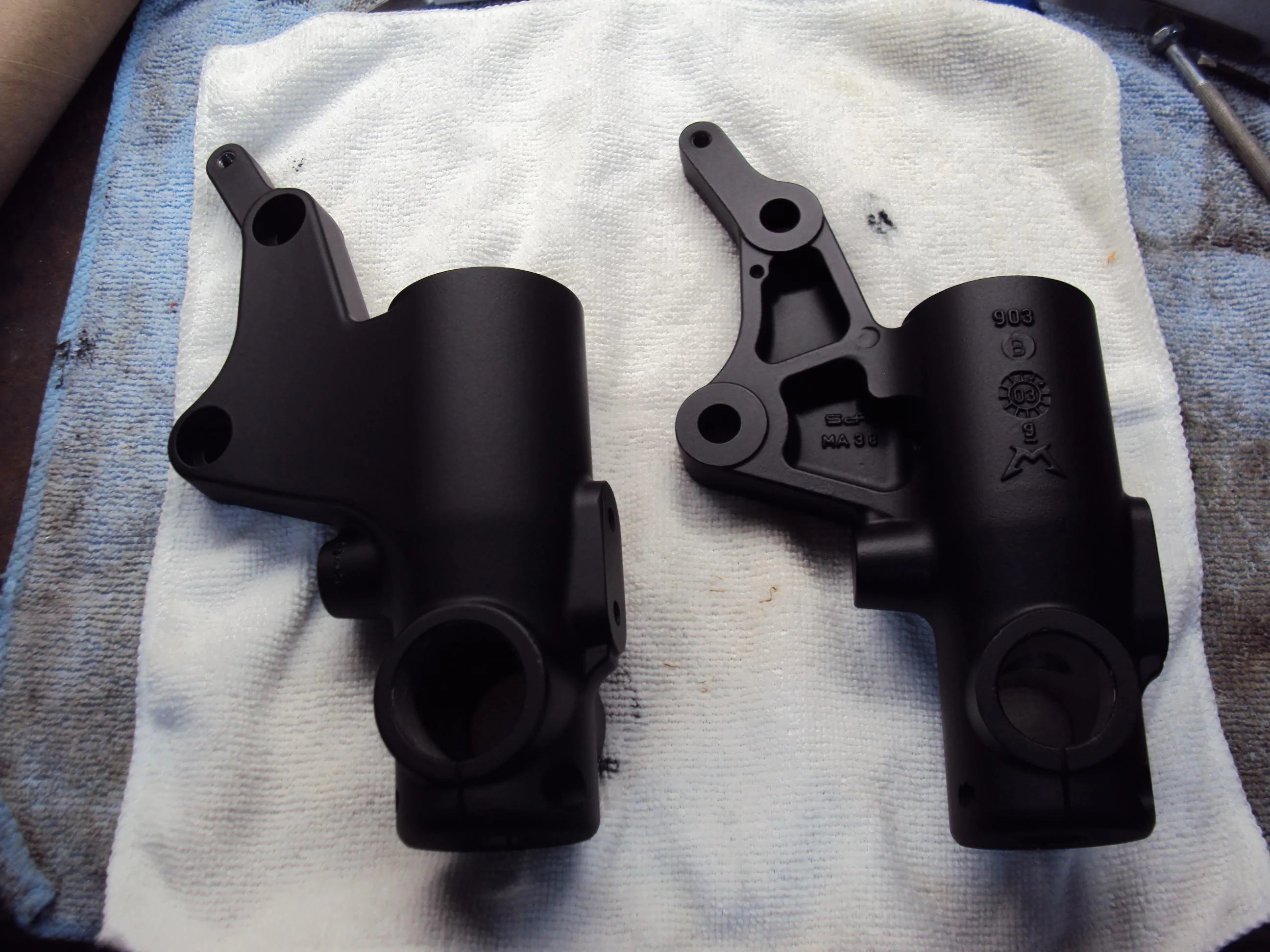

Deserving's got nothing to do with it it's engineering. I'm betting you didn't use 2K paint back in the 80's on your Civic. More likely rattle can engine enamel. You need to open your mind to proven alternatives. You can get a superior quality of finish and just as good durability in this application using 2K as you can powder coating.
Here's the quality of finish you can get with Matt black 2K, and it's a durable as any powder coat and heat tolerant to 190deg C.

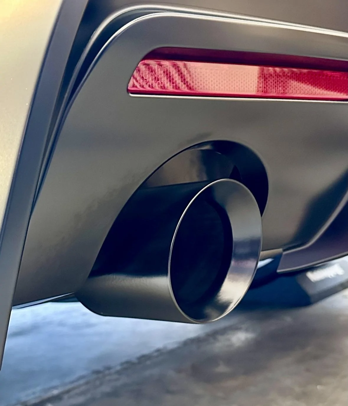

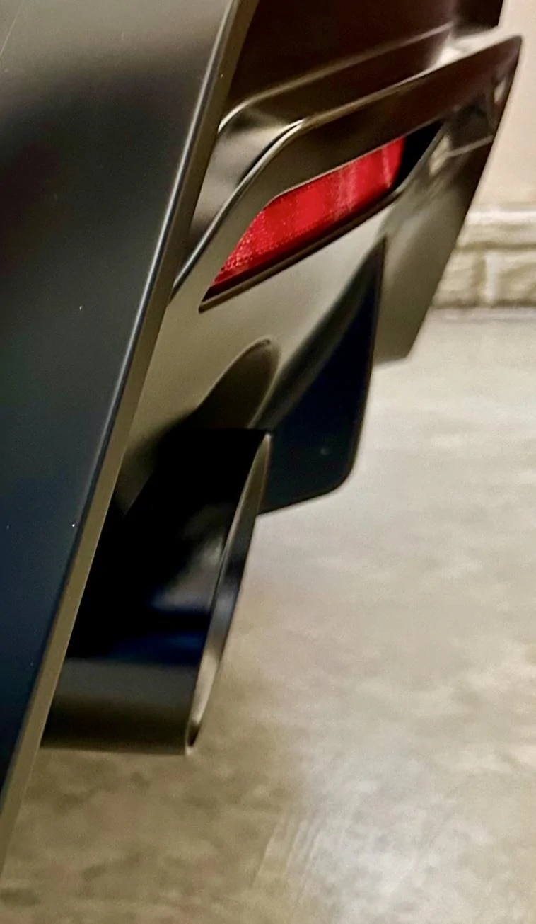

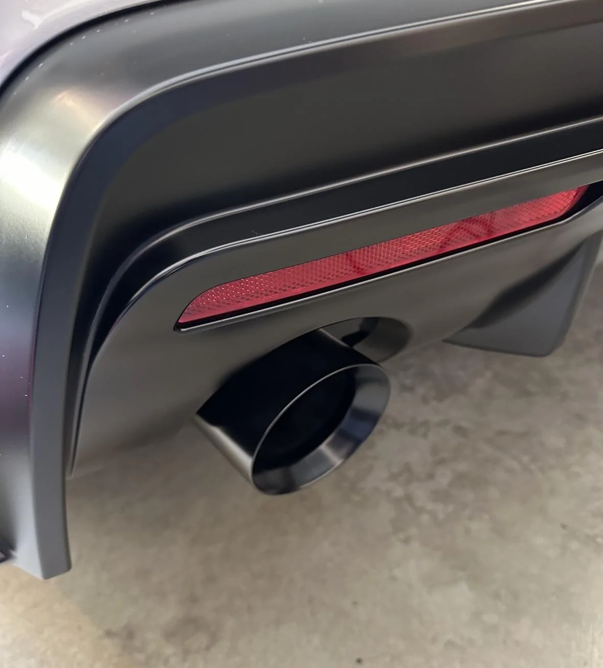

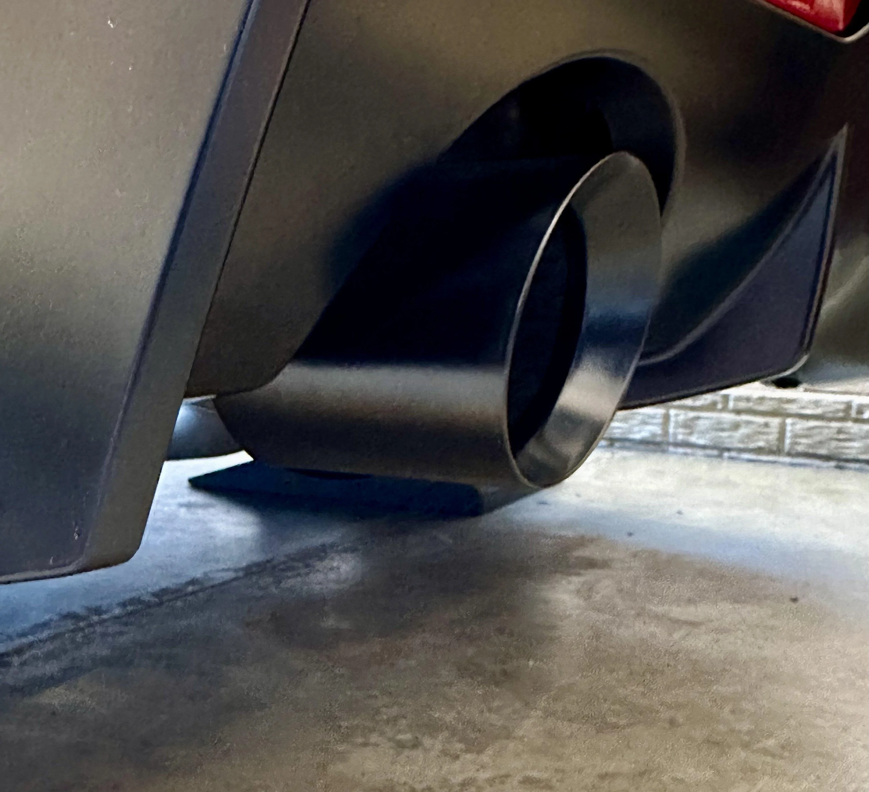

Well I must say I'm elated with the end result...
the powder coated satin black oem tips turned out fantastic.
A nice muted blend and clean look against the factory black lower rear satin bumper trim.

Tips still holding up, brother?
SUPRA90
Jan 29, 2021
90
109
FL
2021 GR SUPRA A91
Zero issues ...
They are holding up perfectly! ?
