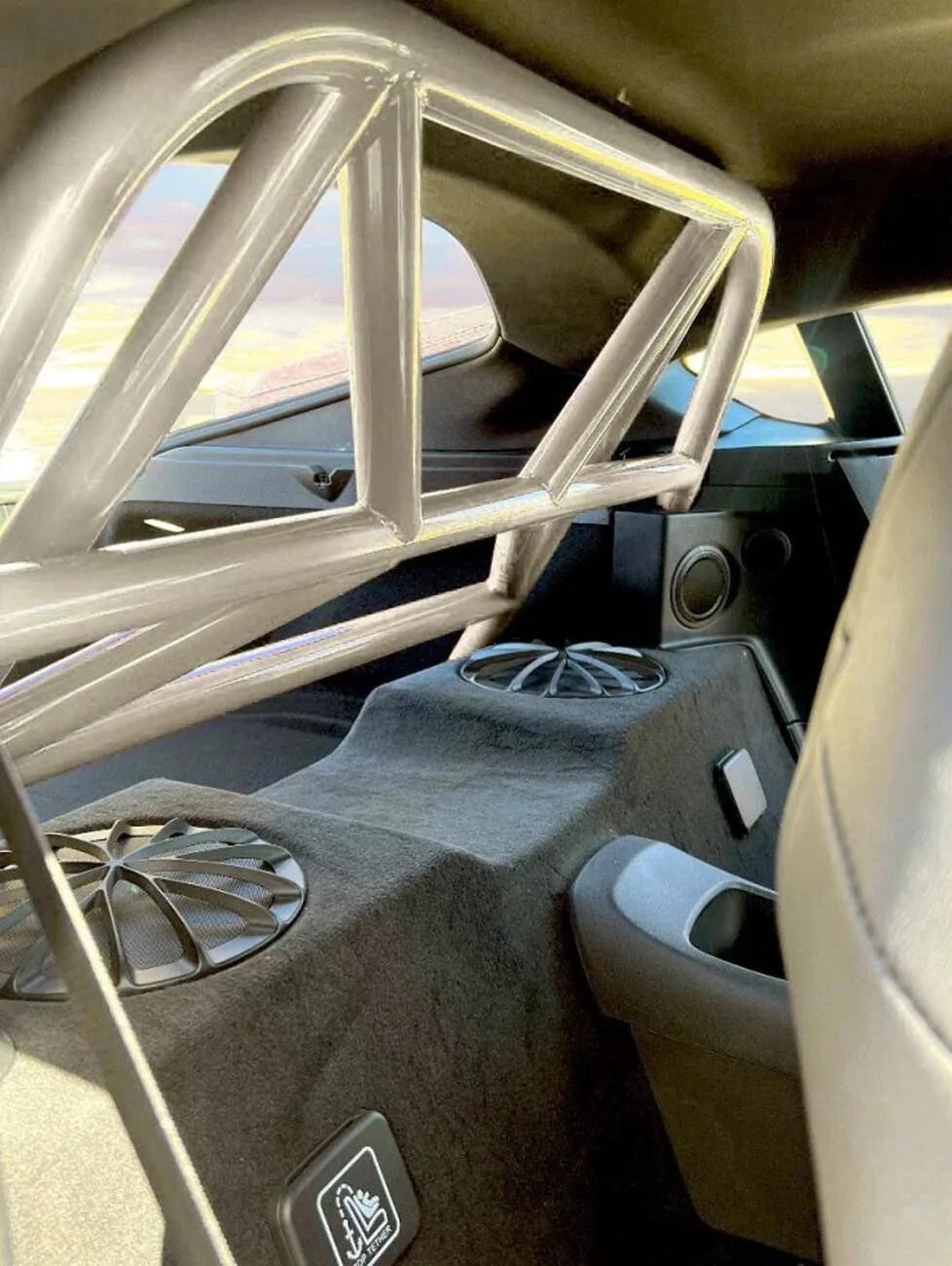

RSR uses rivnuts in crucial places and ONE SINGLE bolt in the rear down bars. Which does not pass any class rules. It's a show car bar at best.
CMS isn't triangulated correctly and is basically a mouse trap. Just look at the photo of it below... that thing ain't going to do any good in a rollover.
What Kyle said above are much better options.
