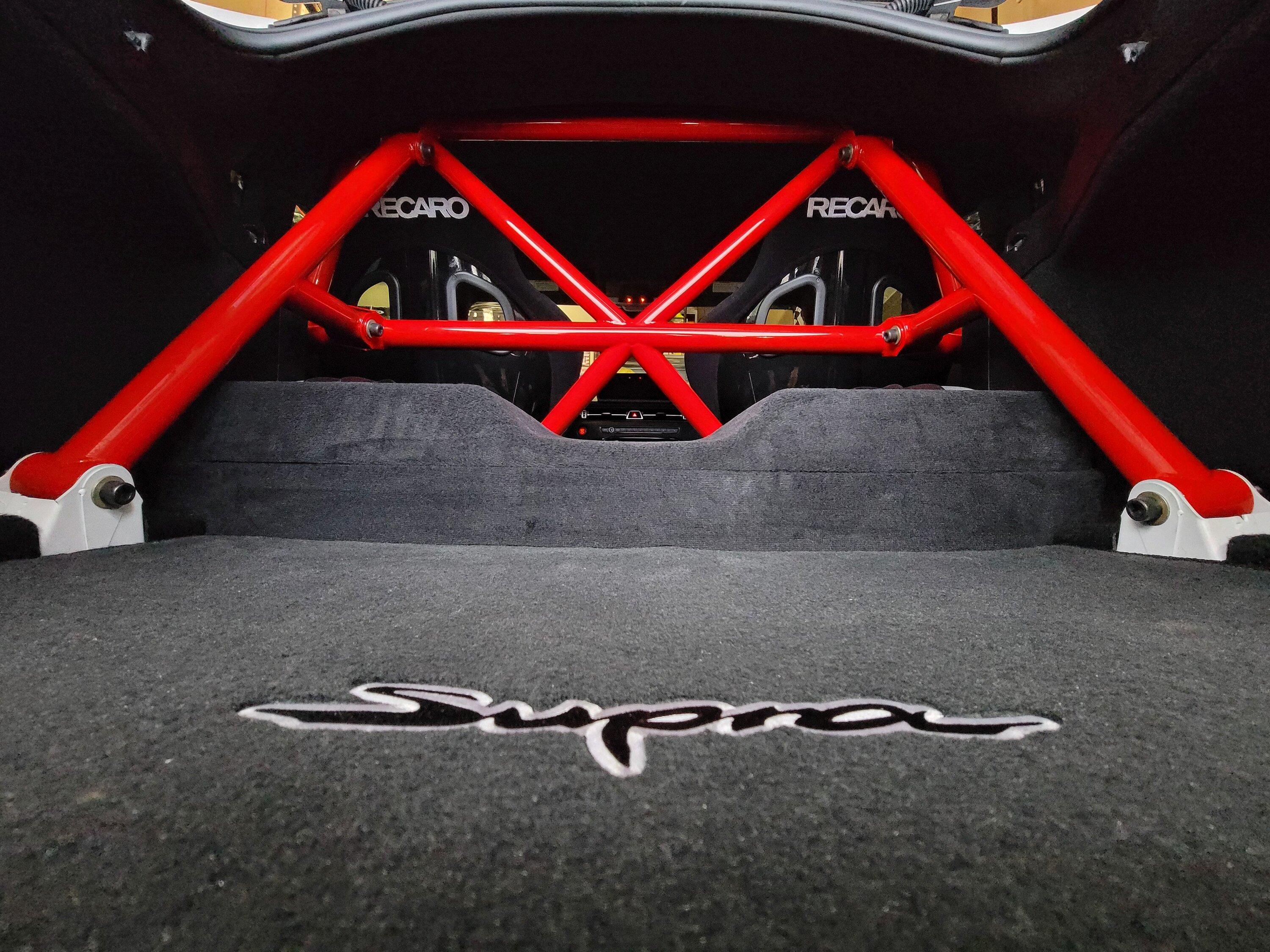

Is there a way we can modify studio rsr cage to make it more safe? Lol I think theres bunch of us using studio cage u.u

Using more than one single bolt would be a step in the right direction. ;)

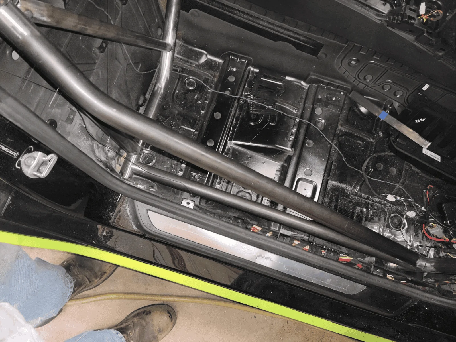

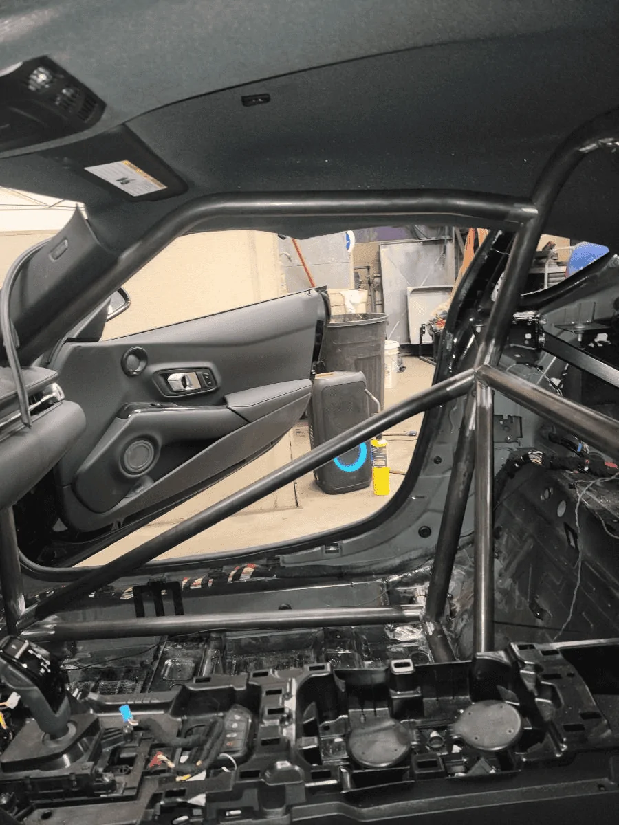

Please disregard my ignorance if this is a dumb question, but can’t we just weld that bad boy into place?
Rocksandblues
Bob
Sep 21, 2020
2,556
4,718
Virginia
Yes. But a lot of removing interior and welding different metals
