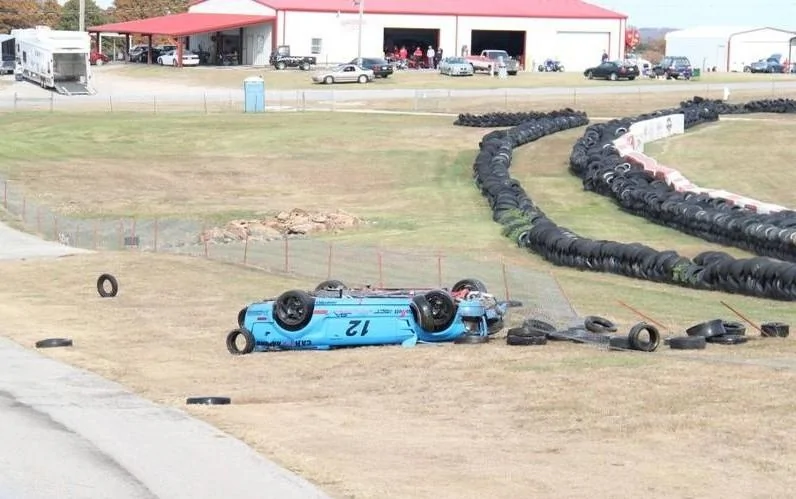

I have the Studio RSR half cage and I love it for what it is. There's already been a Supra wrecked with one and it did its job. That being said if I had a track only car then custom full cage would be the only option.

Roll bars are definitely better than nothing. Good to know they hold up. ????
