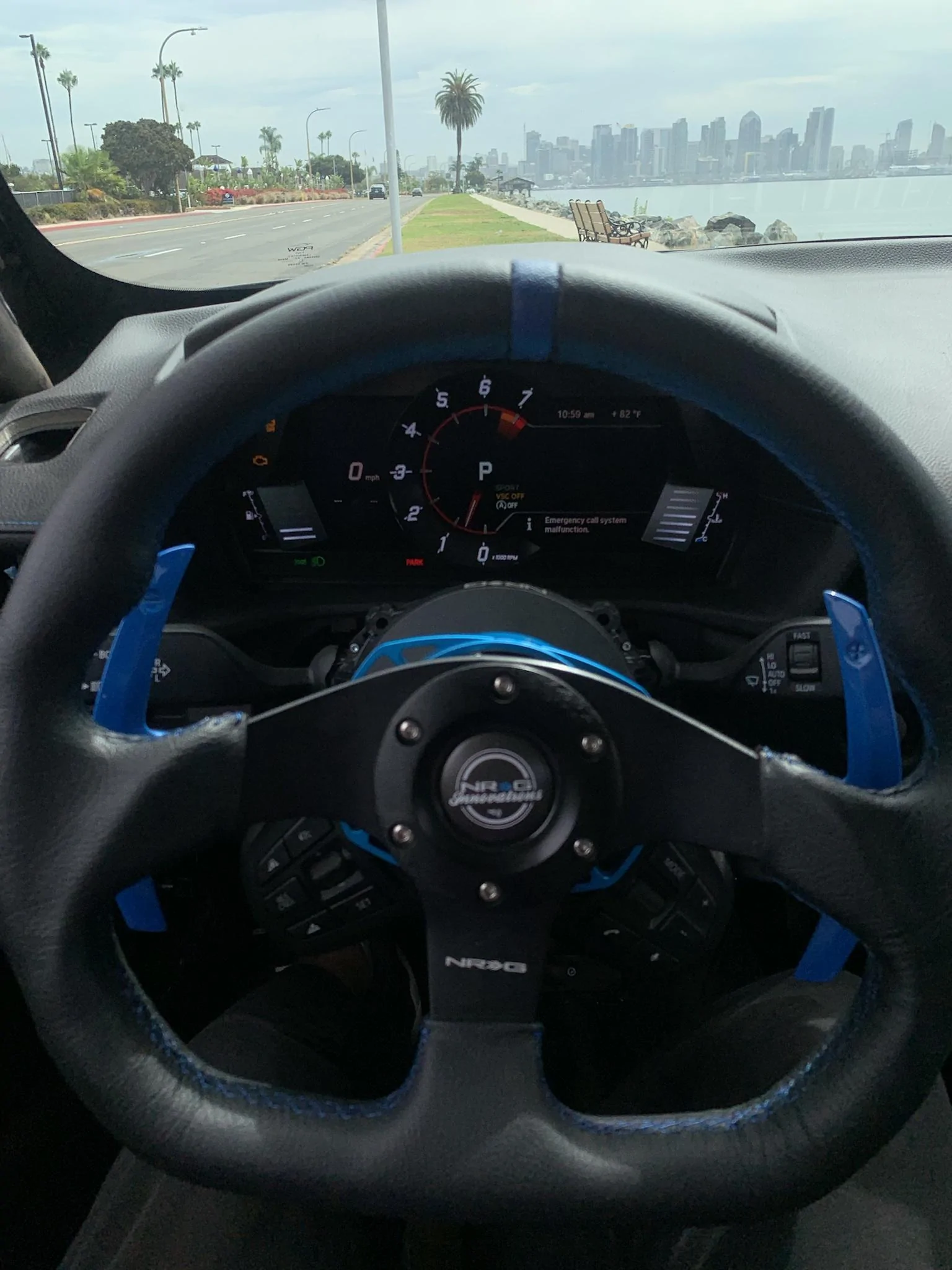

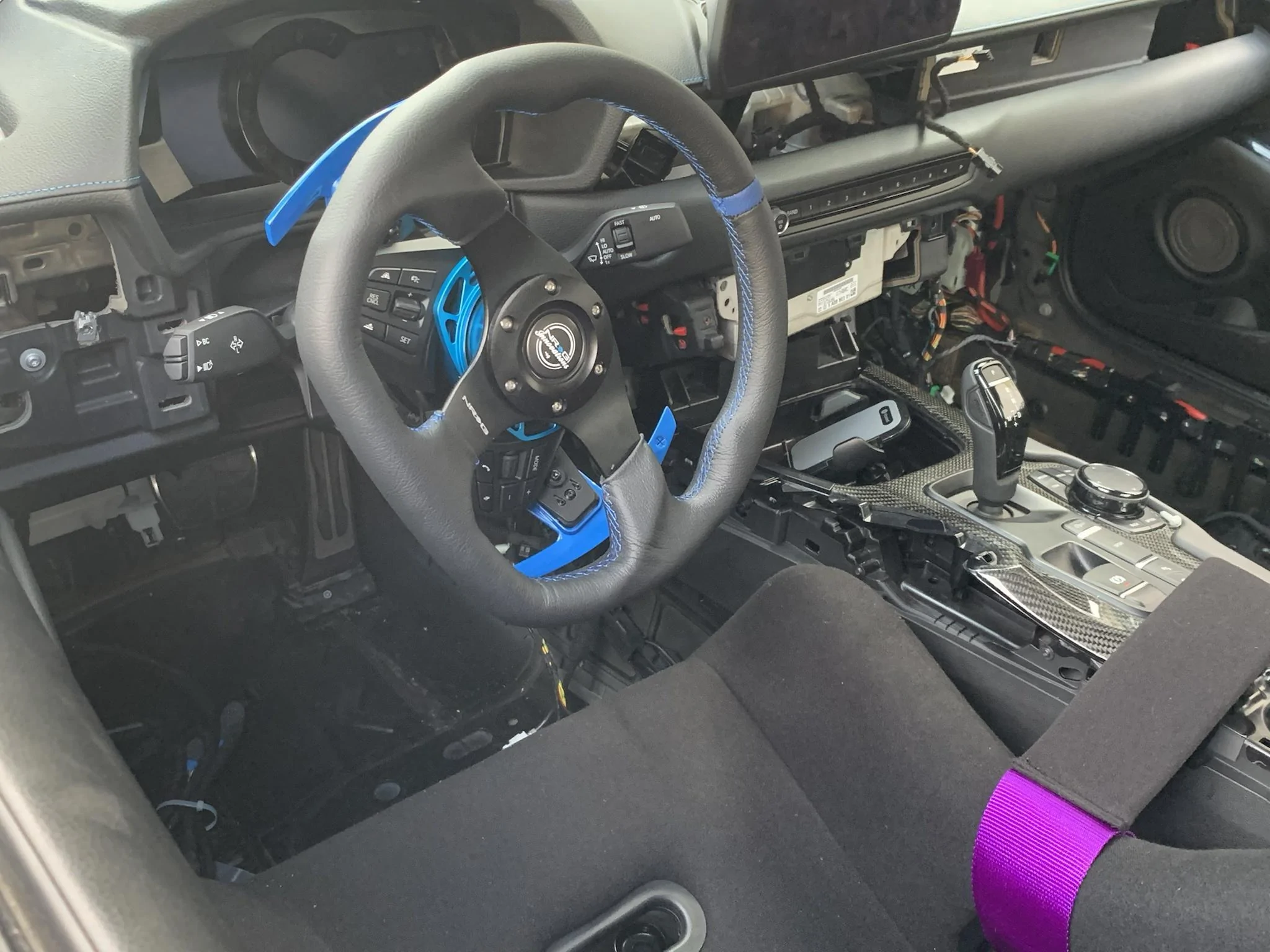

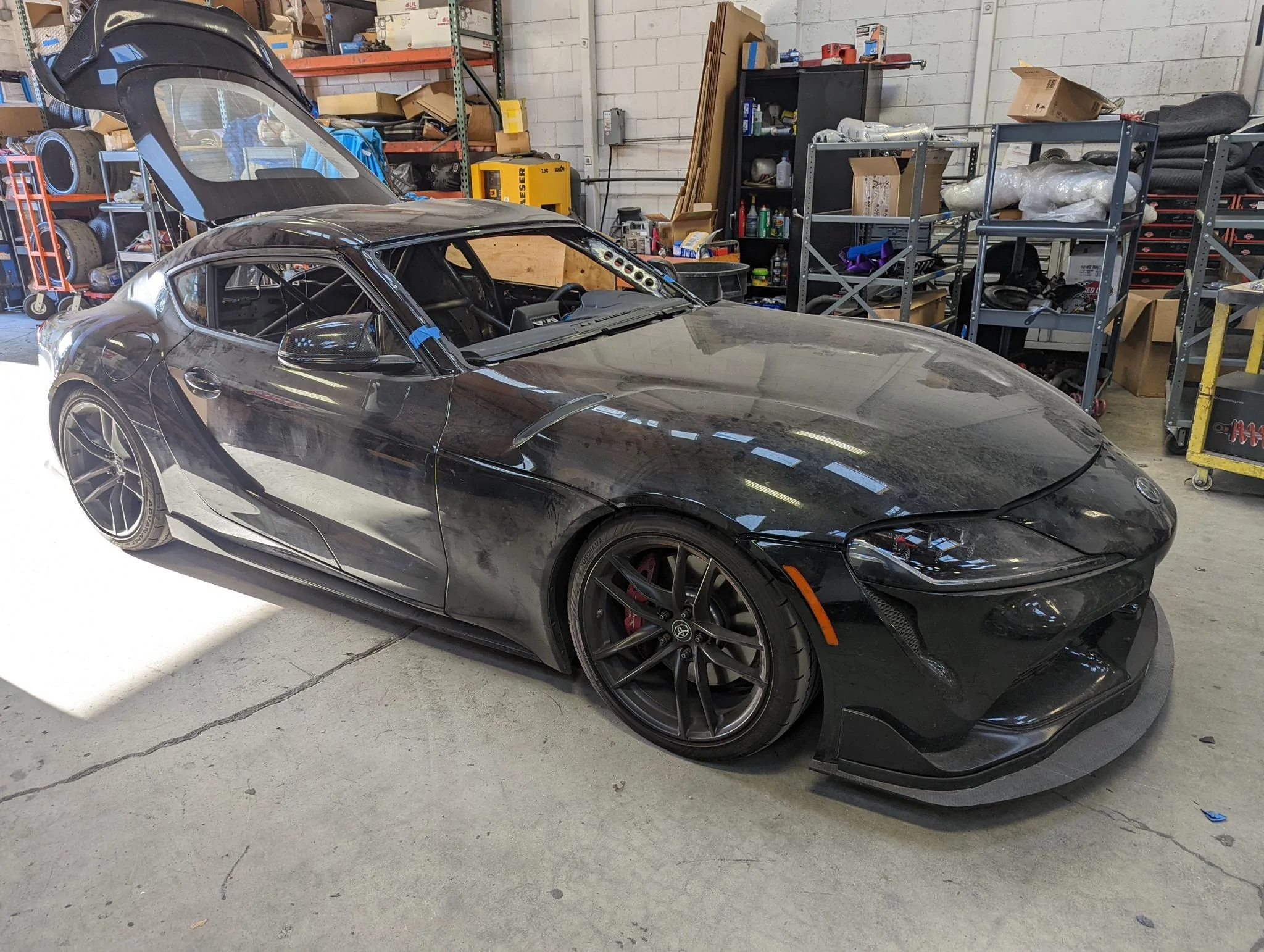

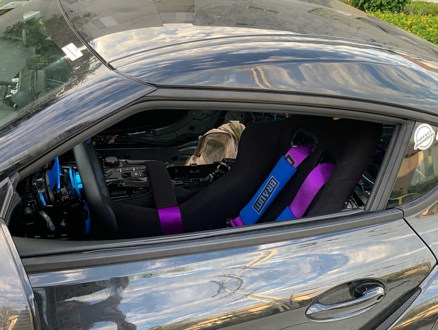

Pics of the stripped interior with the momo seat and quick release wheel… dropped the car off at the fabrication shop to get full cage and safety nets and other equipment put in as well as replacing all the glass with lexan :headbang:
stickers add horsepower I heard still waiting for my toga waifu stickers to show up
So much easier getting in the car now with thequick release
car is going to be black, blue and purple
damn this car and it’s stupid electronics took it all apart and the instrument panel doesn’t work anymore … so worried I was going to run out of gas on my 6 hour drive
I found out the airbag sensor is mandatory even without them stupid car wouldn’t move until I plugged it back in took me waaaayyy to long to figure that out, car will lock the rear brakes wont release and no throttle input
car still is being stupid and not locking the doors or responsing to the key fob all the time but whatever the door key works and the car runs sort of… seems like it doesn’t have as much power since I can’t wheelspin smash out of first gear like I want to all the time

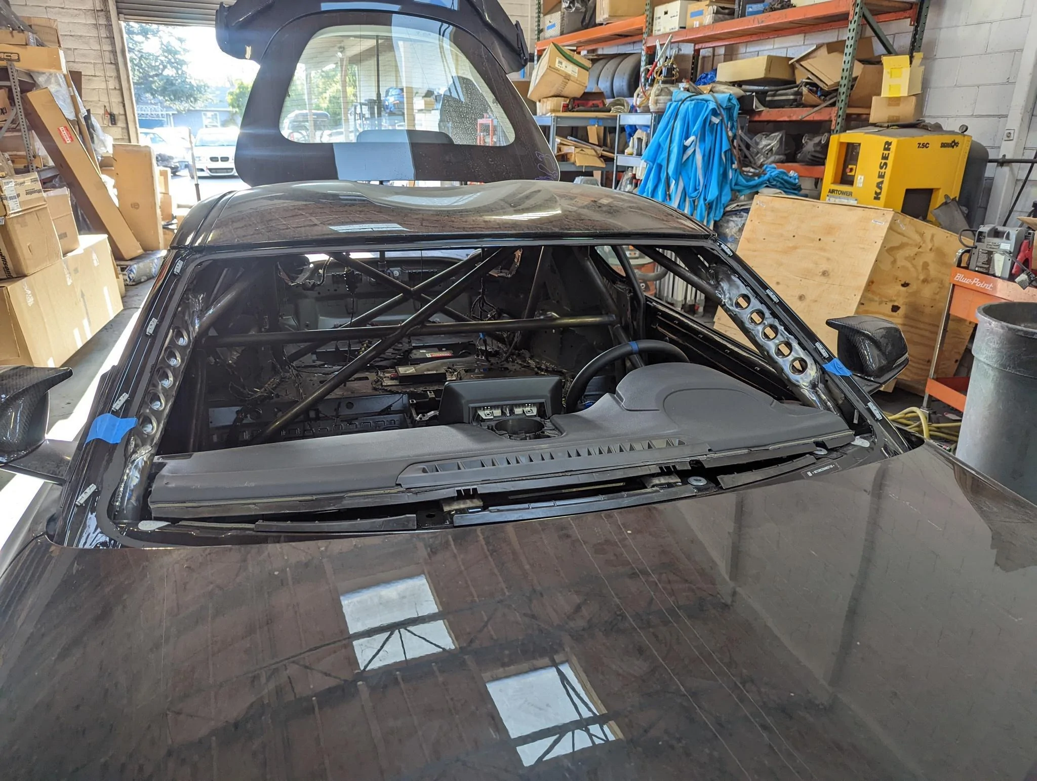

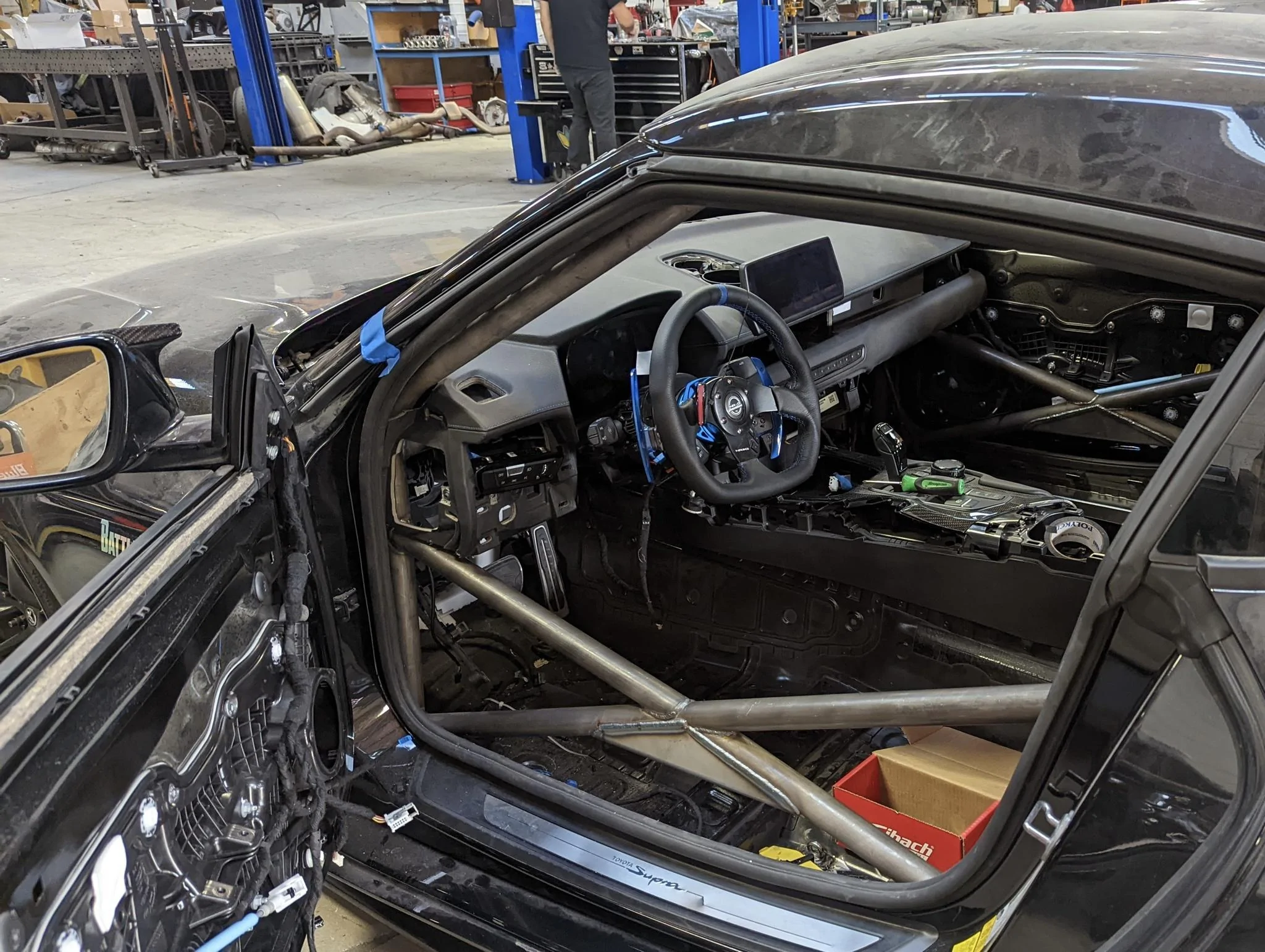

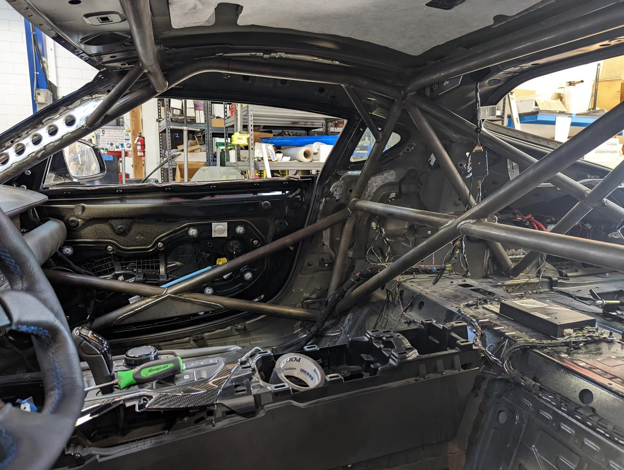

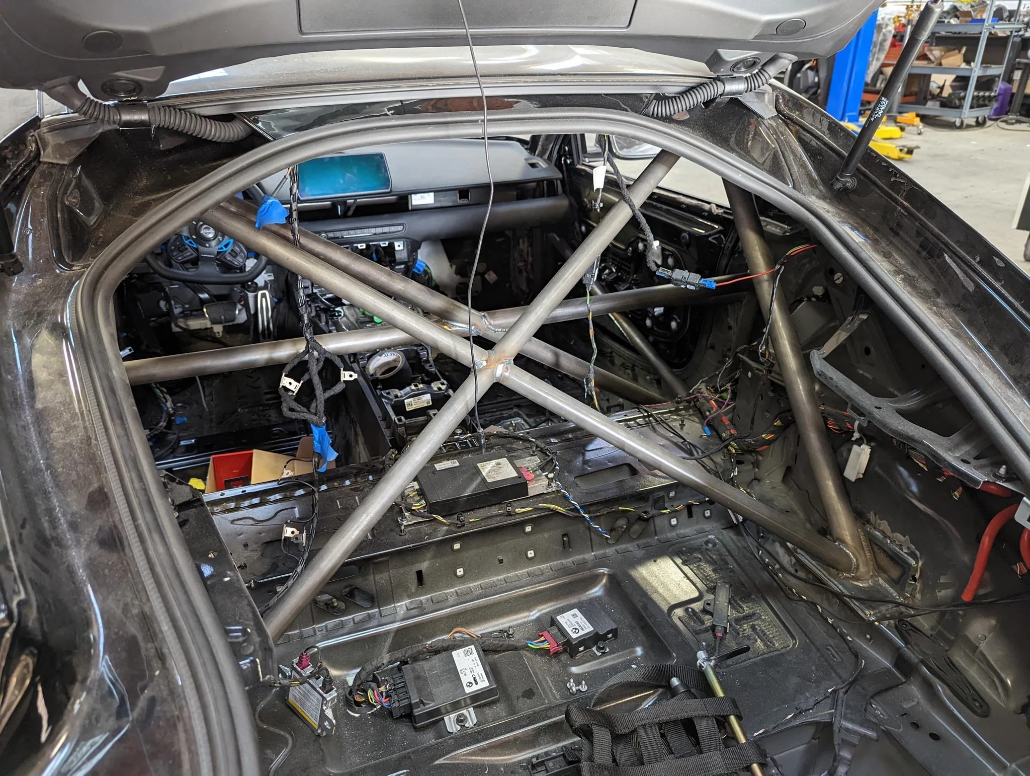

Rollcage is installed everything is bare eventually I will do the prep and paint the cage/inside purple but this is not a priority
Going to feel 100% better about ripping around tracks now really did not feel safe at all previously
Still working on my canbus datalogging/track code because im lazy will be adding a small shift light bar into the dash and mounting ipad somewhere for live diagnostic data viewing

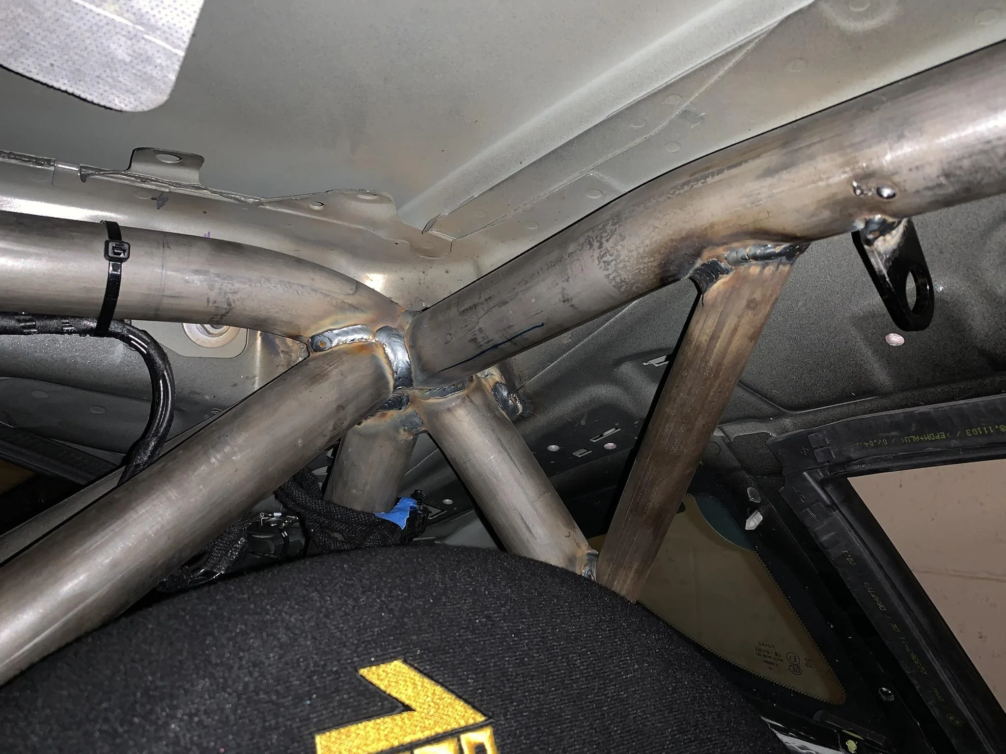

Just some more photos from the shop from the cage build - replacing all of the other suspension components and getting back on track soon ....
ok, now that is a proper cage and race car. It is what i want to do with mine if i stay on this platform.
I would love to know how much you both feel a proper cage stiffened the platform (assuming you end up doing this @Rocksandblues). I feel like this chassis is pretty rigid in stock form, but I've also never been in a car pre-/post-cage where I wasn't impressed by how much it stiffened it.

Is this a SCCA compliant cage? Wondering about the front lower bar crossbeam. Seems like it would need to go behind the centerstack somehow. I don't see that in your photos, did you have it done? If so, you mind grabbing a couple pics?
Great chassis. full welded cage can't help but stiffen it up some. Is it measurable in lap times? doubt it.
Mainly safety. You are adding weight to a track car but pretty big safety item IMHO
Right on. Yeah, people have always asked me why I spent so much money on a helmet, etc. I figure if there's one thing I'm going to put money into it's stuff to protect my noggin and accompanying parts. I feel the same way about a cage.

Nice looking cage!
Will be ok for scca - cage was built for nasa st/tt - there is a cross beam that goes above the center just under the dash pretty much all the space you have for it but there is space after removing the dash brace and ac stuff, steering column mounts to it and feels rock solid now with whole quick release setup
Yes this is all for safety rather focusing on being safe first then will add massive power
