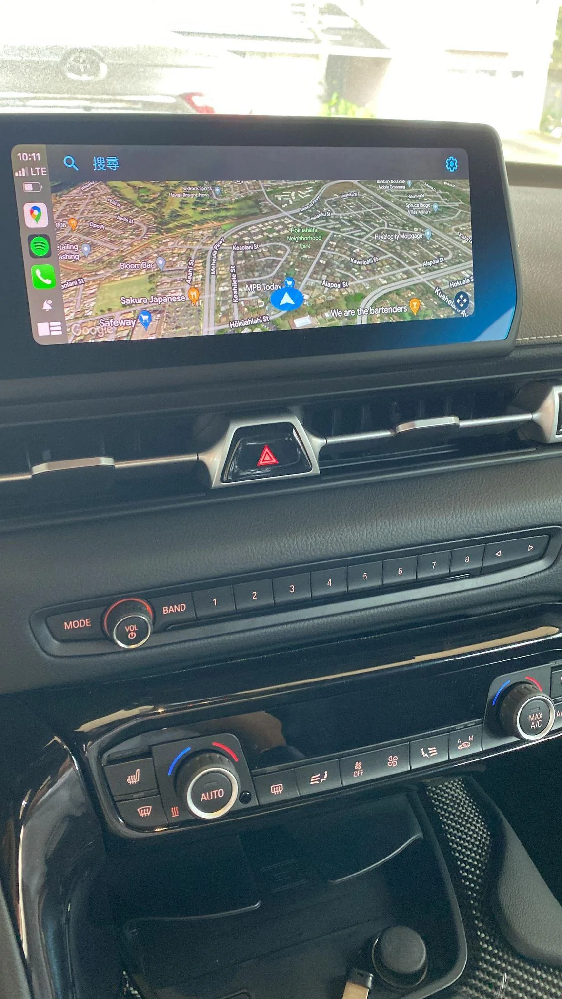

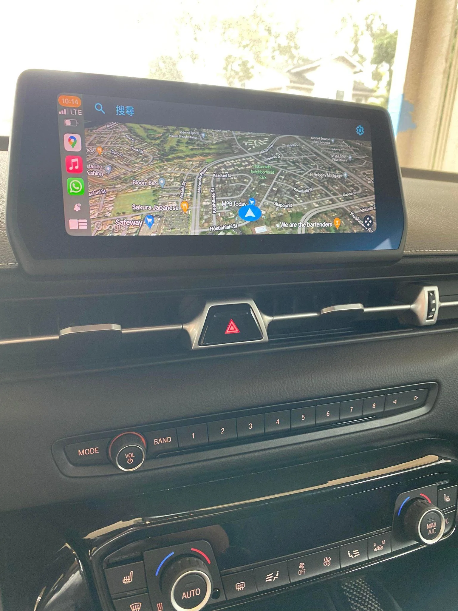

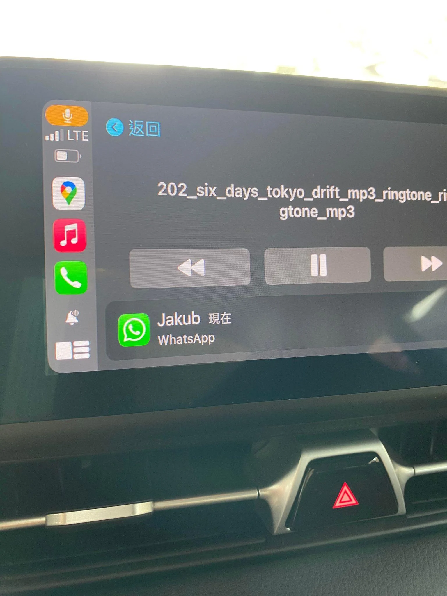

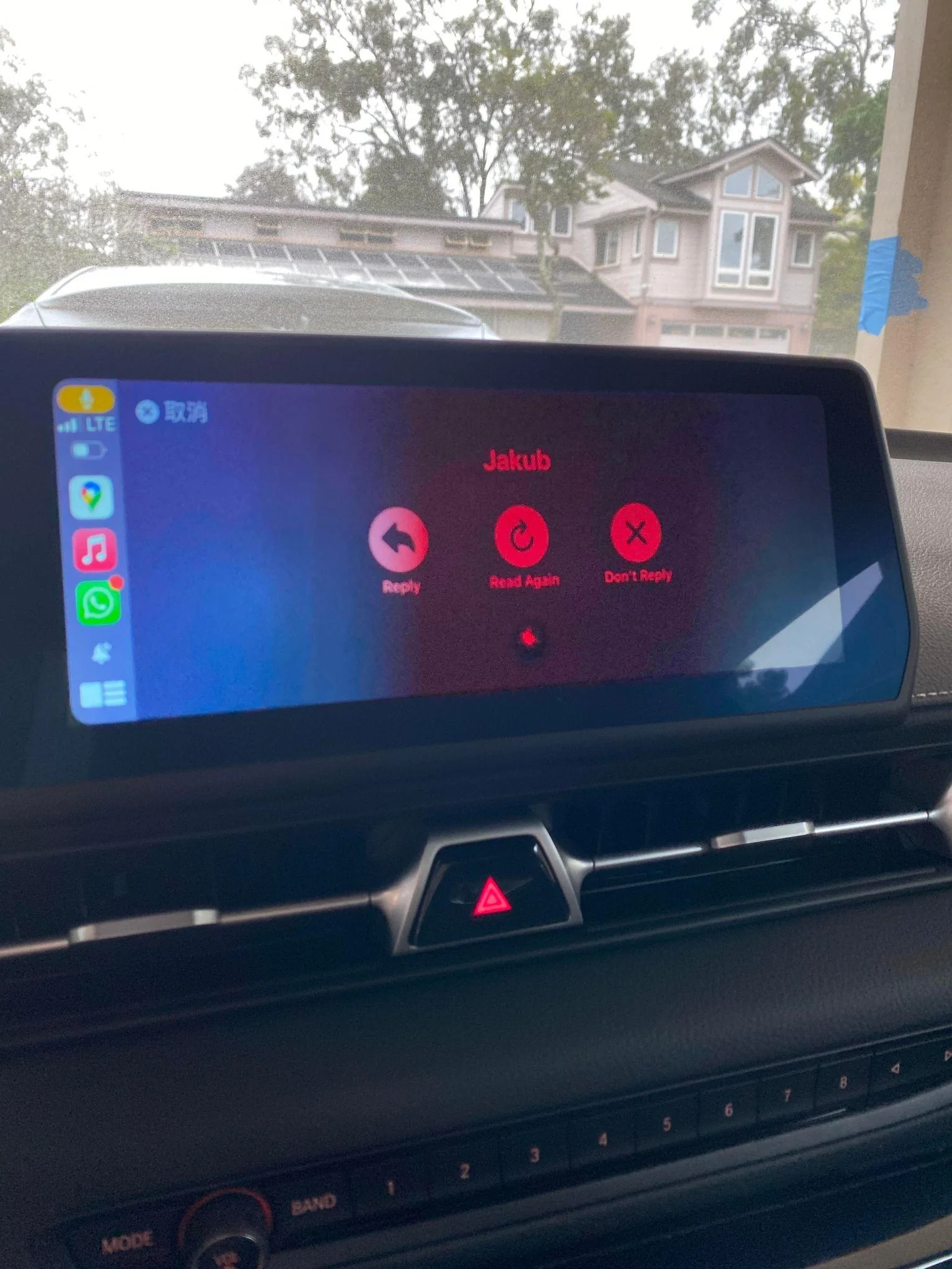

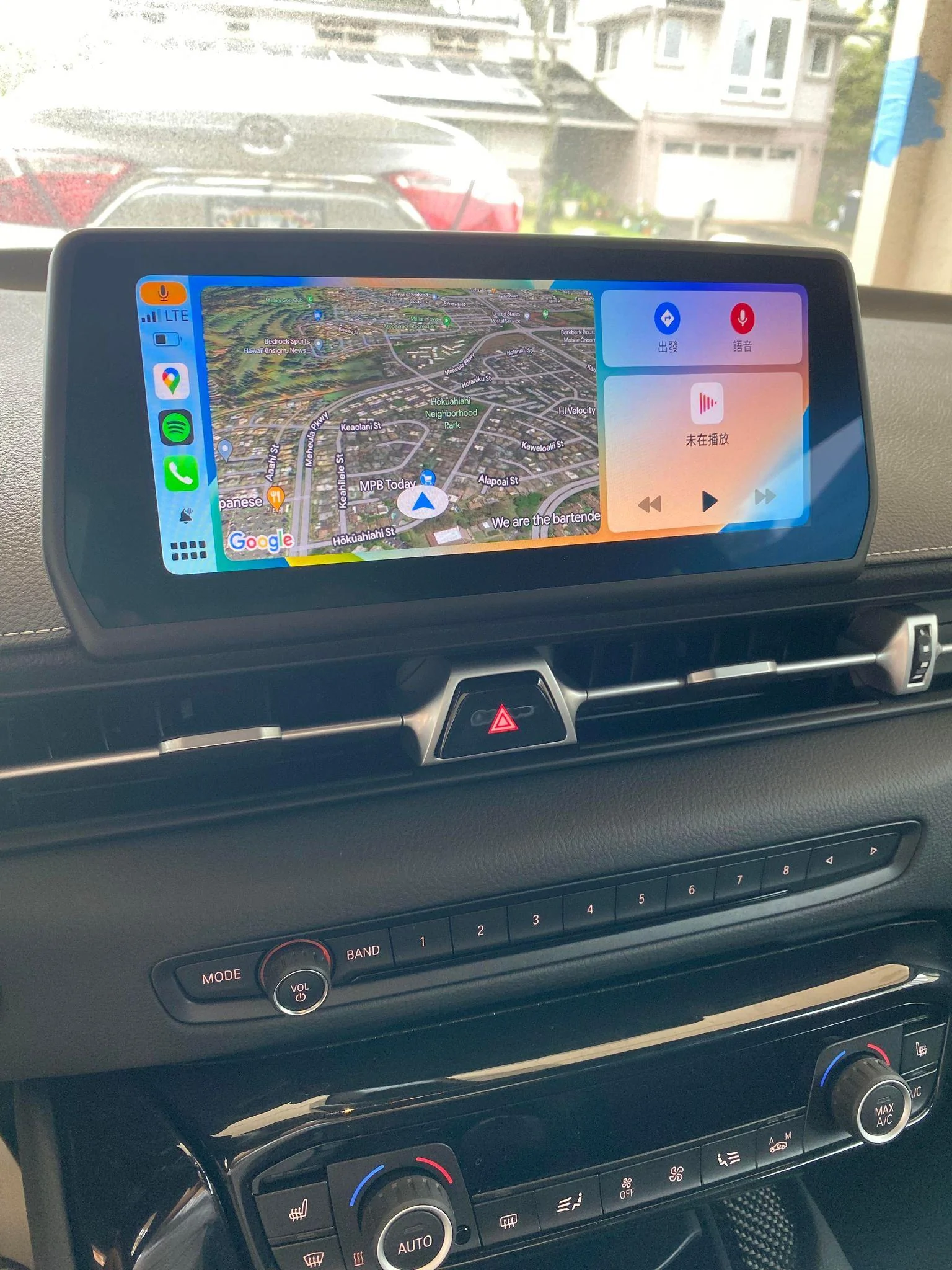

Happy Aloha Friday guys... I now have CarPlay!! The BMW guru Jakob took another stab at my car and he got it to work! The answer to my issue/problem was actually well-covered in the 3-series/X1/Z4 forums where owners were either missing the WLAN antenna or did not have the native activation of the "0143_NB_Tevo/EntryEVO Carplay" module certificate on "aktiv". Once you have the antenna plugged in the burgundy plug outlet, and the 0143 code is aktiv, then it worked seamlessly on my base model Supra. That crazy bitch Siri is now alive! LOL. Thank you to everyone who posted or replied and DM'd me about this. I am super happy w/my Supra now and I give all the glory and credit to Jakob and Bimmer_Remote -- 110% recommend them for this mod if you have a base model like me.
