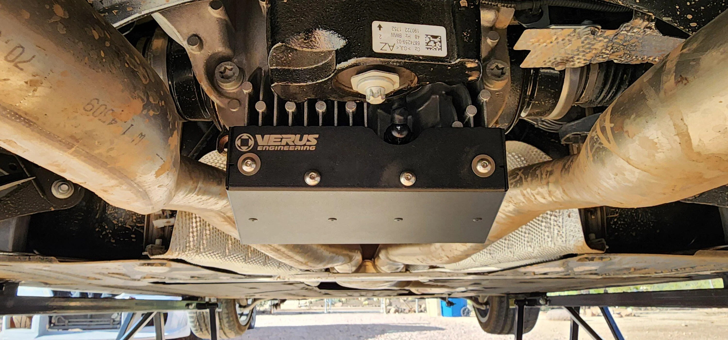

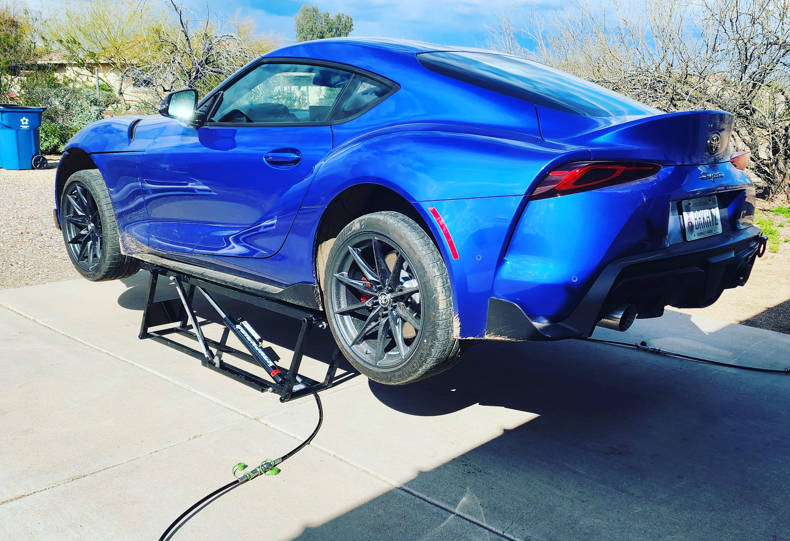

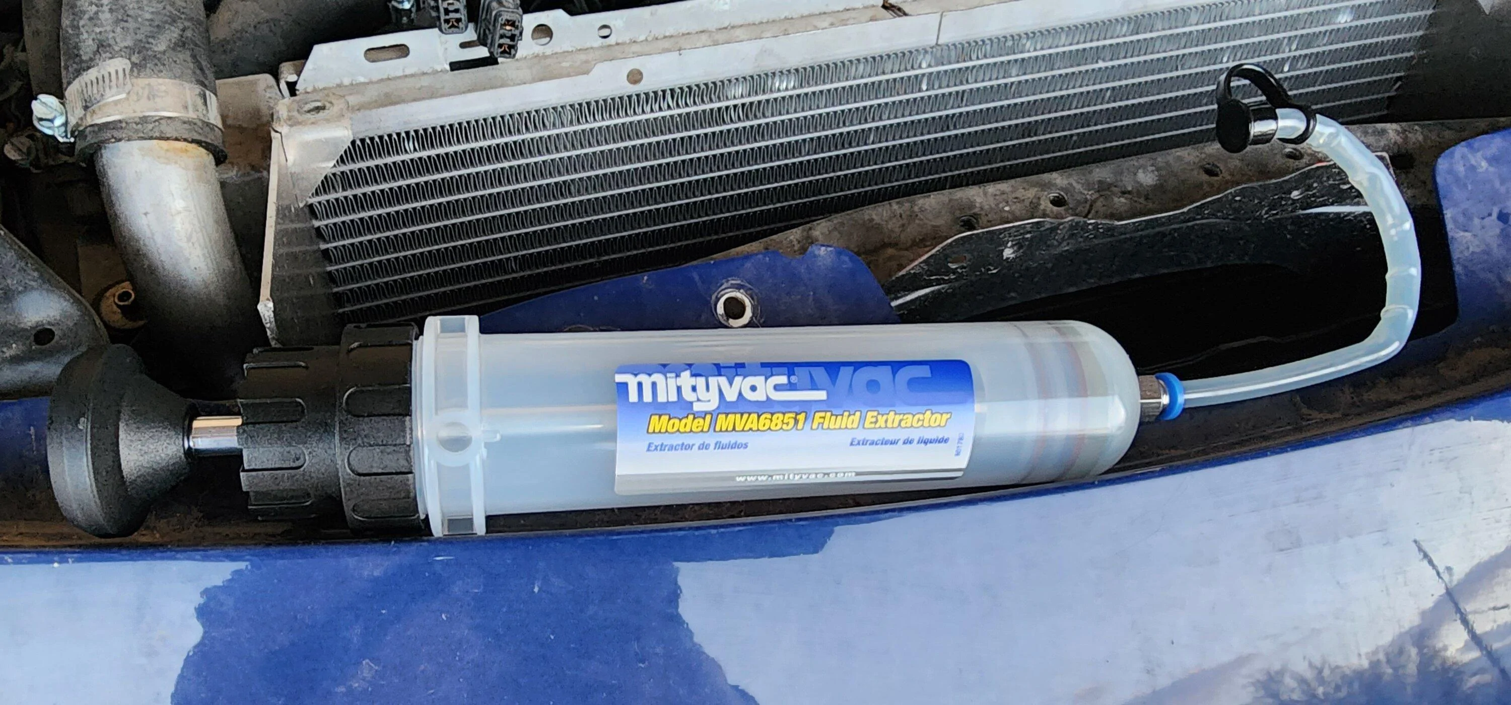

Installed Verus differential cooler after I changed the diff fluid. Had to heat up parts of the hose to get it to suck up the diff fluid. Did my cars 1st oil change. Did all this with a quick jack.
I have left to do tomorrow is brake fluid, steering rack stoppers, move the steering wheel over 1 tooth, add cotter pins to the harness, wash, install car numbers,

Well done 👍🏼 How often do you plan on changing your diff fluid?
I'm just treating the car like an M car. Oil and diff fluid 1st change at 1200 miles. The diff fluid came out pretty dark but the engine wasnt terrible however I did find a metal shaving. I'll post it up when I can.

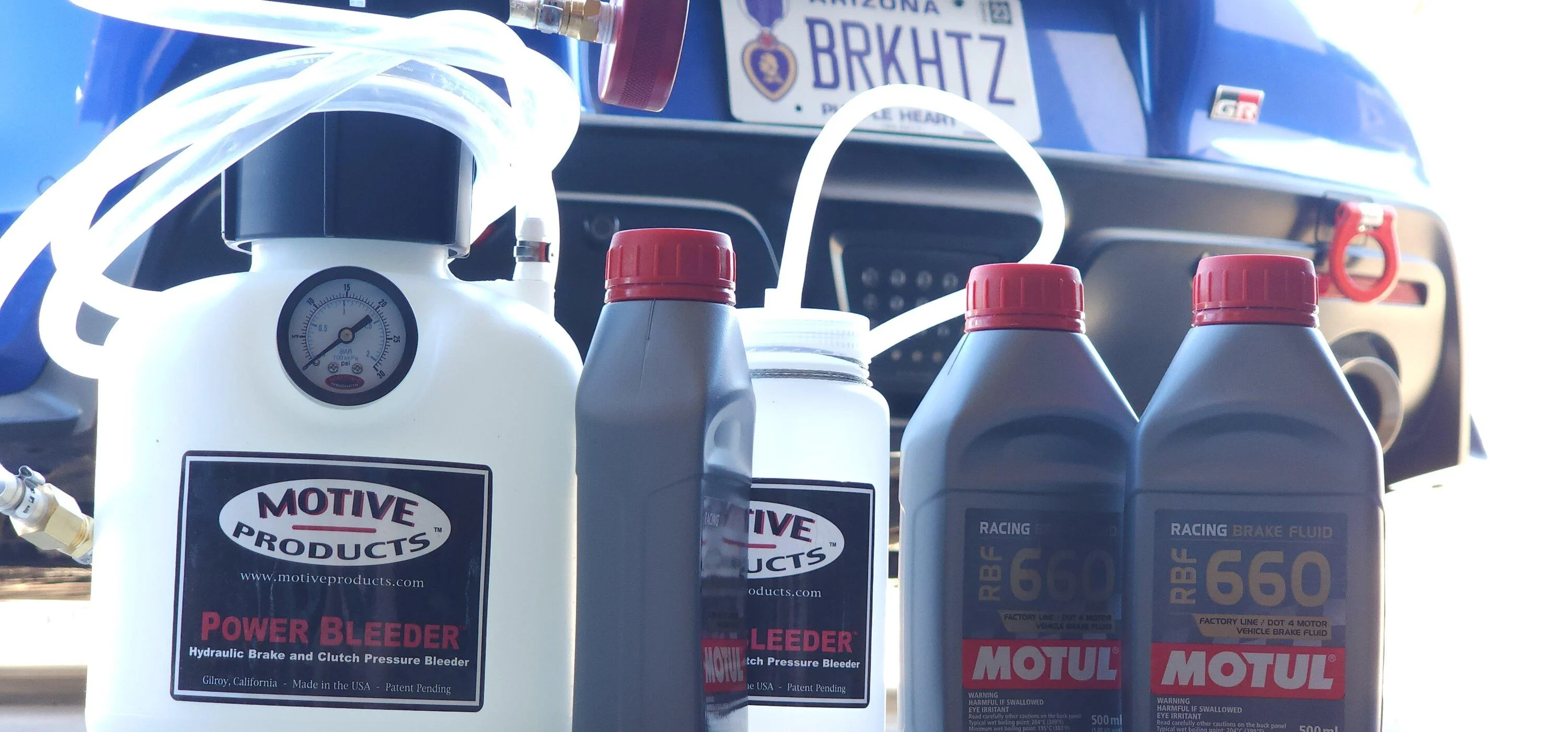

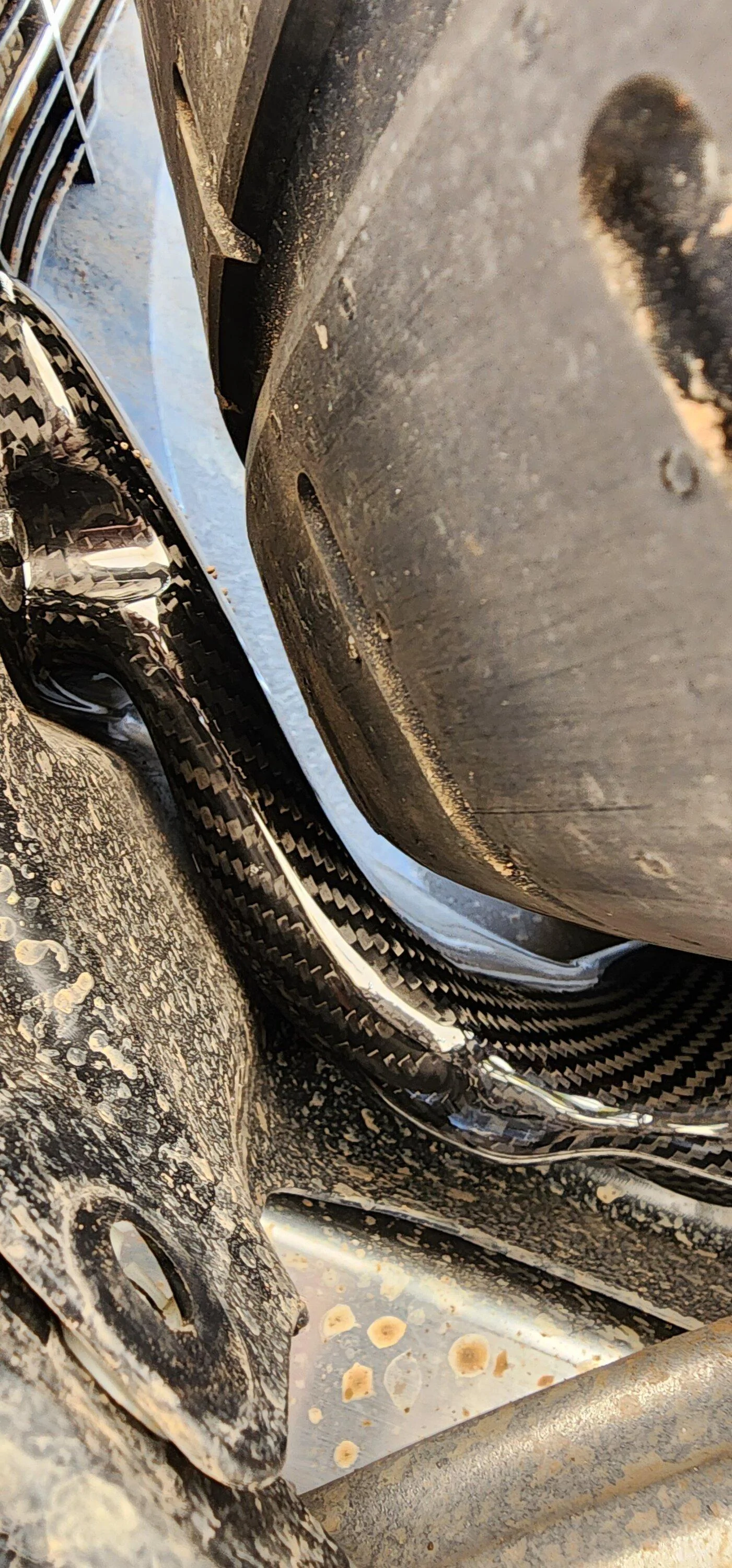

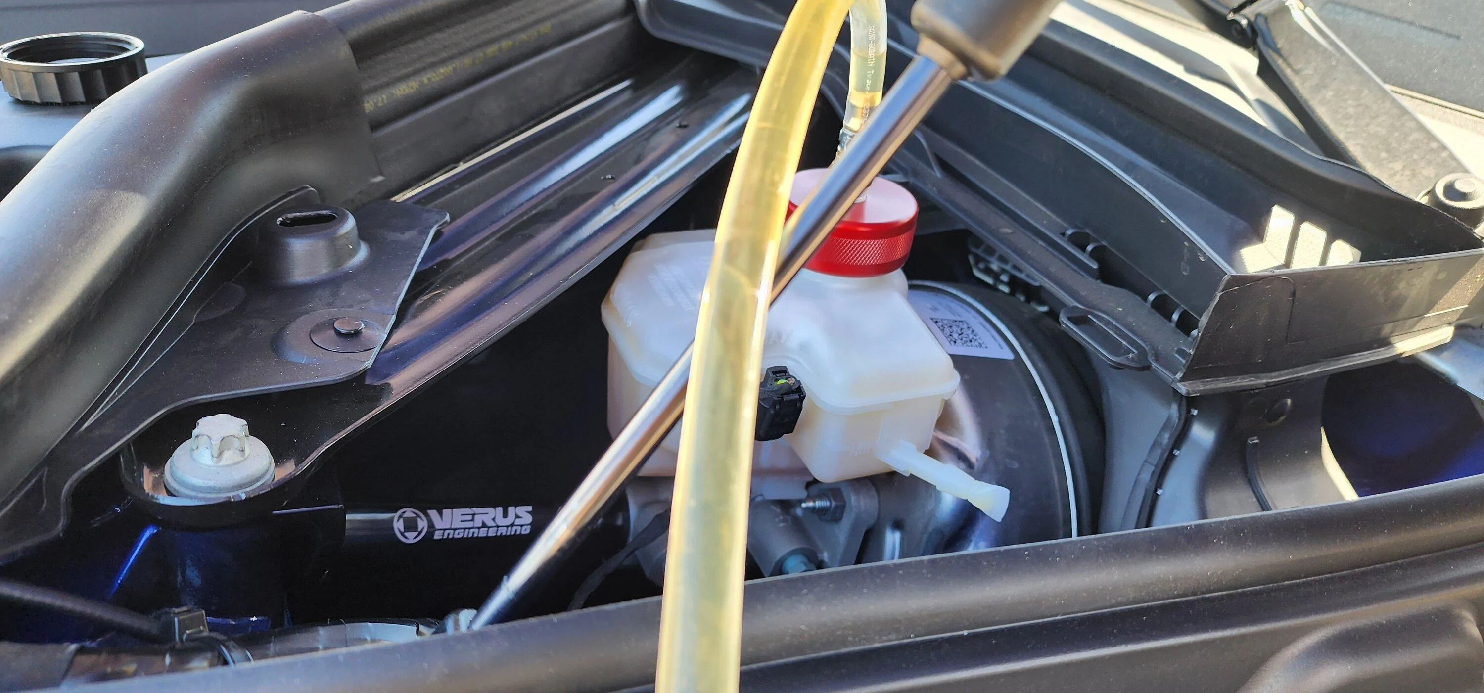

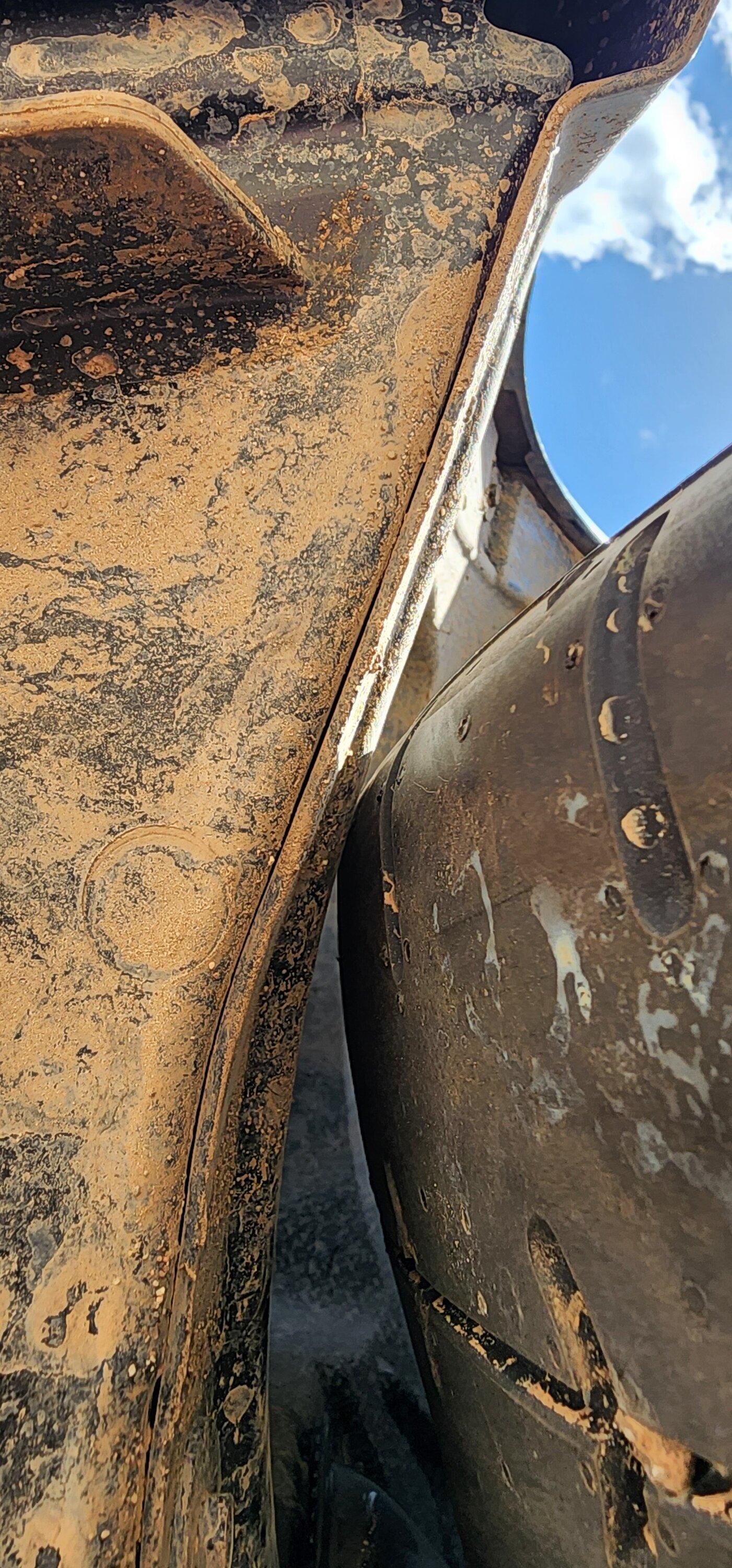

Brake fluids changed out. Put in 3 rack stoppers so the tires can clear the ducting from Verus. Still need to wash and place numbers.
